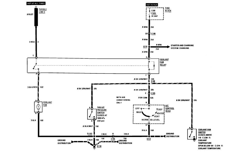

Cooling fan does not come on as should. With A/C on the fan comes on. If I ground at the thermal switch on engine block it still does not work. If I ground the green wire on the relay the fan runs fine. There looks like there is an ECM module in front of the fan relays. Does the thermal sensor run through this module? Any ideas?

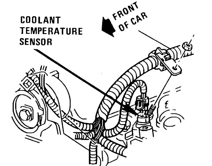

The coolant temperature sensor is the control for the fan. If you remove the connector while the key is on, it should send a signal of high temperature to the PCM and the fans should kick on.
Check that and see if it happens.

I disconnected the sensor and the fan did not come on. My car only has one fan. The sensor is located by the starter on the block is it not. The one by the manifold on driver side is just for the gauge I thought.

Do you have a voltmeter to do some checks?
Need to check voltage at the relay to be sure power is available for the fan to run.
May 12, 2018 at 10:51 AM
LRADENHEIMER
  • 8 POSTS
I did check the voltage and it is there on the relay. The only way I could get the fan on was to ground the green and white wire on the relay and the fan would come on.

What color are the wires on the coolant sensor?
May 12, 2018 at 1:54 PM
LRADENHEIMER
  • 8 POSTS
Black and yellow.
May 12, 2018 at 2:00 PM

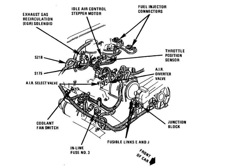

That is the issue. The switch you need is on the head.
I attached the location of the switch.
May 12, 2018 at 2:03 PM
LRADENHEIMER
  • 8 POSTS
I can see the wire. Why in the heck would they put it there. That will be tomorrow. I will have to get the car back up on jack stands to get to it. I cannot even get near it on top.

I installed the new fan switch and plug and the fan works like it should.
