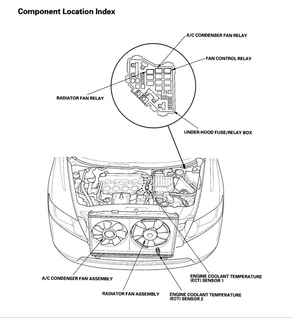

My car is overheating, the fan comes on only when i turn on the AC. i am trying to locate the the cooling fan switch.

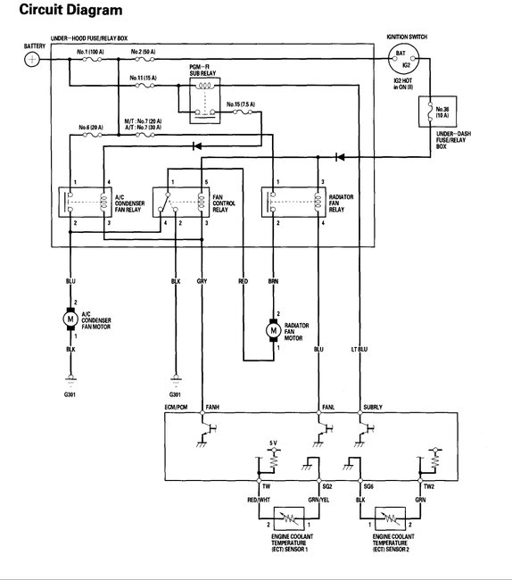

I see two engine coolant temperature sensors. Give me a moment to get their locations, but here is that wiring diagram.

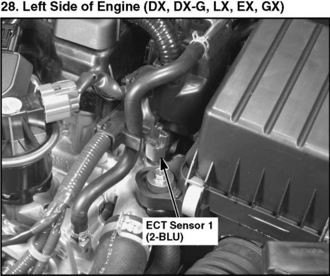

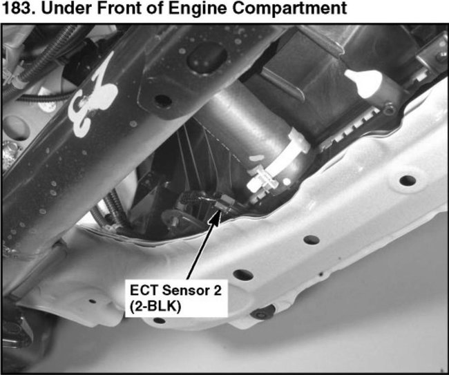

ECT 2 sensor is on the fan shroud and ect1 is on the engine a few inches from the end of the upper radiator hose. Here are some diagrams.
