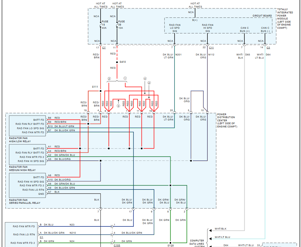

Cooling fans not coming on checked fans with external power and both fans work checked 40 Amp fuse and it was blown replaced with another fuse that is good and fans still won't come on

Id say scan it for codes first if you dont have a scan tool or access to one then check the fan relay if not there check the coolant temp sensor and wires plugs ect...good luck let us know what you find were glad to help

Id say the actual fan motor is bad. If you’re getting power to the fan but still not working, id say the actual fan motor is faulty

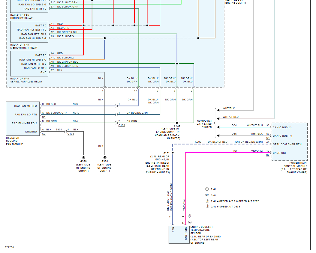

I would make sure you have a good ground, so check the blk wire at the cooling fan module, also these cars had a problem with the TIPM FYI, here is the wiring diagram to see how the system works and where to check for power and ground.
