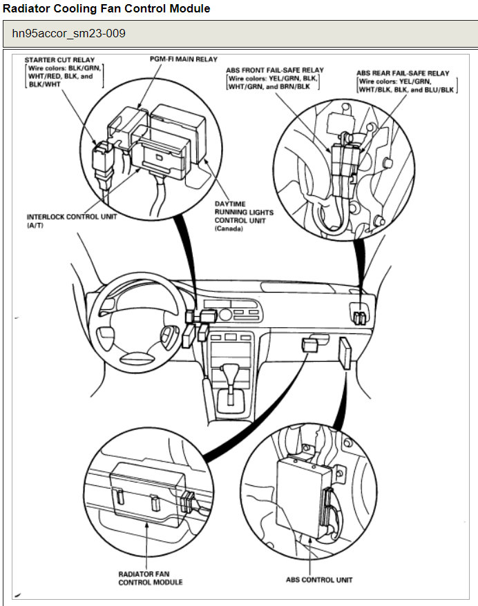

You have to replace the fan control module here is the locations (below). Check out the diagrams (below). Please let us know what happens.

Thank a lot Ken. If I disconnect the battery terminals for one day. And connect back again. The cooling fan turns on when I turn on the A/C. But when I turned off the A/C, and turn on again, cooling fan will not work again. A/C fan works perfect.
May 27, 2018 at 3:00 PM
  • 54,178 POSTS
Yes, this sounds like the fan control module. Have you replaced it yet?

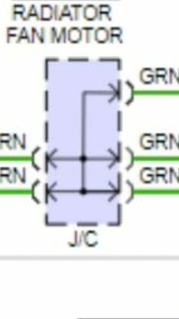

What part is this?
May 28, 2018 at 10:26 AM
KHLOW2008
  • 41,814 POSTS
The diagram shown is not a part by itself. It is a junction connector where wires are joined.

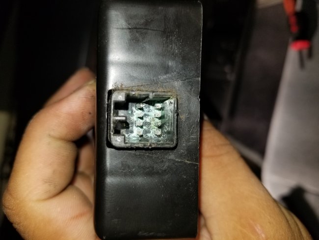

Fan control module, have to be the problem. That is corrosion, but why is the reason for that?
May 29, 2018 at 3:28 AM
BETA1219
  • 8 POSTS
Probably need to check the ECU connector?
May 29, 2018 at 3:34 AM
  • 54,178 POSTS
Yes, you found the problem, corrosion is normal after time and usage. Clean the connector contacts before installing the new part.

Hi ken, I cleaned the connectors, and everything is working perfect. Thanks a lot for the help.

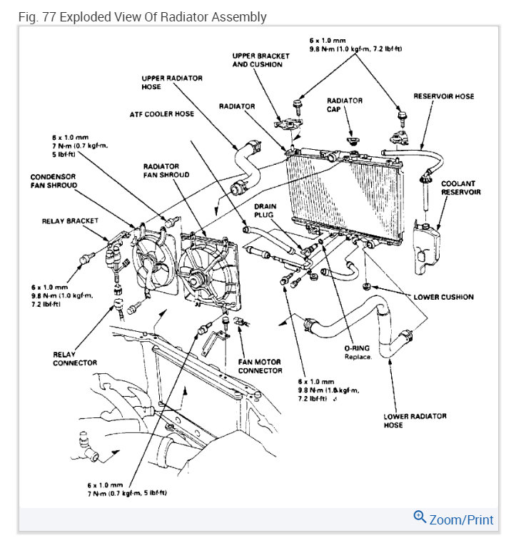

Did you replace the radiator cooling fan motor when you did the controller? If not then the fan motor is going bad pulling too many amps through the controller and you must clean the connector thoroughly or that will cause issues as well. Here is a guide to help you see what you are in for when replacing the fan and diagrams below for your car:
https://www.2carpros.com/articles/replace-electric-fan-motor
