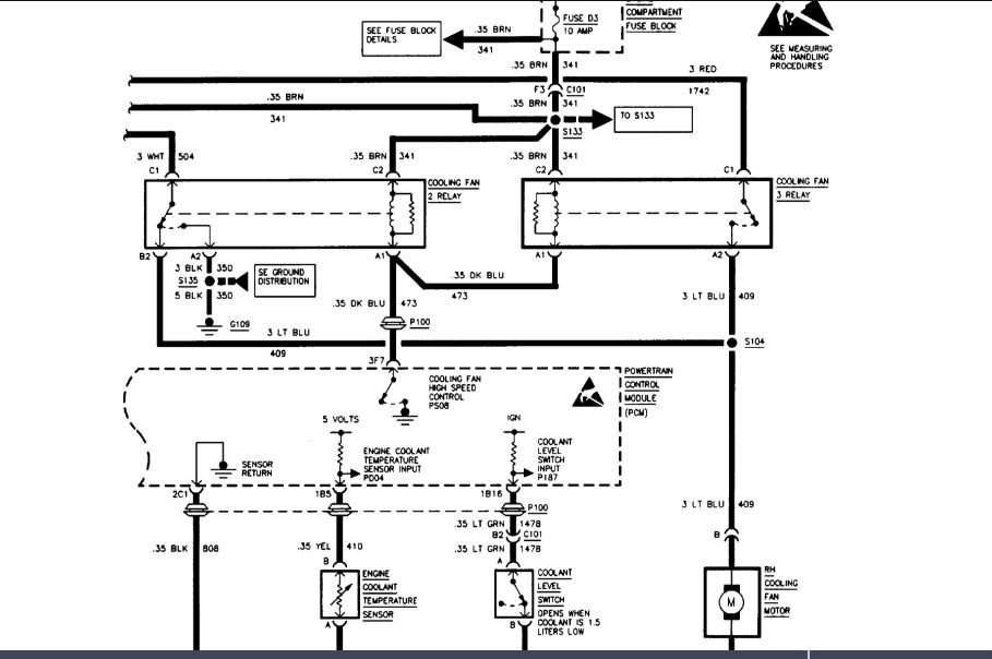

Left hand cooling fan has no high speed but right hand side does.

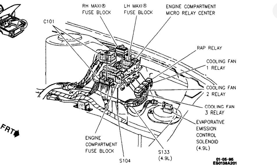

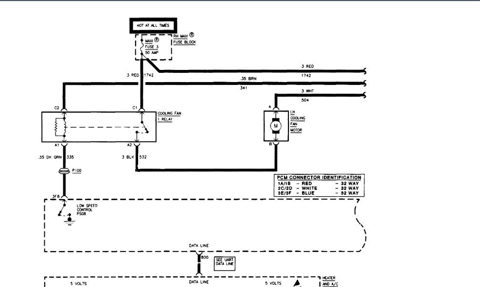

I attached the description and operation f the cooling fans below along with a diagram. Good chance one of the relays is not working correctly. I would inspect for any corrosion in the contacts.
The Power-train Control Module (PCM) controls both Cooling Fans by controlling three relays through two outputs. There are two modes of cooling fan operation: low speed and high speed. In the low speed mode, the cooling fans are powered in series. Cooling Fan 1 Relay is energized by the PCM and both cooling fans run at low speed. In the high speed mode the cooling fans are powered in parallel which allows the fans to run at high speed. Cooling fans operate only when the ignition is in RUN.

Low Speed Operation
Low speed cooling fan operation occurs when the PCM grounds the Cooling Fan 1 Relay coil on CKT 335. With only Cooling Fan 1 Relay energized, voltage is applied to both the LH and RH Cooling Fan Motors. The voltage path to the motors is through the Cooling Fan 1 Relay contacts, CKTs 532, 504 and 409, and the Cooling Fan 2 Relay contacts. The two motors are connected to each other through a series circuit. This causes the voltage applied by Maxi(R) Fuse 3 to be divided between the two motors. The division of the voltage causes the motors to operate at a lower speed. In the series mode the fans are grounded through CKT 250 and ground G107.

The cooling fans run at high speed when Cooling Fan 1, 2, and 3 Relays are grounded by the PCM on circuits 335 and 473. With cooling Fan 1 Relay energized, battery voltage is applied to the LH Cooling Fan Motor through the relay contacts. The LH Cooling Fan Motor runs at high speed because the fan motor is grounded directly through the contacts of the Cooling Fan 2 Relay, CKT 350 and ground G109.
Since Cooling Fan 3 Relay is also energized during high speed operation, battery voltage is applied directly to the RH Cooling Fan Motor through the closed contacts of the relay. The fan runs at high speed since it is no longer in series with the LH Cooling Fan Motor.
