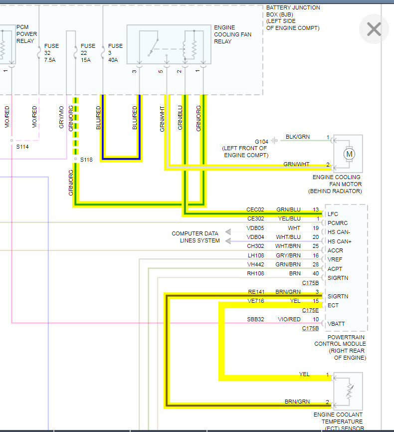

Okay, this is a little misleading. When you are unhooking the ECT sensor the PCM is going into default mode and it turns the fans on. Basically it is programmed to just turn them on if it looses the ECT because it doesn't want to risk the engine overheating. So unplugging the ECT and the fans turn on does not condemn the PCM.
However, it very well could be a PCM for other reasons. Let's circle back to the relay. When you jump 12 volts to PIN 5 of the relay, does the cooling fan come on? Take a look at the wiring diagram and let me know this and we can go from there.

Okay. So now we need to see if the relay is getting signal from the PCM to turn the fan on. So on pin 2 check to see if you have ground when the engine should be turning the fan on. So in other words, let the engine get hot and check to see if the PCM is grounding the relay. You do that but putting your red lead on battery positive and then the black lead on the relay terminal. Then when the PCM commands the fan on you should get 12 volts on the meter. This means the PCM is grounding the relay which closes it and it sends voltage to the fan to turn it on.

Okay, so i have checked pin 2 with the black lead and the red on the battery's positive and the meter was reading 0. I have check the other ones the same and the only one who had 13 volts was pin 5.the temperature was 83 C i couldn't get it higher today. i will try tomorrow again to see if i can get the temperature higher than that.Thank you

Okay. If you have 0 volts on pin 2 then the PCM Is not grounding the relay to turn the fan on. Due to you already replacing the ECT sensor I would go ahead and replace the PCM because either something is telling the PCM to not turn the fan on or the PCM is just not able to turn the fan on. I would go with the PCM.

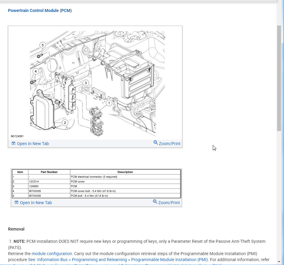

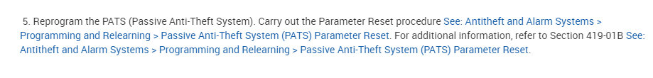

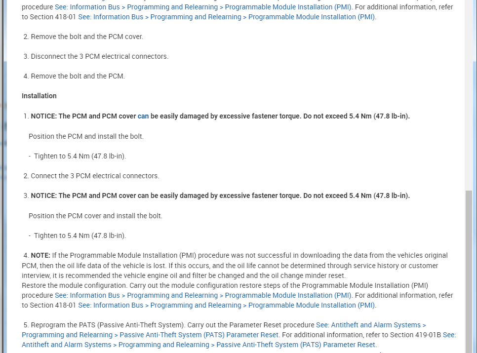

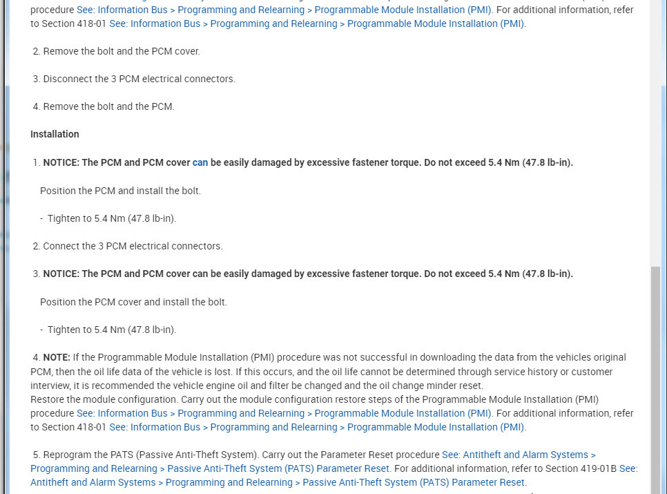

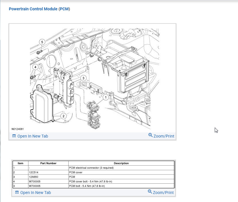

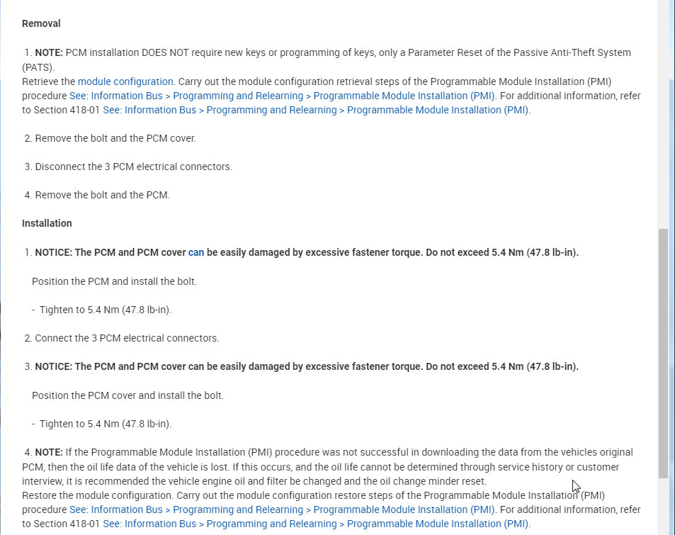

Unfortunately you cannot swap this PCM. Once you do you will not be able to turn anything on as the security system will lock it out. When you put a PCM in newer vehicles like this you need to program it to this vehicle and the security system. A used PCM is going to have a different vehicle already in it and you will not be able to turn the ignition on and get the system to come on.
I attached the process for replacing it and you will see this info on step 5 of the installation.
