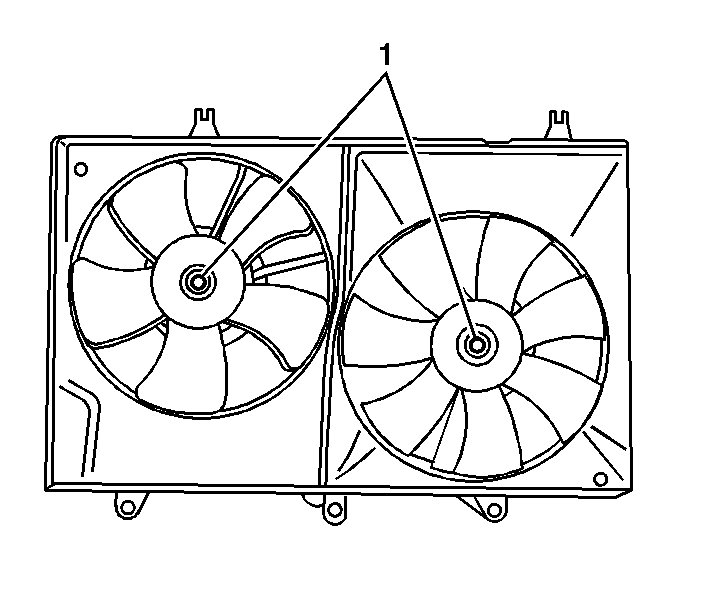

One of my cooling fans come on and the other one won't even when you turn on the A/C. I took the whole assembly out and jumped the one that wasn't working. nothing until I applied a little pressure with my finger to the middle of the fan (slightly to one side), then it started spinning good until I let my finger off. I took the blade off and jumped it again and the shaft was spinning good with no assistance.. put the fan blade back on the same thing as before.. will only spin if slight pressure is applied a tiny bit off the center of fan.

If the blade isn't toughing anything to prevent it from turning, chances are the motor, although it runs without the blade, doesn't have the power to turn the fan blade, In this case, I would replace the fan motor.
Here are the directions for replacing the motor. The attached pictures correlate with the directions,

1. Remove the cooling fan assembly.
pic 1

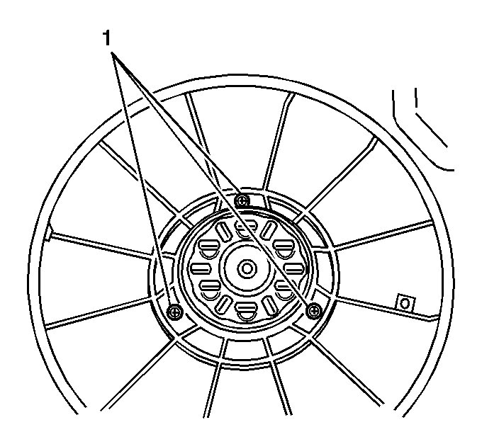

2. Remove the fan blade retaining nut (1) from the motor.
pic 2

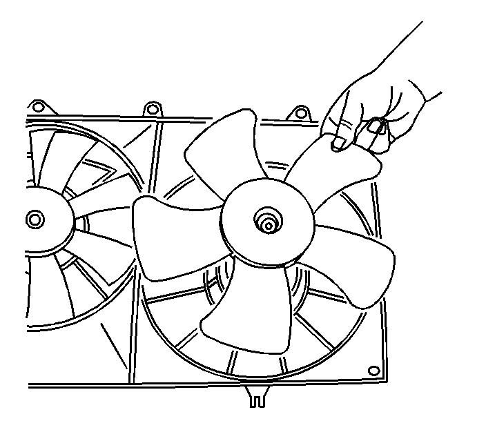

3. Remove the fan blade from the motor shaft.
pic 3

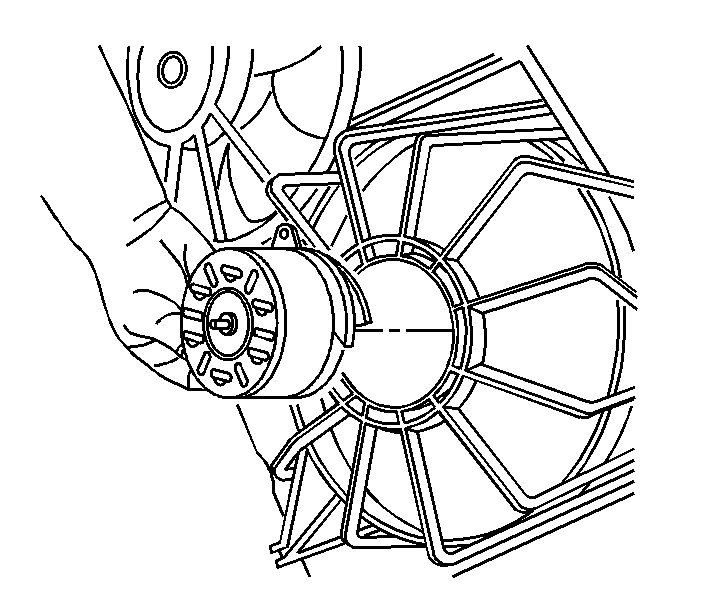

4. Remove the motor retaining screws (1).
pic 4
5. Remove the motor from the shroud.

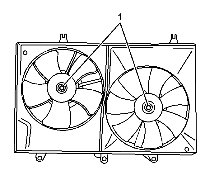

Installation Procedure
pic 5
1. Install the motor to the shroud.
