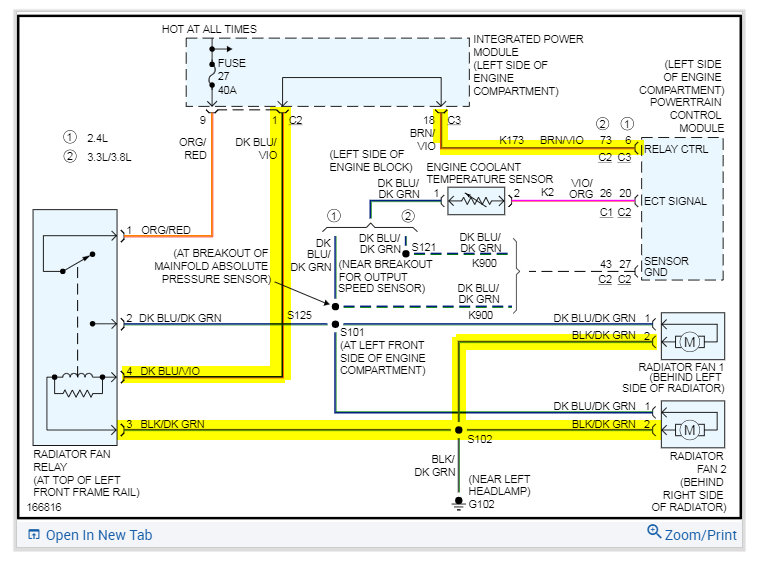

Just so I understand, both fans come on when you have the A/C on but if the A/C is off, the second fan never comes on?
When you say the engine stops at 220, do you mean that it shuts off at 220 or the scan tool temperature doesn't show a temperature above 220?
This does sound like a PCM or a IPM, but I want to make sure of the questions above.
Also, if you want to bypass the PCM then you need to tap into the control circuit that I highlighted in this diagram. Basically, the PCM applies power on the control circuit to tell the fans to come on. If you wire a switch from 12 volts to the dark blue/violet wire which is before the relay, then you should be able to apply the voltage here and the fans come on. However, I have never done this so I am not sure what effects this may have on the PCM. I would definitely put a fuse between the switch and 12 volt source just to make sure you don't have issues with too much current.
Let me know if you have questions.

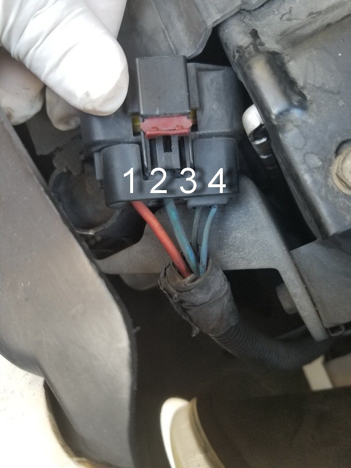

1. AC off FAN off.
2. 220°F come from scan tool.
I saw 4 wires connect to Fan relay as attached picture
I wish to make manual switch for turn on/off radiator fans during driving car.
Where am i connect manual switch each other.
Can i use cable splicer or cut cable?
Thanks.
Sep 1, 2019 at 2:50 AM
Looks like the control wire is the dark blue and violet and the black and dark green wire is the power wire for the fans. It is hard to tell which of those is these wires. So what I would suggest is taking a jumper wire with 12 volts on it and back probe each of the wires and see what makes the fan come on. This is the one that you will want to hook your switch too. Again, make sure you are using a fuse so you don't burn up your fans on accident.
