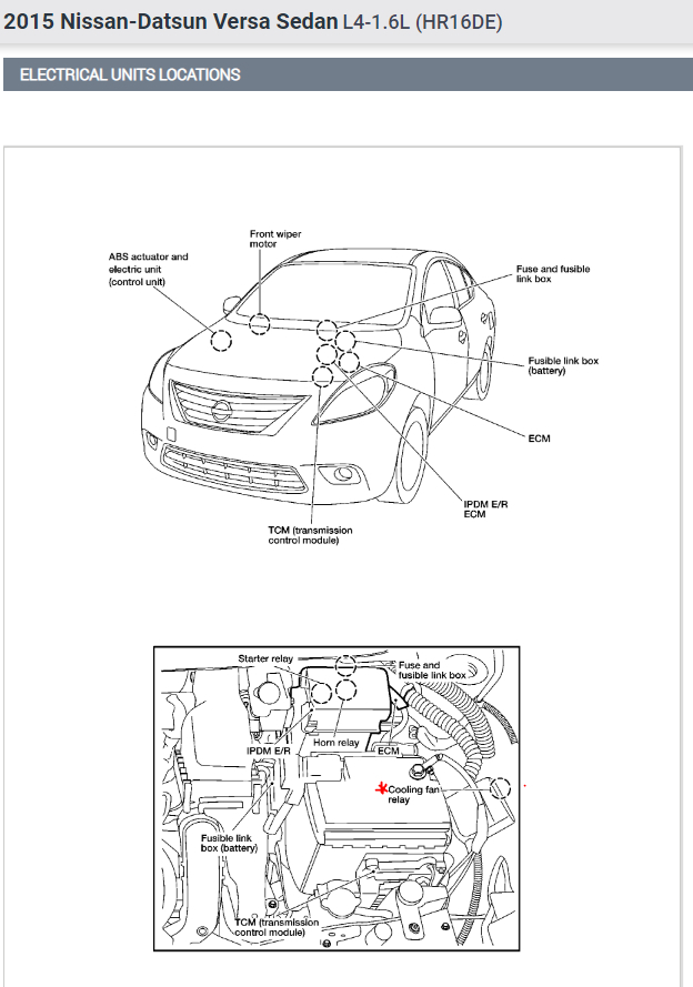

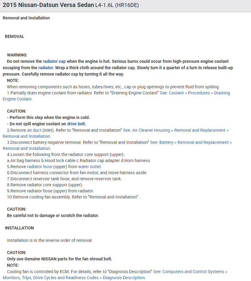

Cooling fan does not turn on at any time.
Aug 17, 2021 at 4:43 AM
SQM
  • 6,383 POSTS
There are few reasons for an inoperative cooling fan.
The most common reasons are a bad cooling fan relay, or a faulty cooling fan motor. It can also not work if there is a wiring issue.
The cooling fan relay is located under the hood right next to the battery (see diagram below). Check the relay first. Do a visual inspection of any type of corrosion on the plug or any burnt pin(s). You an also test the relay function.
Here is a guide on how to do that:

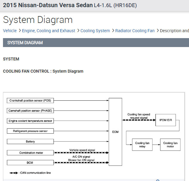

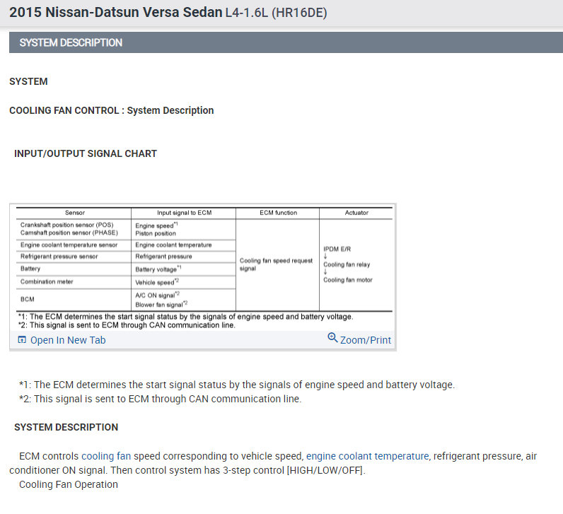

Also the cooling fan gets triggered by the coolant temperature sensor. If the sensor is not providing the correct signal to the ECM the fan will not turn on.
https://www.2carpros.com/articles/how-a-coolant-temperature-sensor-works
https://www.2carpros.com/articles/symptoms-of-a-bad-coolant-temperature-sensor
First item you should check is the relay. Also see if you are getting power to the fan.

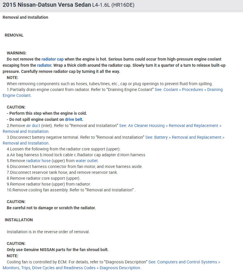

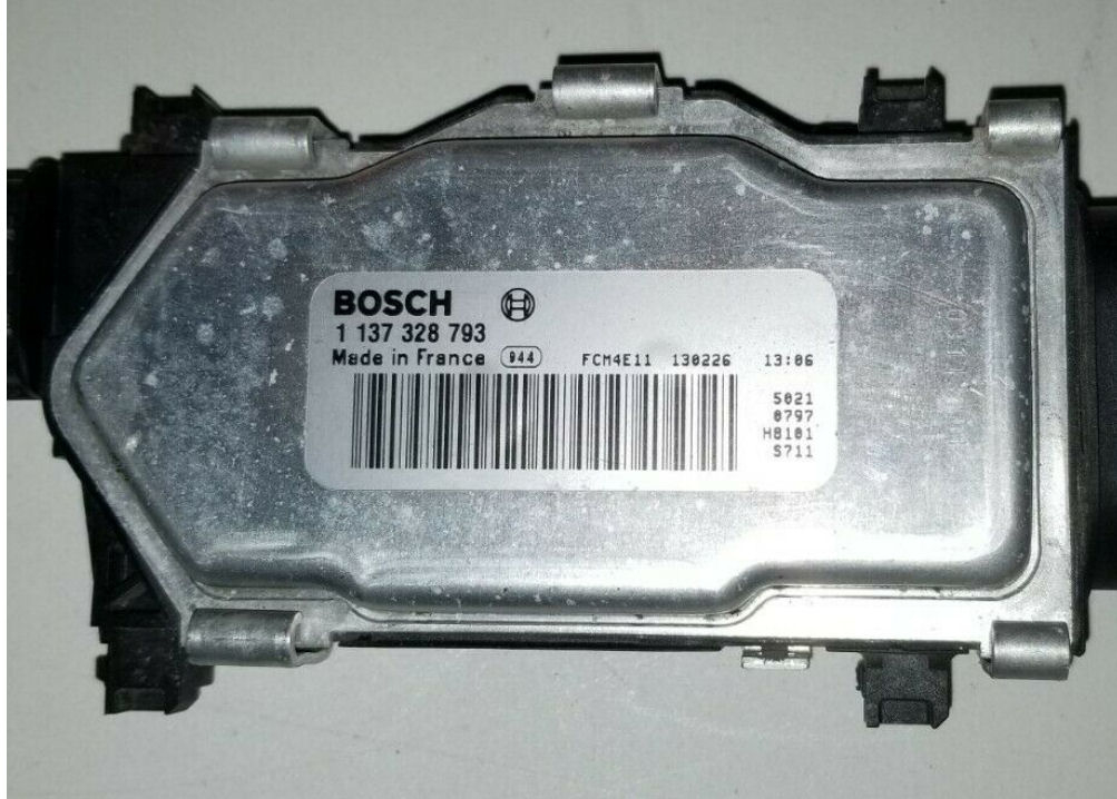

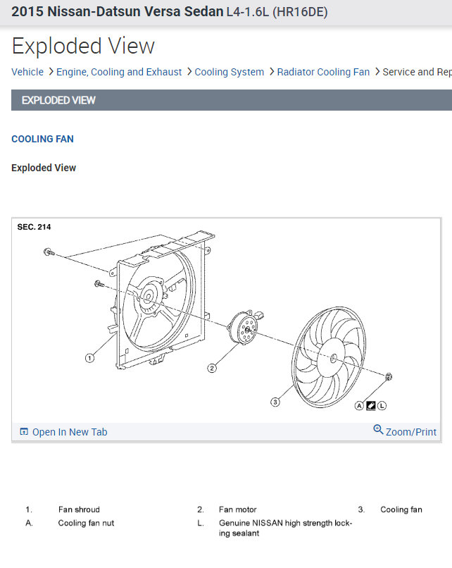

Very extensive information but it is for a different car. My research resulted in a controller module instead of a relay. I have not been able to find the actual location in the car. I checked fuses and they seem to okay. I was not able to find a relay on a visual inspection nor in an internet search. The best I could find was the module that is use in other car makes but is also shown as exact fit for the Nissan Versa vs 2015.
