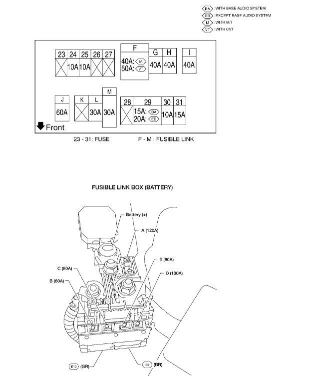

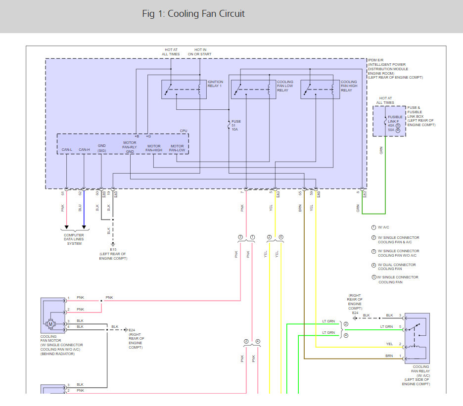

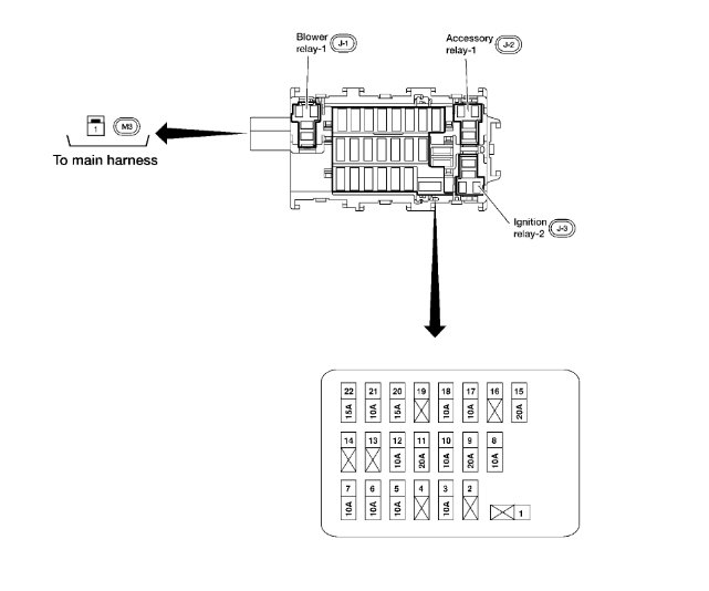

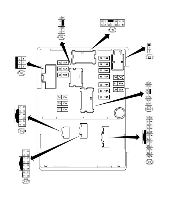

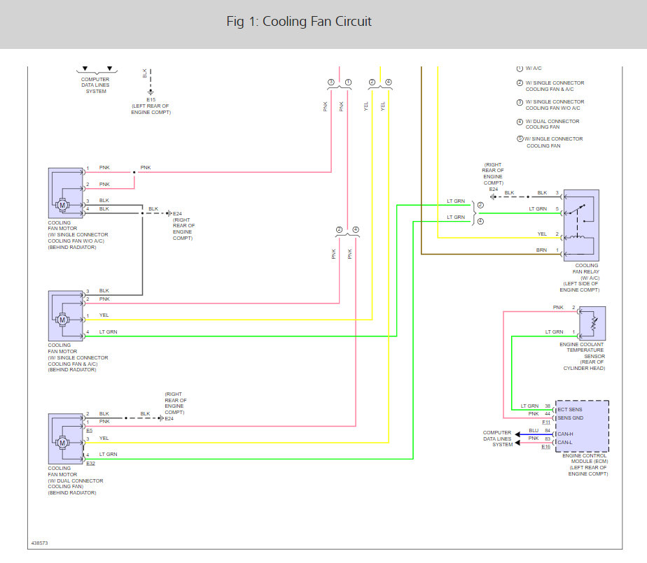

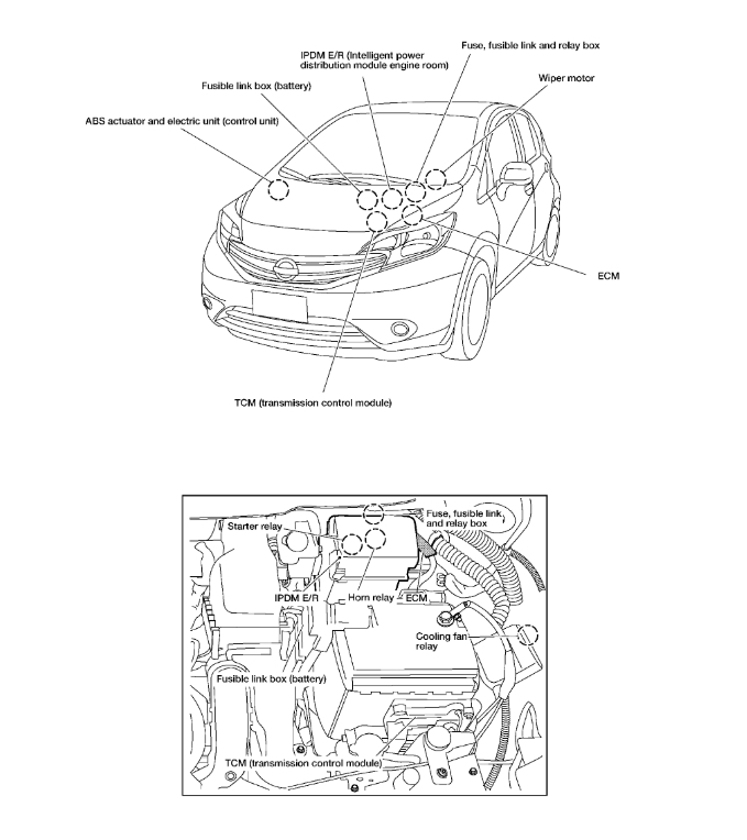

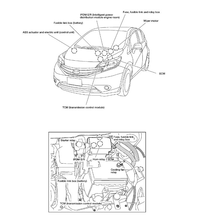

The cooling fan doesn't come on. how do i check the relays and where are they?
May 13, 2019 at 5:12 PM
  • 55,740 POSTS
The cooling fan relay is under the hood. here is a guide to help you check the relay and the relay and fuse locations in the diagrams below which have the cooling fan wiring so you can see how the system works:
