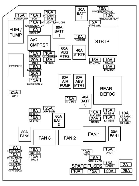

I have two fans neither are working. My car overheating and gave me message stating it is idle overheating which it never did. A mechanic tested every single fuse under hood they all made a noise which they are working. Then he test wires on fan and he said it is grounded whatever that means. The fan made a fire spark when he tested the fans. We also took it to parts store to have codes reads a since my engine light comes on time to time and it said" mask air flow and cooling fan relay(2) codes for fan". So basically he said I needed cooling fan assembly. Please advise with your input.
Jan 9, 2018 at 8:49 PM
PATENTED_REPAIR_PRO
  • 1,853 POSTS

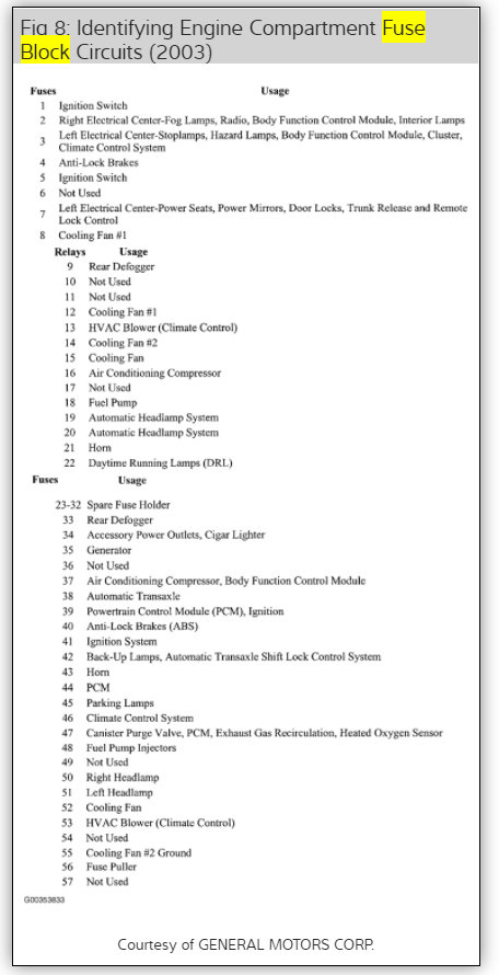

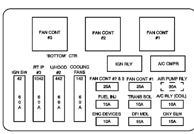

Try a new "fan 2 relay" first located in the underhood fuse block.
That should be the fan relay in the middle of those three fan relays shown at the bottom of this diagram of that under-hood fuse block.

Hello there. Ok so fans were installed but now AC fan come on out off come on shut off and the Engine fan will not come on at all. Previously before I had fan install the code that we're pulled from under the dash from the fuse box read Cooling Fan 1. He switched relays around to see what happens but still nothing happened. He touched it every time AC fan come on and off to see if it's doing a click noise which it is.
Jan 12, 2018 at 5:44 AM
PATENTED_REPAIR_PRO
  • 1,853 POSTS
All I can say is if you had a code before for cooling fan 2, then swap relays around, now have a code for cooling fan 1, I would suggest you at least buy 1 new relay and install it and install it in the relay spot that you now get a code for or if you haven't touched anything since last reading them codes, put the new relay in the fan relay 1 spot.
Jan 12, 2018 at 6:57 AM
QUILA
It the same code as before so I'm assuming it's the relay and will replace. Thanks

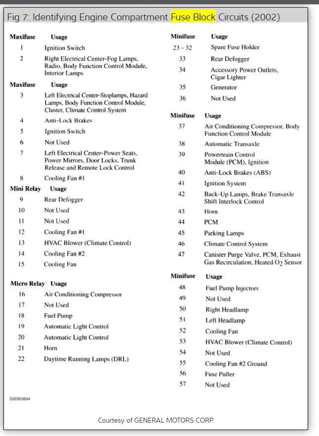

you have fuses and relays in underhood box along with diodes. make sure fan grounds are good. relays are triggered by ECM which gets input form temp sensor/AC controls.

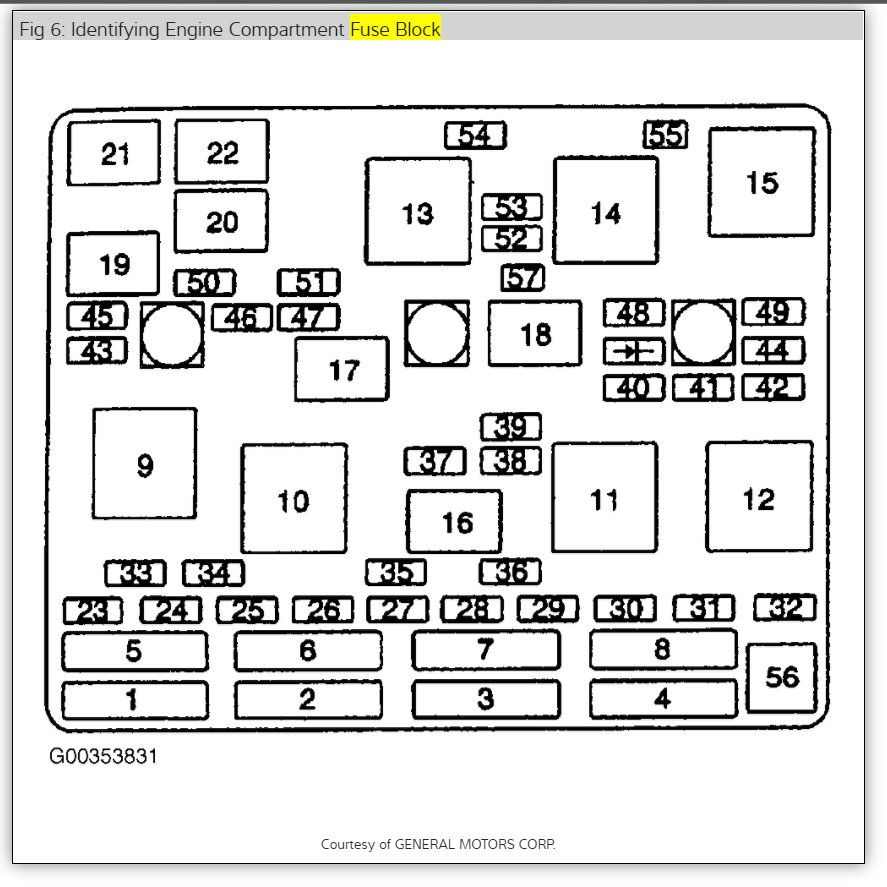

Hello, I'm Danny.

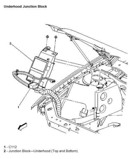

It sounds like you might be having trouble with the cooling fan relays. They are located in the under hood junction box. The junction box is located under hood on the right side of compartment near the strut tower. Here is a tutorial showing how to test a relay:
I've attached 2 pictures below showing the location of the junction box and the relays for your car. Hope this helps and thanks for using 2CarPros.

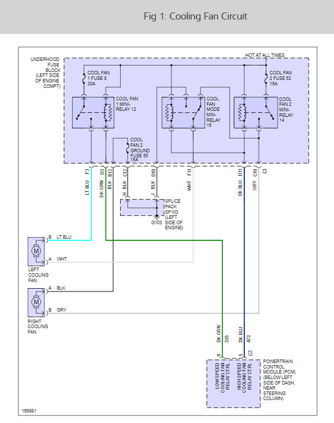

There are two fuses and three relays that run the system here are two guides and the cooling fan wiring diagrams (Below) along with the fuse and relay locations.
First check fuses. If OK check fan control relays ( 3 of them, all on bottom side of underhood electrical center). If OK as well then engine coolant temp. Sensor is probably faulty.

Is there an overheating problem, and the fans were discovered to be non-functional? The fan relays are controlled by the body control module, and the power-train control module. The fact that they come on, is due to default when the PCM sets a code. There are other situations that would command fans(one or both), and that would be A/C compressor engagement, and/or refrigerant temperature/pressure sensors. Is the vehicle getting hot enough for fans to come on? Does one or both come on, when A/C is engaged? There are two strategies depending on engine size however, they are somewhat similar. Here is the description.
Cooling System Description and Operation:
Cooling Fan Control 3.4L (LA1)
The engine cooling fans are controlled by the body control module (BCM) and the power-train control module (PCM). The BCM sends a Class two message to the PCM requesting cooling fan operation. If there is a Class two communication malfunction between the BCM and the PCM. The PCM will operate the engine cooling fans independently of the BCM.
The engine cooling fan system consists of two electrical cooling fans and three fan relays. The relays are arranged in a series/parallel configuration that allows the PCM to operate both fans together at low or high speeds. The cooling fans and fan relays receive battery positive voltage from the engine wiring harness junction block. The ground path is provided at G101.
During low speed operation, the PCM supplies the ground path for the low speed fan relay through the low speed cooling fan relay control circuit.This energizes the cooling fan one relay coil, closes the relay contacts, and supplies battery positive voltage from the FAN CONT #1 fuse through the cooling fan motor supply voltage circuit to the right cooling fan. The ground path for the right cooling fan is through the cooling fan two relay and the left cooling fan. The result is a series circuit with both fans running at low speed.
During high speed operation the PCM supplies the ground path for the cooling fan one relay through the low speed cooling fan relay control circuit. After a three second delay, the PCM supplies a ground path for the cooling fan two relay and the cooling fan three relay through the high speed cooling fan relay control circuit. This energizes the cooling fan two relay coil, closes the relay contacts, and provides a ground path for the right cooling fan. At the same time the cooling fan three relay coil is energized closing the relay contacts and provides battery positive voltage from the FAN CONT #2 fuse on the cooling fan motor supply voltage circuit to the left cooling fan. During high speed fan operation, both engine cooling fans have there own ground path. The result is a parallel circuit with both fans running at high speed.

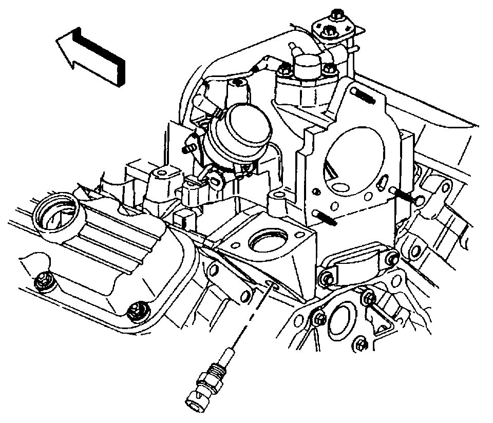

Cooling fans are not working I have replaced them replace the sensor and check my lines and relays all seemed fine but fan not working so I went to replace the fan and before installing check the fans and both fans work once I connect them to the sensor did not come on disconnected the sensor only one fan work on default I'm also getting two codes P0449 and p0118 I don't think those codes point to the problem though but I will also fix those just need help diagnosing the problem my car is overheating badly
Dec 7, 2020 at 8:35 AM (Merged)
  • 110,194 POSTS
Welcome to 2CarPros.
The 449 is an emissions related code, so I don't think that is the issue. However, the 119 is related to the engine coolant temperature sensor. Have you replaced it?
Take a look through these links:
https://www.2carpros.com/articles/how-a-coolant-temperature-sensor-works
https://www.2carpros.com/articles/symptoms-of-a-bad-coolant-temperature-sensor
https://www.2carpros.com/articles/coolant-temperature-sensor-cts-replacement
Here are the directions for replacement specific to your vehicle. The attached pic correlates with the directions.
__________________________________
2000 Chevrolet Impala V6-3.8L VIN K
ENGINE COOLANT TEMPERATURE (ECT) SENSOR REPLACEMENT
pic 1
REMOVAL PROCEDURE
IMPORTANT: Care must be taken when handling the engine coolant temperature sensor. Damage to the engine coolant temperature sensor will affect proper operation of the fuel injection system.
1. Turn OFF the ignition.
2. Drain the radiator coolant. Refer to Draining and Filling Cooling System in Cooling System.
3. Remove the exhaust crossover pipe.
4. Disconnect the ECT sensor electrical connector.
5. Remove the ECT sensor.
INSTALLATION PROCEDURE
NOTE: Refer to Fastener Notice in Service Precautions.
IMPORTANT: Care must be taken when handling engine coolant temperature sensor. Damage to the engine coolant temperature sensor will affect proper operation of the fuel injection system.
1. Hand start the ECT sensor into the engine.
Tighten
Tighten the ECT sensor to 30 N.m (22 lb ft).
2. Connect the ECT sensor electrical connector.
3. install the exhaust crossover pipe.
4. Refill the radiator with coolant. Refer to Draining and Filling Cooling System in Cooling System.
5. Start the engine and check for leaks.
6. Inspect the coolant level.
__________________________________________
Since the fan turns on when the sensor is disconnected, it doesn't sound like a computer issue. If you haven't already replaced the sensor, that is what I would recommend trying. It may not be telling the computer the engine is warm.
