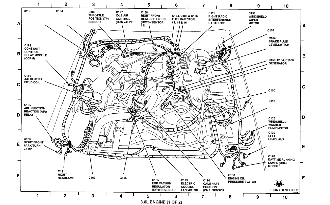

You guys helped me get my A/C operating with nice cold air. However, my cooling fan isn't coming on. Went through dx process found on my. streetonline by John Huff. Points to CCRM. Tested ect, okay. jumped fan, okay. re-seated and cleaned ground straps. voltage to CCRM, okay. no voltage at fan, no voltage from CCRM to fan (back-probed wire harness). CCRM is re-manufactured and original pn label is missing. re-manufactured label on is 3-70029 and calibration code is 08130S. Can I use the VIN to order the correct pn number? Thanks.

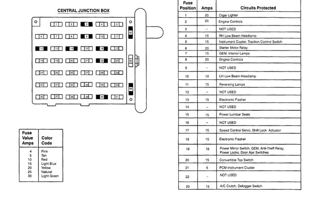

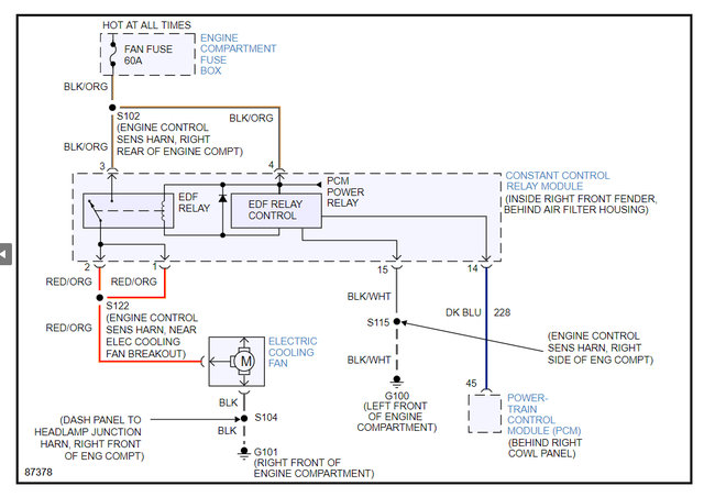

  • 55,333 POSTS

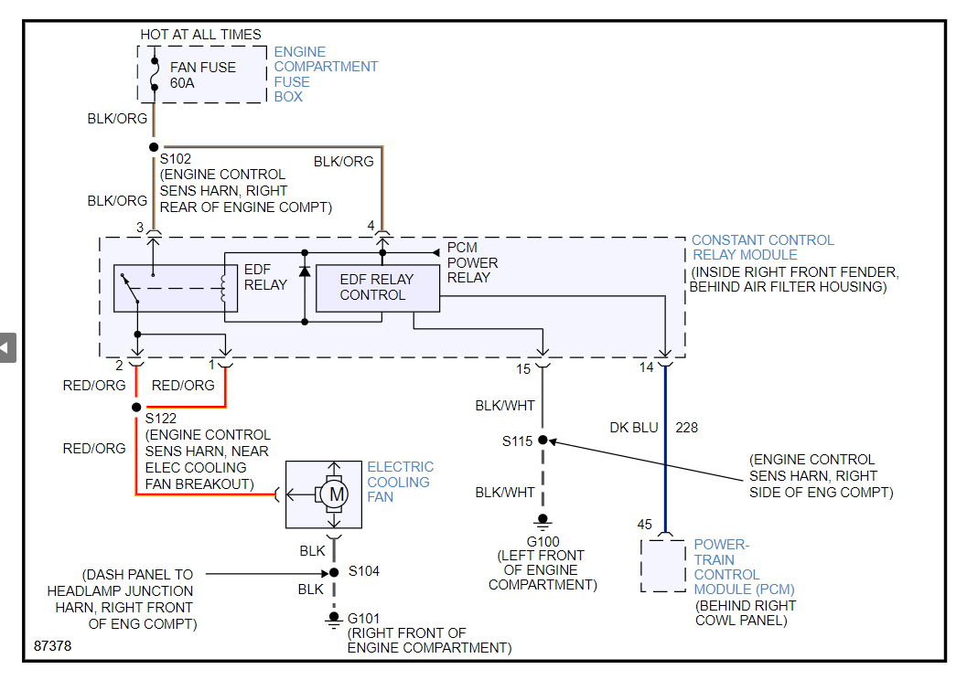

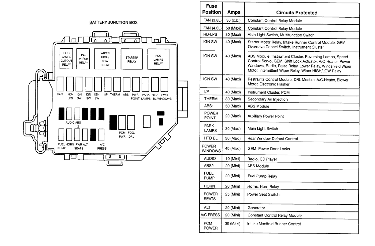

Here is the wiring diagrams for the cooling fan so you can see how the system works and the fuse locations as well with a guide to help you test the fuse. Check for power at fan fuse #60 also check the ground at the black/white wire.

Thanks for the info. The diagram of the battery junction box is not like mine. However my fan 60 amp fuse is good with voltage on both sides. Checked voltages into CCRM and they're good. No voltage out to fan. One side of high pressure switch (blue/yellow) has voltage with A/C on. Do you have to evacuate the system to remove and test the high pressure switch? Also, high side pressure climbed to around 430 before compressor turned off. All else points to CCRM according to dx procedures done previously. any suggestions?
Aug 6, 2020 at 3:33 AM
  • 55,333 POSTS
Did you check the ground as well? if so it sounds like you have a bad CCRM. I would try another unit. Let us know how it goes. Also try to ground the dark blue wire to see if the fan comes on.

I cleaned the grounding straps from frame to engine. Is the dark blue wire you mention one of the wires for the high pressure switch? My high press switch had blue/yellow and green with another color stripe. Thanks.

  • 55,333 POSTS
The dark blue is the trigger from the ECM. Get the new unit from Rock auto they have good parts. Let us know what happens.
