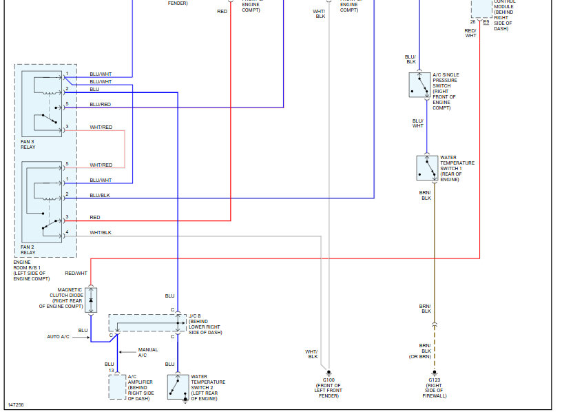

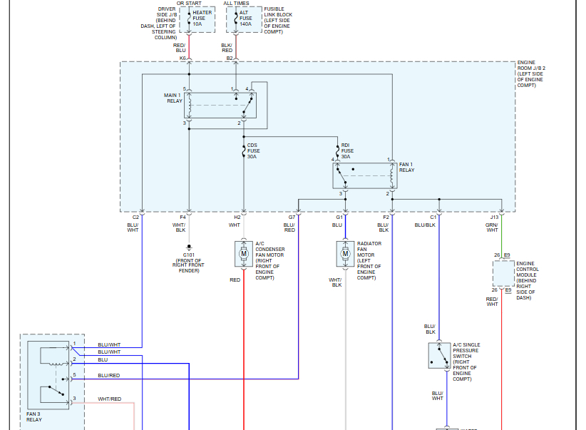

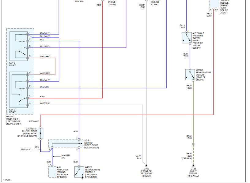

The cooling fan of the engine is not functioning. Could I have the wire diagram for the cooling system?
Feb 27, 2025 at 7:28 PM
  • 110,194 POSTS
Before tearing into the circuit, run power directly to the fans to make sure they are functional. If they are, keep in mind there are three relays. I just took a look and from what I'm seeing, fan relay 1, located in under the hood in the engine compartment, must work for the other two to get power. I would start there.
I attached the wiring schematic below for you. I had to cut the pic in two to make it readable. I did overlap the two so you can follow from one to the next.
I hope this helps. Let me know if you have questions.
