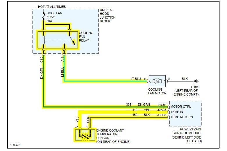

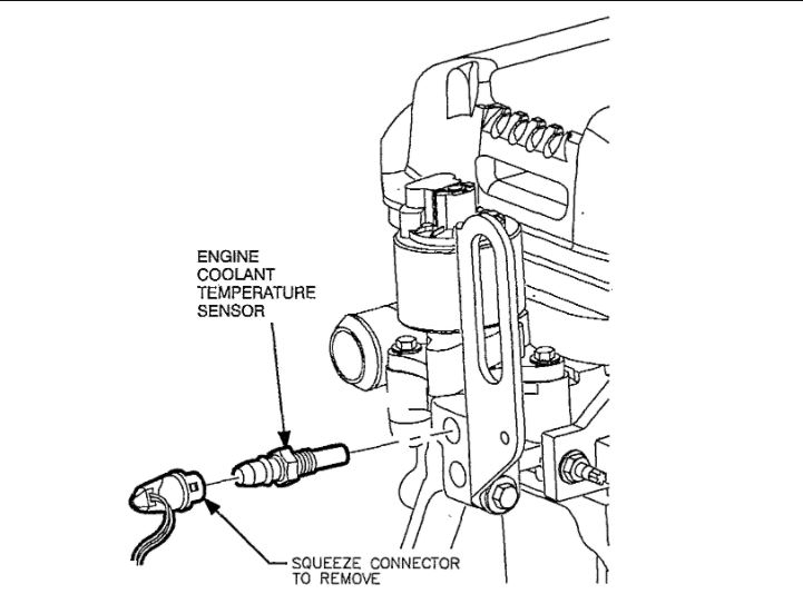

The fact the fan works when you removed the connector for the coolant sensor tells me all the wiring and relay are good. You either have a bad sensor, which I would replace, or the coolant is not hot enough from the thermostat partially open.
https://www.2carpros.com/articles/how-a-coolant-temperature-sensor-works
I attached the wiring diagram for you to view the system.
https://www.2carpros.com/articles/how-an-electric-cooling-fan-works
REMOVAL
1. Turn ignition Off.
NOTE: Engine coolant must be drained below level of engine coolant temperature sensor before removal.
2. Disconnect electrical connector from engine coolant temperature sensor.
NOTE: The connector must be removed by squeezing the sides. Apply pressure to sides of connector gently with pliers. Do not pull on wires.
3. Remove engine coolant temperature sensor using a deep well socket.
INSTALLATION
NOTE: Tap out sensor mounting hole in engine to remove any thread sealant residue. Clean any thread sealant from sensor threads and coat sensor with correct thread sealant if installing the same sensor.
1. Apply thread sealant Saturn P/N 21485277 (Loctite 242 Threadlocker or equivalent) to sensor threads.
2. Install engine coolant temperature sensor.
Torque: 8 NM (71 in. lbs)
3. Connect electrical connector to the engine coolant temperature sensor. Push in until a click is heard and pull back to confirm a positive engagement.

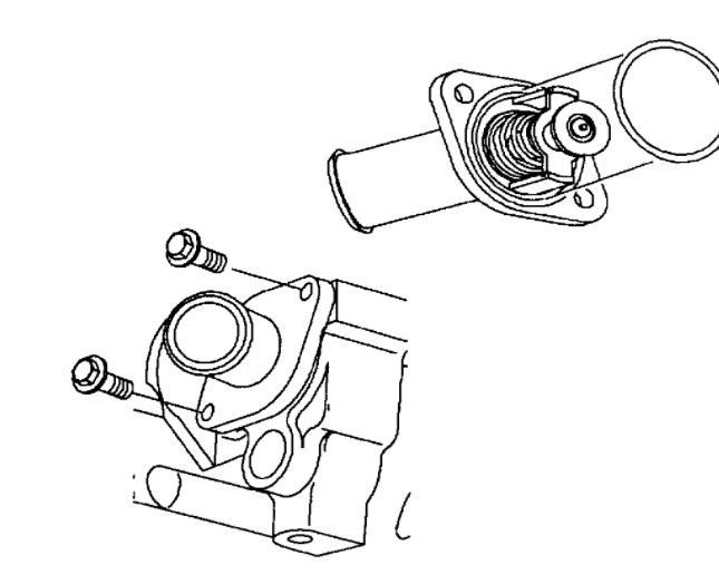

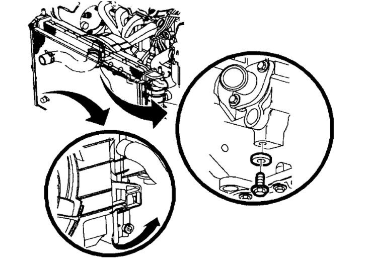

Thermostat
. Drain coolant from the radiator (1) and engine drain plug (2) located at the right front of engine.
2. Disconnect lower radiator hose at thermostat housing. Use Snap-on Tool HCP10 or 20 (or equivalent).
3. Remove two bolts in water inlet housing.
4. Remove water inlet housing and thermostat assembly.
5. Remove O-ring.
IMPORTANT: The O-ring gasket must be replaced whenever the thermostat housing is removed.
IMPORTANT: The thermostat element should not be removed if the assembly requires testing.
6. Remove the thermostat element using the service tool provided with the replacement element.
NOTICE: The thermostat will not function correctly once it is contacted by oil. If oil is found in the cooling system, it must be flushed and the thermostat's cartridge replaced.
7. Inspect the thermostat components for damage, seat deterioration, etc..

New temperature sensor installed.
Temperature gauge works.
Fan will not run with temp sensor connected.
Fan will run with temp sensor disconnected and A/C on regardless of engine temperature.

Okay, can you check the voltage at the temperature sensor and verify 5 volts to the sensor? It would be the yellow wire at the connector.

I have 5 volts on the yellow wire.
The Freon was low in the A/C, I charged it up.
Evidently the fan on signal comes from the A/C compressor starting.
Temp sending unit plugged in- Vehicle running, A/C on, fan runs, temperature gauge works.
Turn off A/C, fan stops, unplug temp sensor, fan runs, temperature gauge doesn't work.
Service engine code 117 (low voltage to temperature sensor) was cleared.
I really do not like electrical problems. 10 hours to find and 10 minutes to fix.

It is supposed to come on when it is disconnected. When it is disconnected, it sends a high temperature signal to the ECM and turns on the fans.
