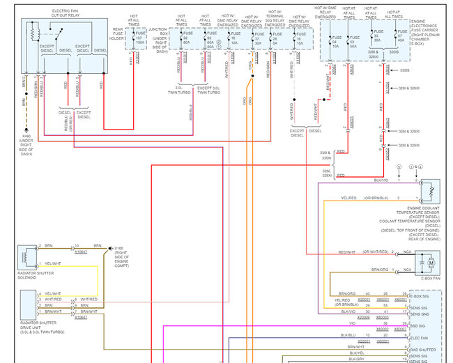

I have been having an issue with this car since i bought it. Drives strong. Fan always stay on high then shuts off then comes on high randomly. Usually with these cars it's a sign the pump is about to fail. Left it alone. Changed the coolant temperature sensor in the head. Nothing changed. Does not overheat. One day it gave the yellow light for temperature. So, i towed it in. No codes. Changed the pump and thermostat. Now it does not heat, stays around 220-230f if left idle for a long time. Fan still comes on while idling, at high, sometimes at low around 212 or so. Is there a relay for the fan that could be stuck? I left it running for 7 minutes and now the scanner shows 419f. Measured the radiator hoses and it's at 112 and 90f.

Is the HVAC system on when this happens? The reason I ask is because the fan will react to high pressure in the high side A/C compressor hose which can be the normal operation of the radiator fan. Please let me know if the HVAC system changes anything.

HVAC not on. Scanner reading 419 even when cold, hoses read 120, so reading is not correct. Wiring does not show anything about the location of the relay. compression is perfect. No leaks. These cars only have a coolant reservoir and no radiator to too off. Bled the system 3 times with the ignition on procedure which is common.

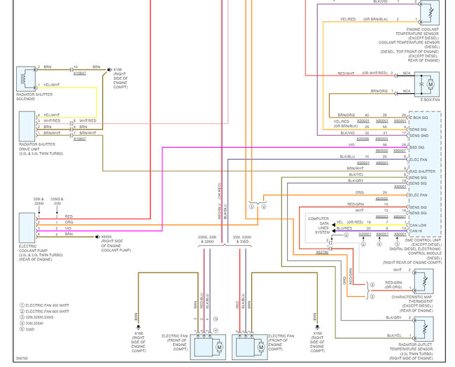

That is good to hear so the problem is fixed or? So, there is one coolant sensor and if the connections are good and the scanner gives you a coolant reading of 419 that means the DME is bad, but I would check all of the fuses in the wiring diagrams below.
Here is a guide and the fan wiring diagrams so you can see how the system works:

Fuses are good, tried another scanner and got the right reading between 220-230 idling.

I also found out that the car has a dang jb4, so you can actually choose for the fan to run more and more as an option so i turned that off.
