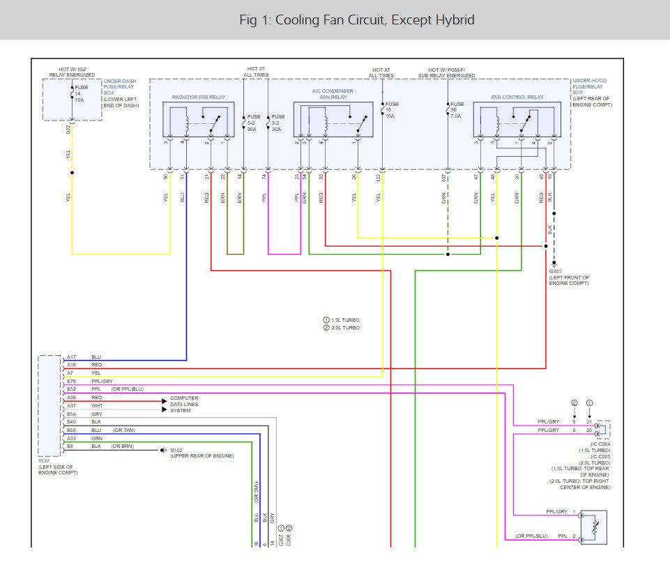

Hi Master team,
I have the car listed above (Sport). my car was overheating last month, I already replaced fuel injector a set of 4, engine cooling temperature sensor, fuel O1 sensor (sensor laf) and O2 sensor catalyst converter, and air flow sensor. is look like everything relay to to the fan is already changed, but the fan still not working. please help, and advise.
Also, I already replaced trouble relay in the fuse box located under the hood.
thanks.
Oct 11, 2019 at 4:35 AM
  • 55,694 POSTS

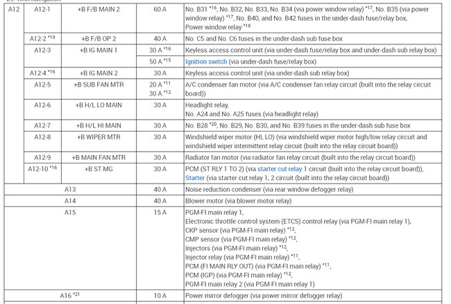

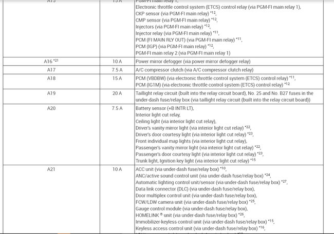

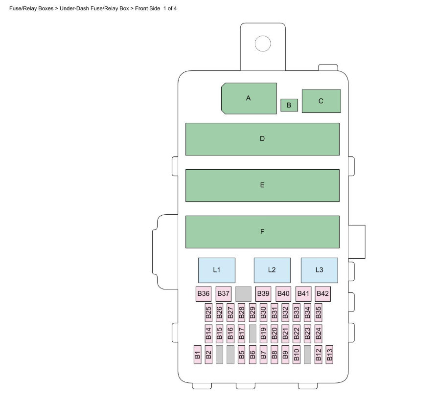

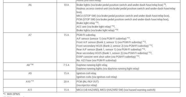

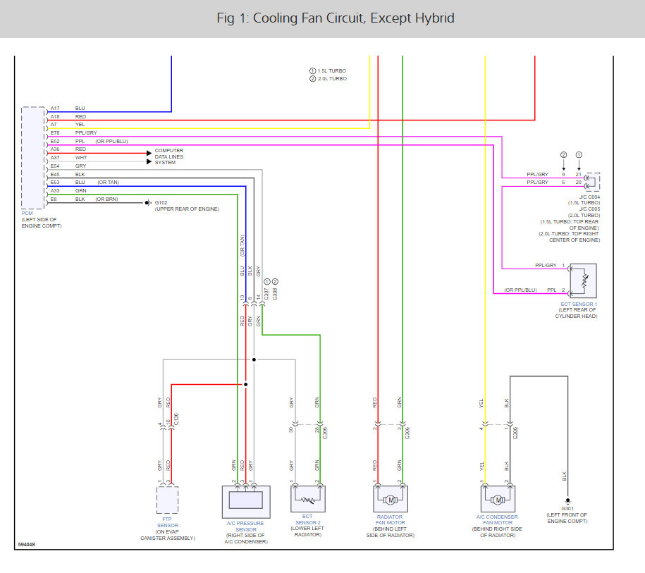

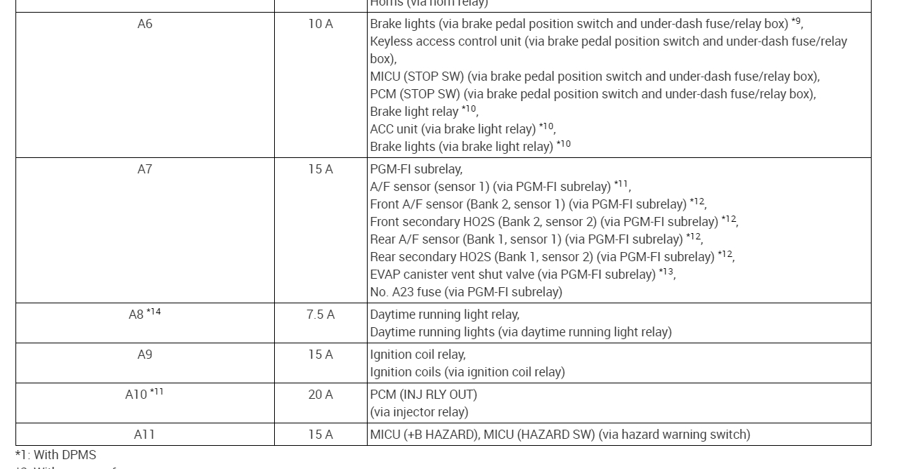

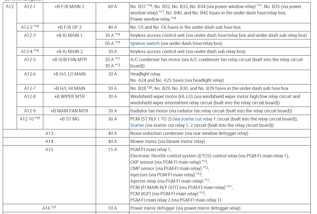

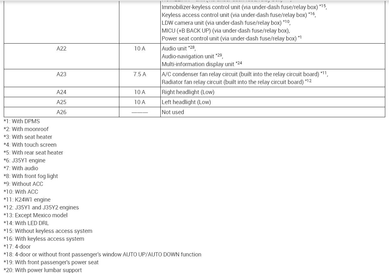

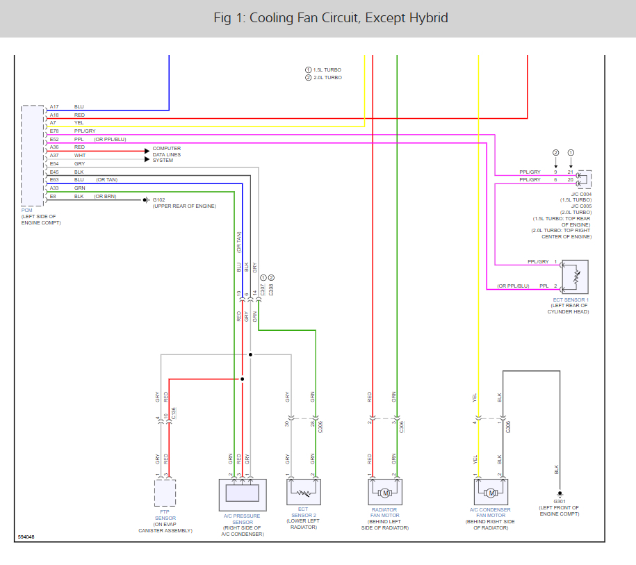

It sounds like the fuse #14 in the under dash fuse panel is blown or is not getting power. here is the cooling fan wiring diagrams so you can see how the system works and a guide to help us check for power and the fuse:
I have included the fuse location as well. Check out the diagrams (below). Please let us know what you find. We are interested to see what it is.
