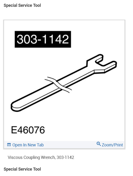

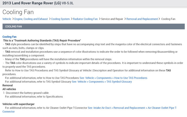

cooling fan which is electric that connected to the water pump is loud, like it is engaged all the time. I turned the truck off and turned the fan with my hand and it turns with some resistance, sounds like a jet plane when accelerating. please advise.
Jun 18, 2019 at 5:35 AM
  • 55,845 POSTS

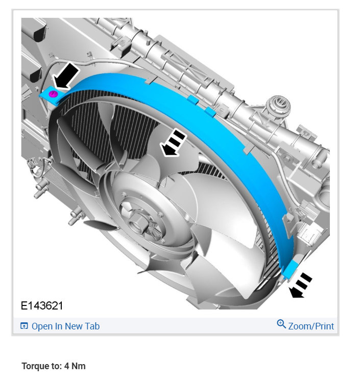

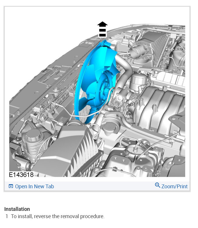

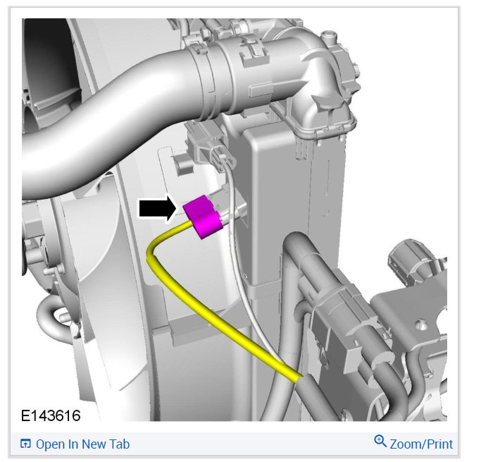

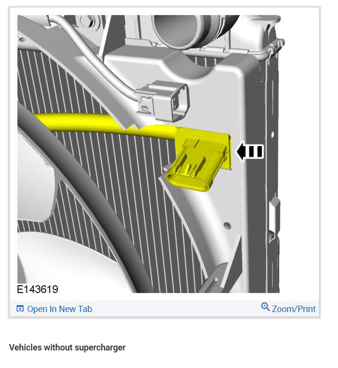

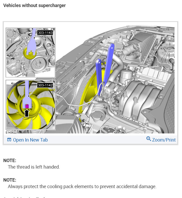

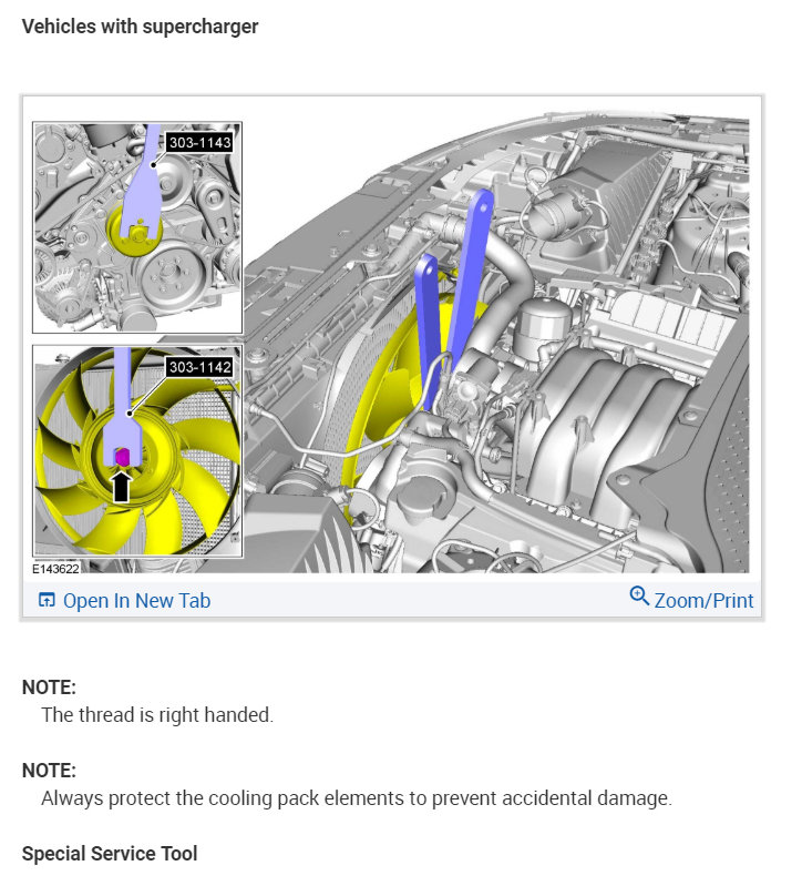

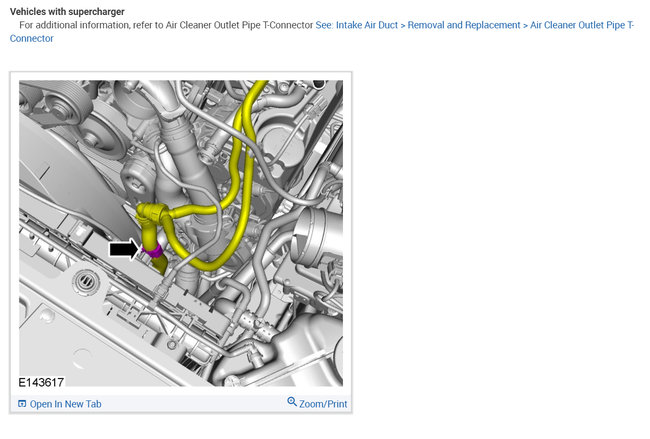

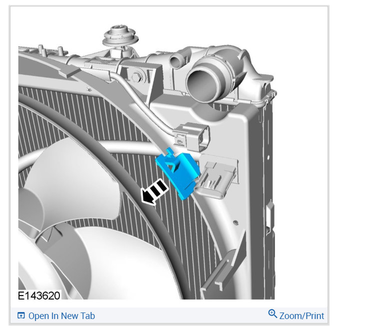

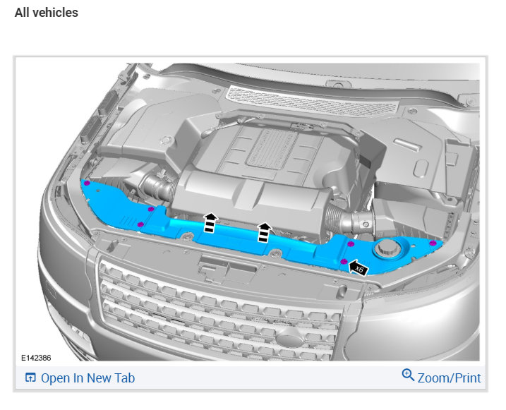

It sounds like the electric fan clutch has gone out which is common. here are instructions and diagrams to help you replace the part (below) and a video to help show you how to do the job on a different car.
https://youtu.be/N_-MLVlBHk8
