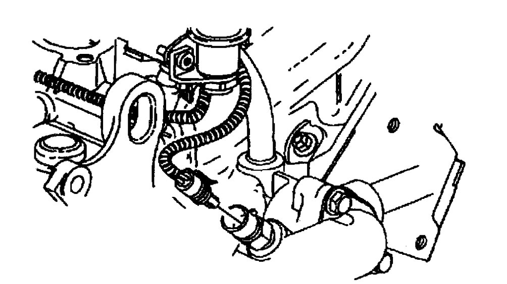

The cooling fans are controlled by the coolant sensor. A signal is sent to the ECM from the sensor when it get to the temperature the fans will turn on. It will then ground the control side of the relay and turn on the fan.
I would replace the coolant sensor.
The sensor is easy to replace and in plain view.
