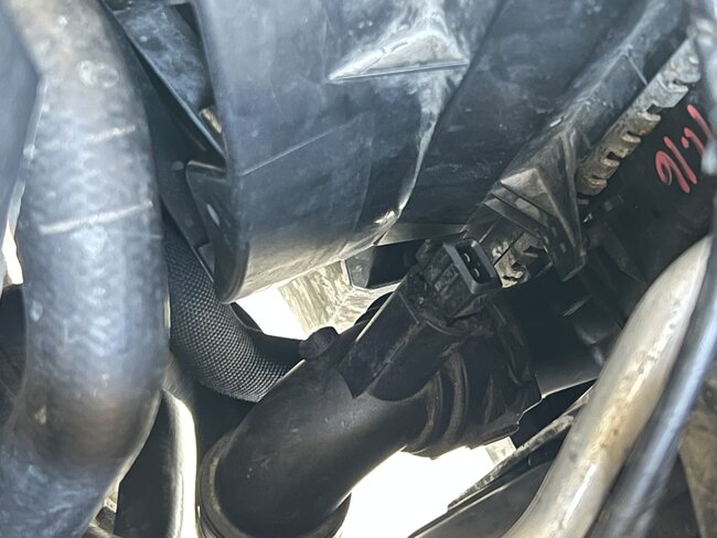

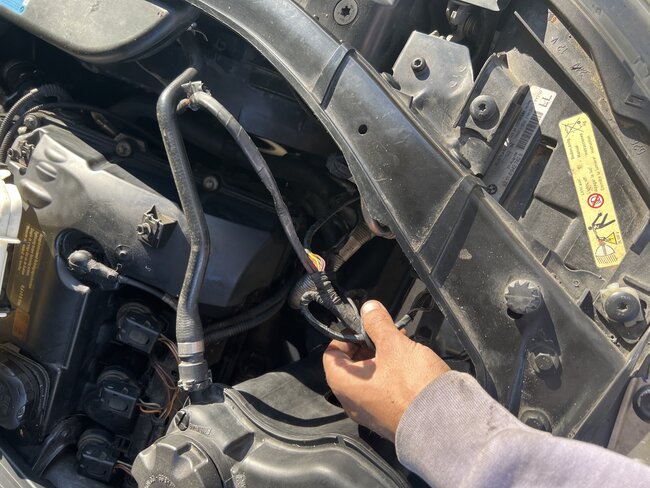

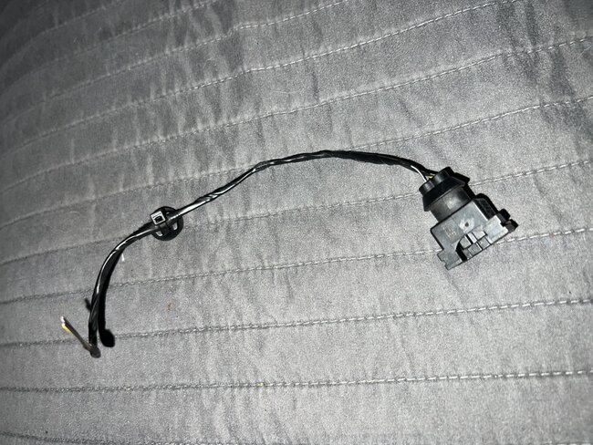

I bought this car, I the wiring is all messed up, I will eventually post another question concerning that… but anyway my fan is roaring, and I look by a coolant hose and notice a missing plug, I find the plug in the air filter box, I have. I clue where the wires go, while other wires are out of place.

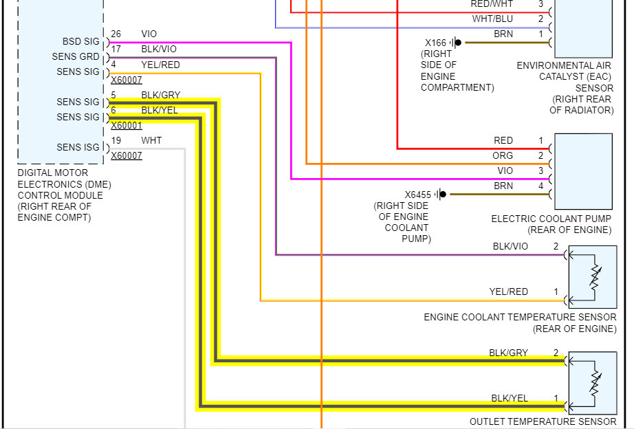

That is the coolant temperature sensor in pic 2. What colors are the wires in the harness you found?
The radiator outlet coolant temperature sensor is used by the DME to operate the cooling fans. The wiring should go to the DME. What colors are the wires in the harness/connector you have? See if they match the ones in the pic below.
See pic below.

They are black and yellow, the wires on this car are not good. When I connect the piece in, I don’t see anywhere to connect the wires, they possibly are gone or out of place (I found the connector in the air filter). I need a wiring diagram for the whole car honestly, I can show you what I am talking about in the morning.

If you go to the DME, is there anything cut? Also, I would be happy to provide the schematics I have, but I need to narrow things down. Otherwise, I will be attaching pics for a week. LOL

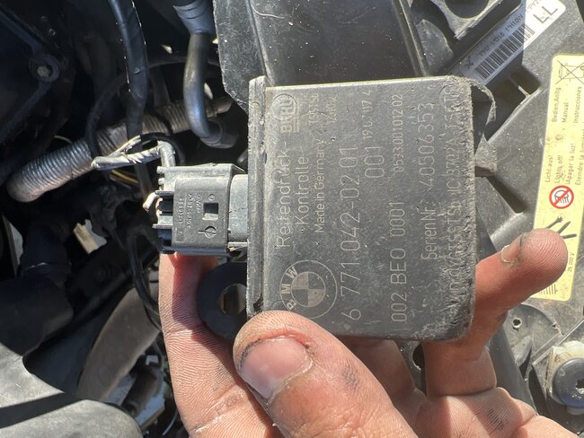

This is my dme and the others are the loose wires I’m thinking some terminals are missing.
Nov 22, 2022 at 3:59 AM

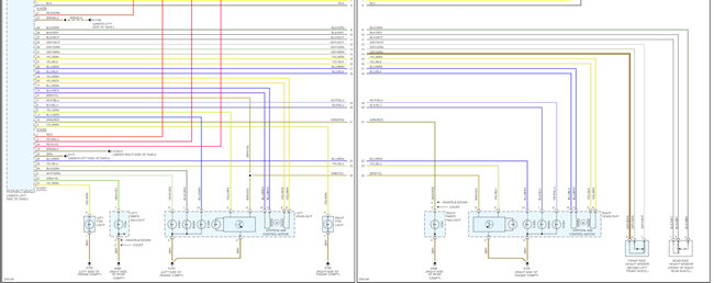

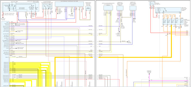

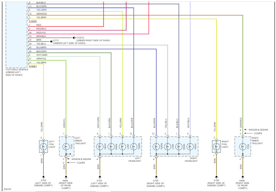

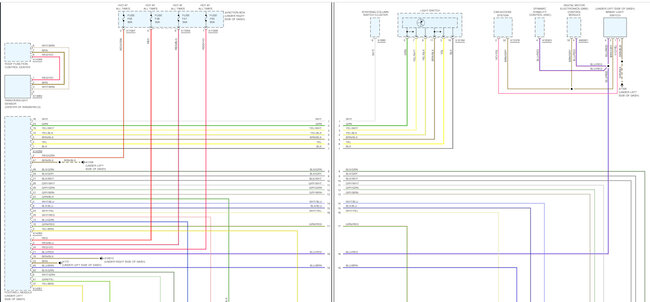

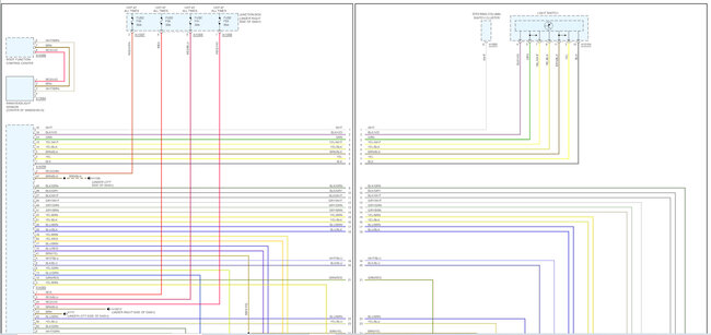

  • 110,251 POSTS

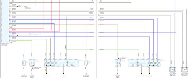

Pic 2 is the tire pressure monitor module. I'm not sure what I'm looking at in pic 3. I can only see a harness.

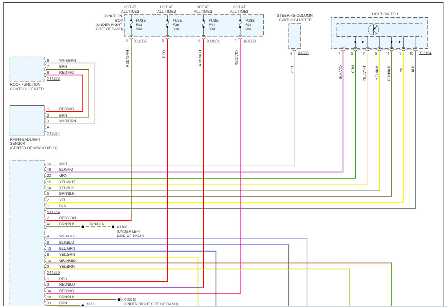

As far as the schematics, pics 1 and 2 are the headlamp schematics for the non-xenon lamps. Pics 3 and 4 are with the xenon system. Pics 5 and 6 are the adaptive front headlamp circuit.

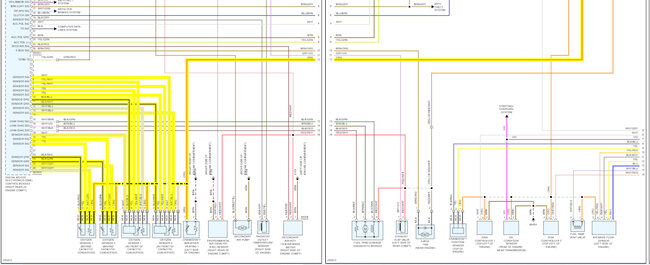

Pics 7 and 8 are for the oxygen sensors. I highlighted all wiring related to the 4 different O2 sensors.
I hope this helps. Let me know if you have questions.
See pics below. Note: I cut each schematic in half to make them readable for you. In order, every 2 pics is equal to the one page I got the schematics from.
