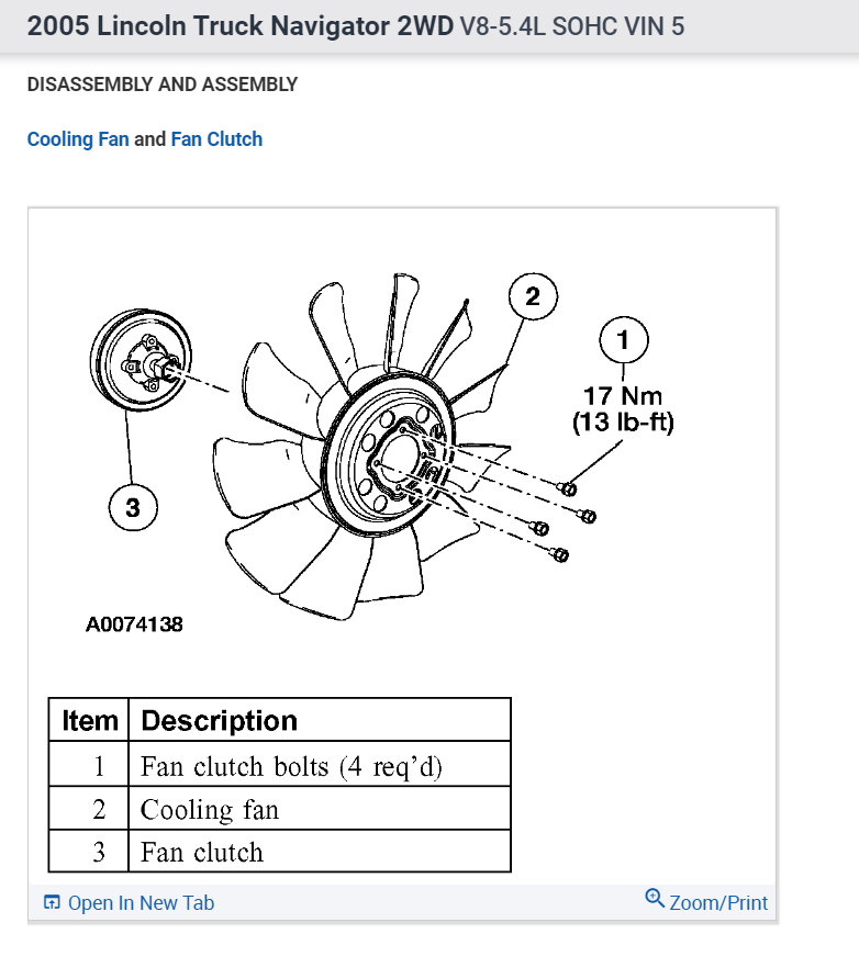

will a 2003 Lincoln Aviator cooling fan assembly fit a 2005 Lincoln aviator?
Jun 1, 2022 at 7:53 AM
  • 55,414 POSTS

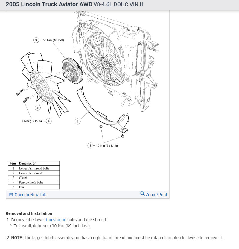

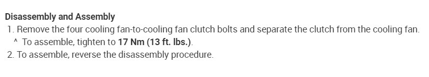

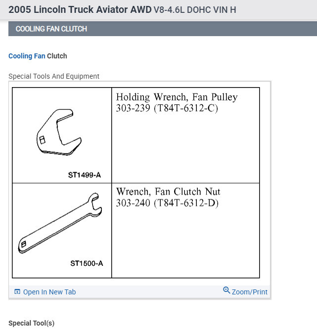

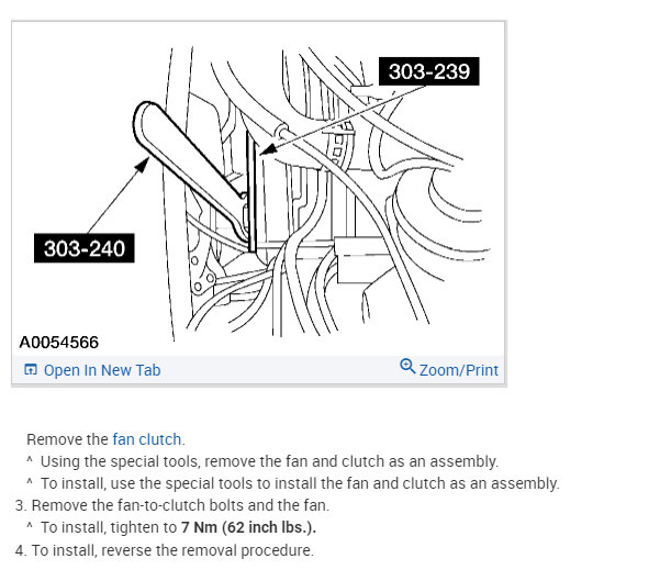

They are different part numbers so chances are not, but if they look the same and they have the same thread I would give it a try. here are the instructions on how to change them out in the diagrams below. This video will show you how to remove the fan:
https://youtu.be/N_-MLVlBHk8
Jun 2, 2022 at 2:15 AM
SQM
  • 6,383 POSTS
They have different part numbers, so they are not likely interchangeable.
Here is a helpful video:
I have attached the replacement procedure below.
Let me know of any questions.
