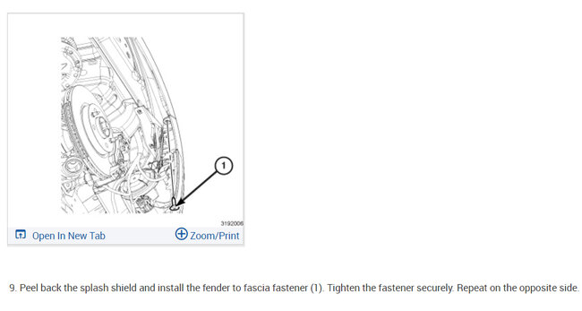

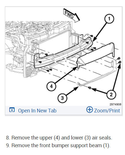

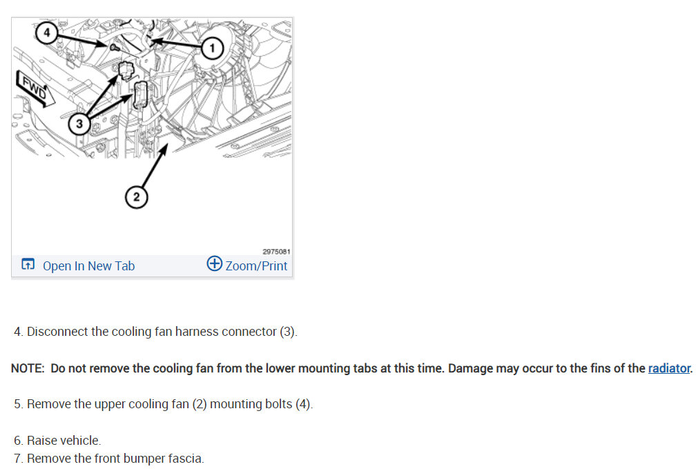

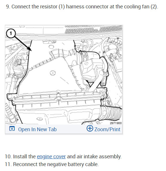

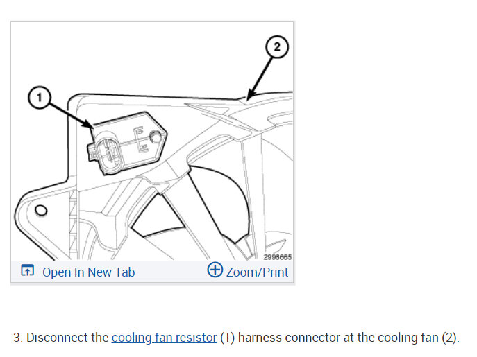

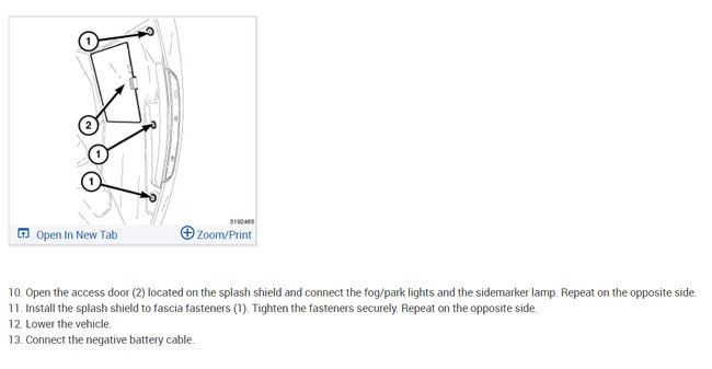

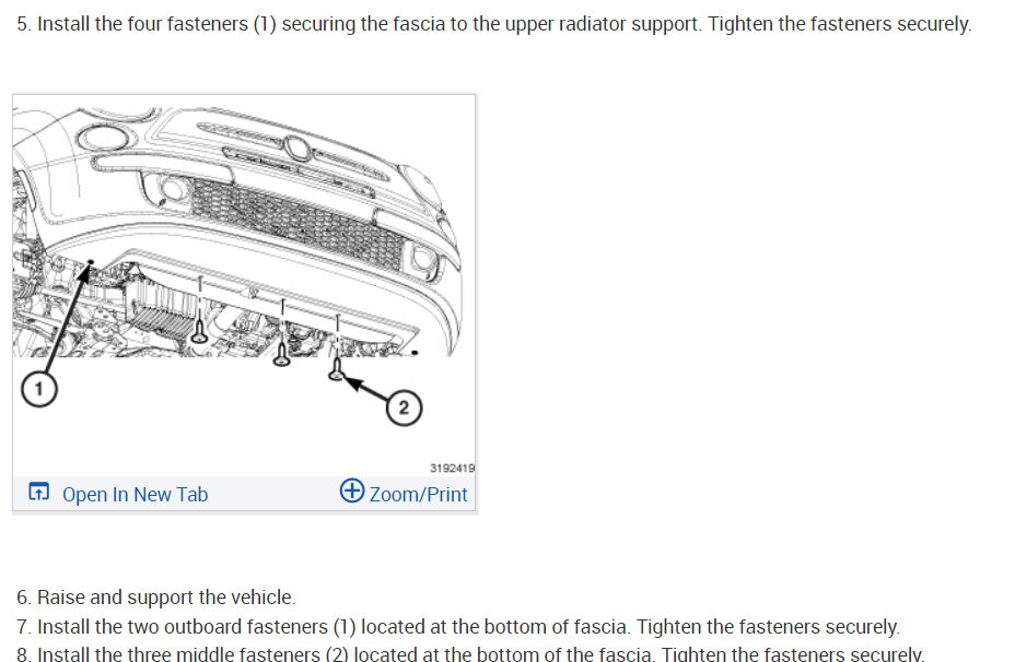

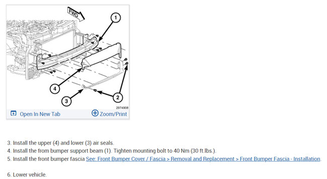

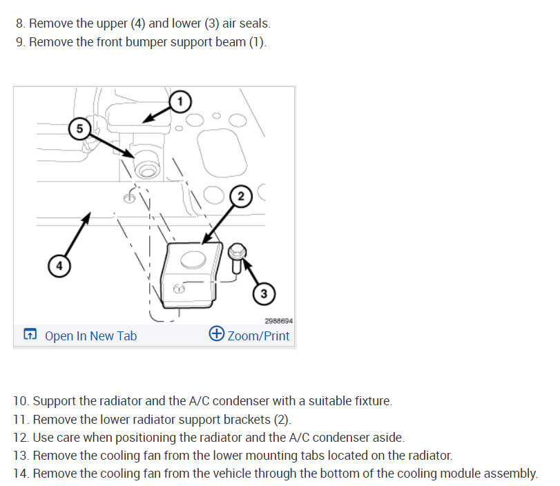

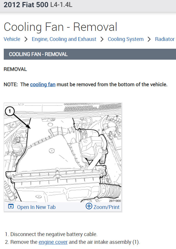

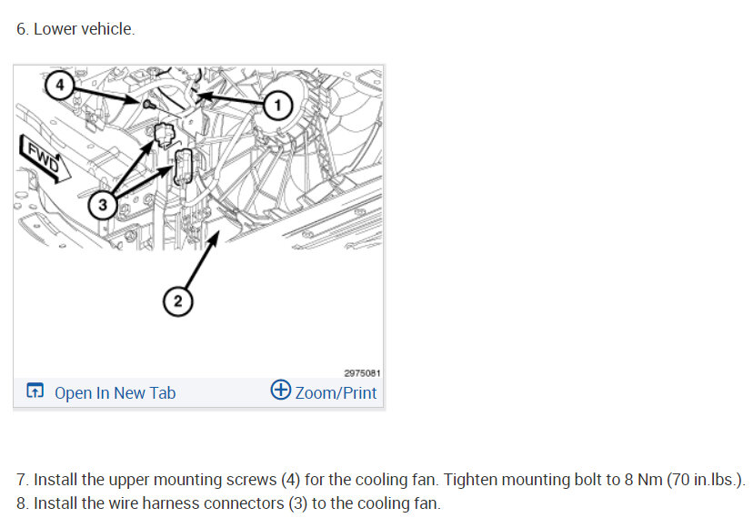

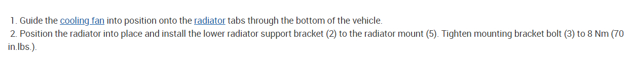

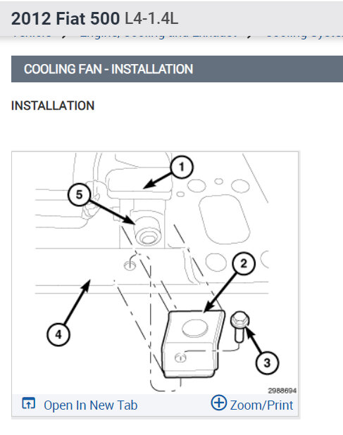

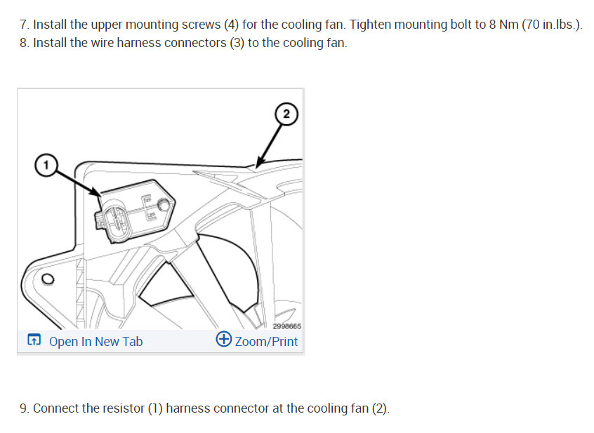

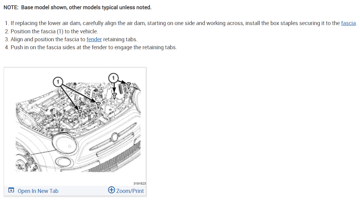

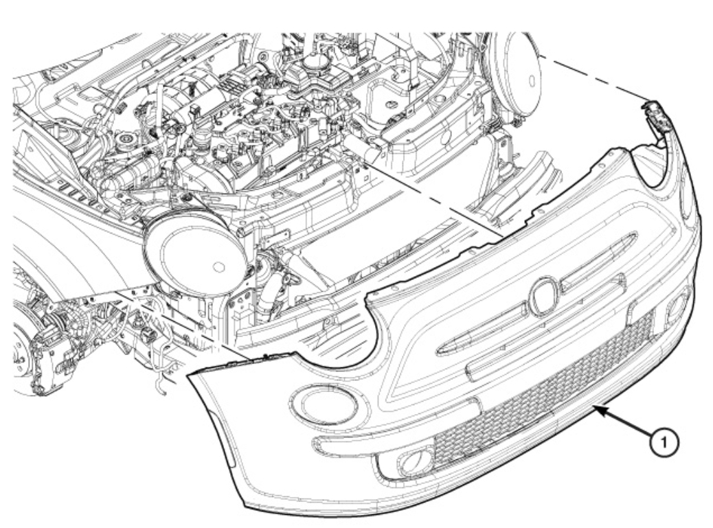

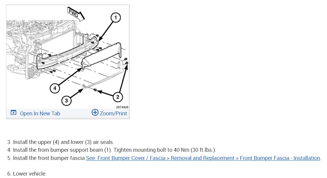

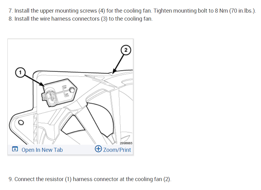

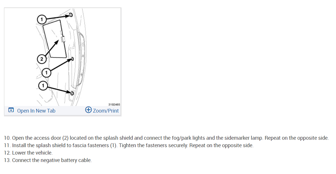

Fan blades are broken, does the radiator have to be removed to change the fan condenser unit?
Jan 10, 2024 at 3:00 AM
  • 55,806 POSTS
The radiator does not need to be removed but it does need to be loosened from its mounts. Also, the front fascia and bumper cover will need to be removed. I would start by disconnecting the battery. Here are the instructions on how to replace the radiator cooling fan. Check out the images (below). Let us know how it goes.
