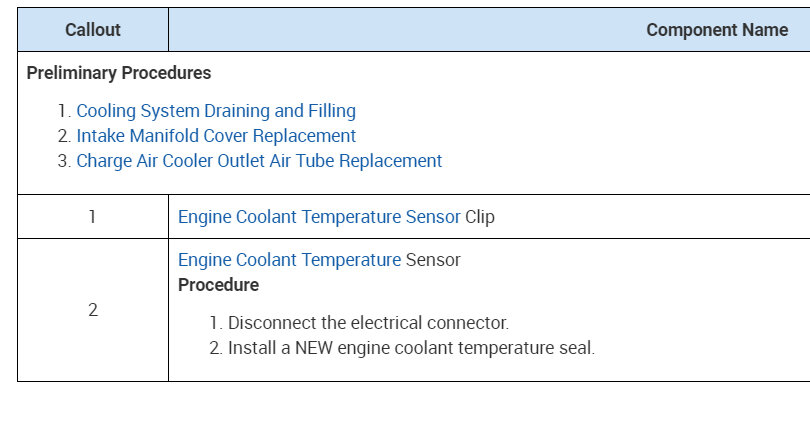

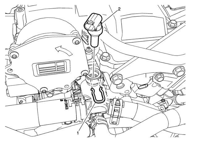

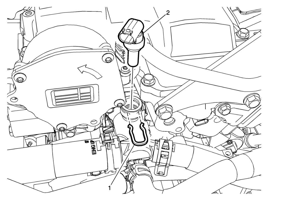

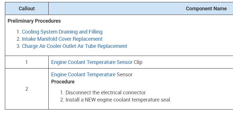

This sounds like a bad engine coolant temperature sensor, here is the location of the sensor so you can change it out to see what happens. Here is a generic guide to help you step by step with instructions in the diagrams below to show you how on your car:
https://www.2carpros.com/articles/coolant-temperature-sensor-cts-replacement
