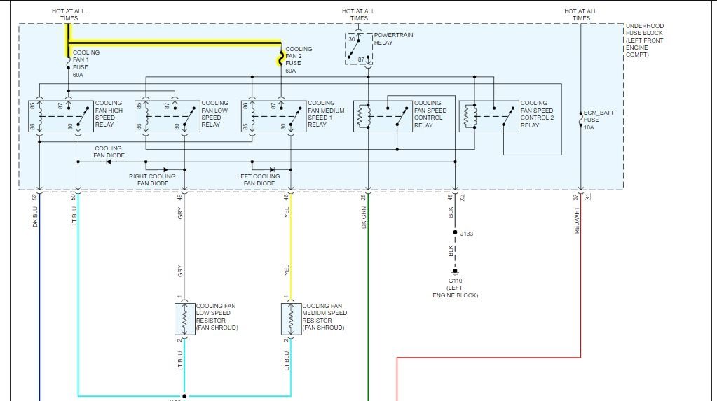

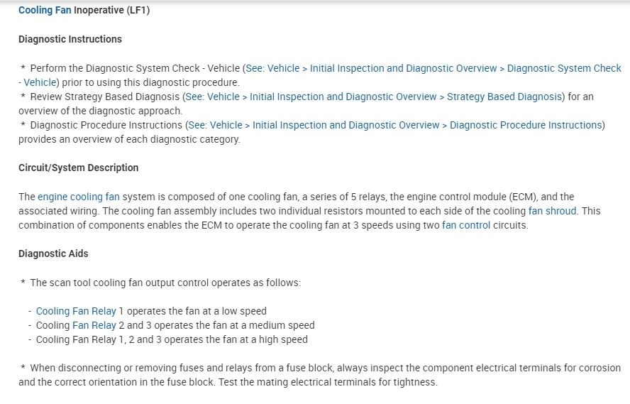

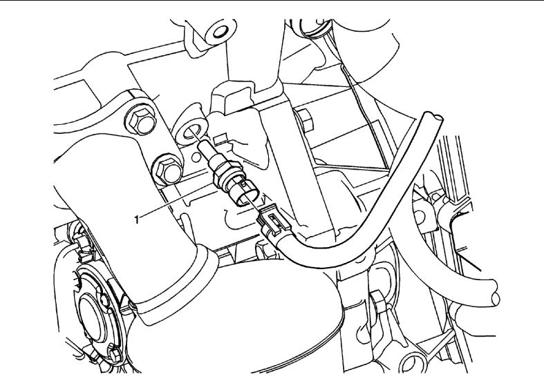

Test fan and power source without dealer computer?
Feb 26, 2020 at 8:30 AM
Good morning,

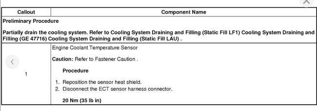

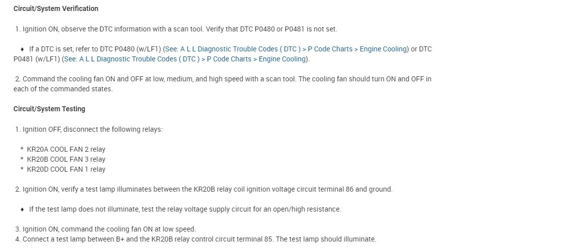

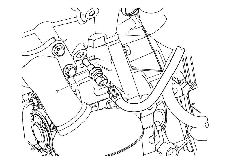

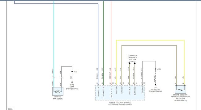

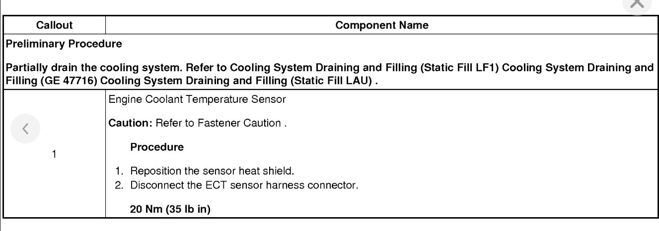

You can remove the connector for the coolant sensor with the key on. The cooling fan should come on.

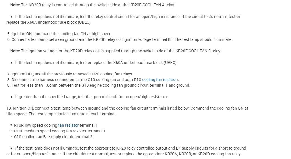

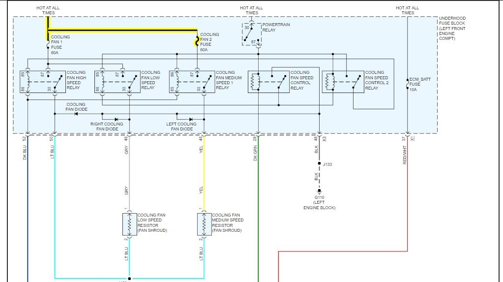

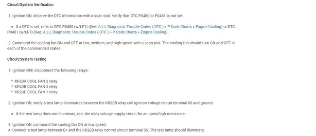

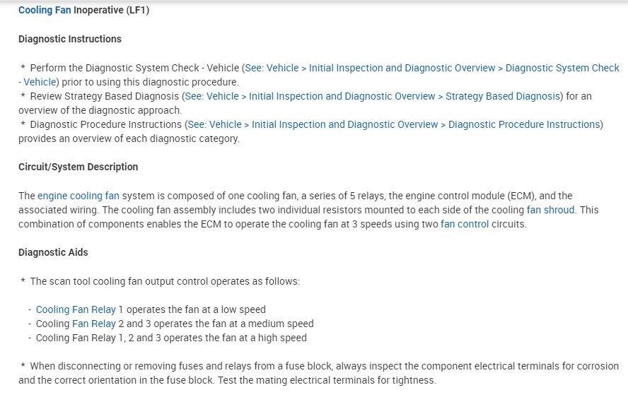

I will attach a wiring diagram and a flow chart for you to view.
