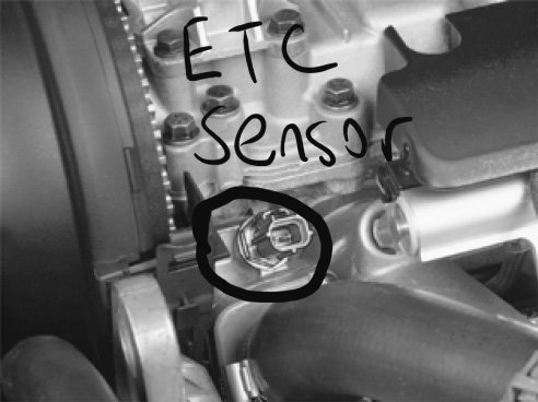

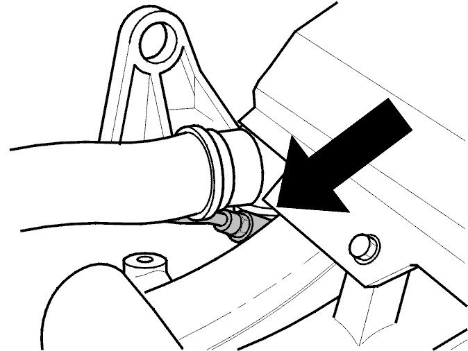

Hi JP, if the fans come on when the key is on then I would suspect a bad engine coolant temperature sensor. That will be the one used for the engine control module. The sensor is located on the thermostat housing. Attached image below. Remove the connector and also inspect the pins for corrosion. Most likely the sensor is close to open circuited or will ohm out in the mega ohms reading.
I would recommend replacing the sensor and recheck the operation of the fans.
