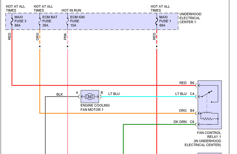

the engine is running hot, the cooling fan is not coming on. What is causing the problem? What do I need to check and how to fix it?

check all fuses in picture and both relays in under hood fuse box. they are marked on under side of the cover.
Image (Click to enlarge)
