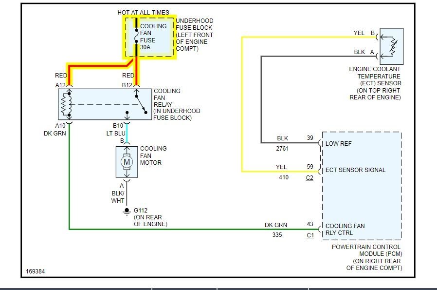

Installed new cooling fan, ECT sensor, relay and fuse.
If the thermostat is stuck closed will this not allow the fan to operate?
Jun 24, 2019 at 10:21 AM
Good afternoon,
Did you check for power to the relay? You need to test for power to the wires I highlighted in the diagram.
https://www.2carpros.com/articles/how-an-electric-cooling-fan-works
No, if the thermostat was stuck closed, it would heat up real fast and will turn on the fan.
Does it come on with the AC?

Thank you. I should be able to troubleshoot that tomorrow and will get back with the results.
