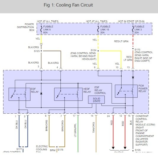

cooling fan not working. the only code we got was temperature coolant sensor. replaced and now no codes. checked connector for power. checked wiring and fuses. jumped fan and motor works. we do not know what else to check because we are getting no codes.
Sep 18, 2017 at 10:21 AM
CJ MEDEVAC
  • 11,004 POSTS
I may be of little help.

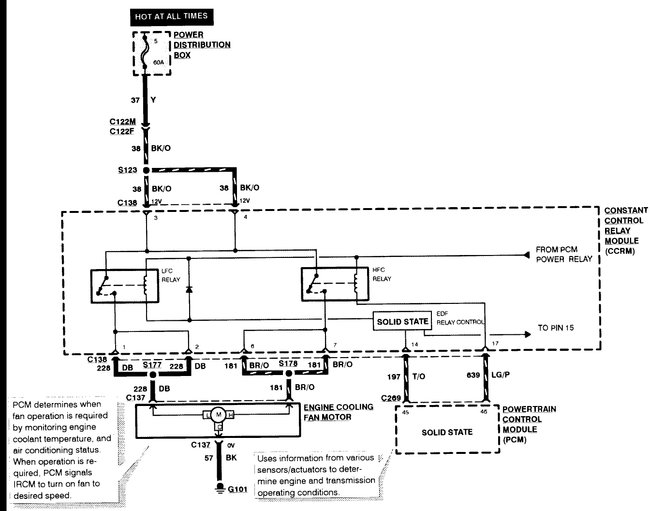

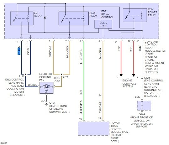

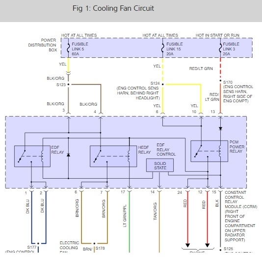

I was able to get you a diagram from "Prodemand" of the system.
You will see the grounds/ relays/ fuses/ etc. in the diagram. Locations of the components are usually listed beside them.
I had to make two screenshots to get the entire diagram. First one sits on top of the second one. I insured they overlapped so no information is lost.
I hope you just missed a fuse or something simple.

Does either speed come on if you turn the AC on? The relays that control the fan have a high and low speed depending on what is turning them on.
If the fan is not working at either speed I would test for power coming into and out of the constant control relay module. It is the module the PCM tells to turn on the fan. It is under the cover on the passenger side of the car on the radiator support.
Test the 60 amp link number five in the power distribution box. Then test for battery voltage at
both of the Black with orange stripe wires that feed pins 3 and 4 on the CCRM. If you have no voltage at those pins check the wire back to the fuse for damage or corrosion.
To test the relays themselves you need to connect a wire to ground and use a probe on the other end to probe the back of pins 14 and 17. Those are the two ground pins the PCM uses to turn on the fans high (17) and low(14) speeds. If you apply ground to pin 17 you should get battery voltage at the brown with orange stripe wire at the fan.
Ground on pin 14, you should get battery power on the dark blue wire.
If you have battery power at pins 3 and 4 but get nothing on either of the outputs when testing, the CCRM is faulty.
