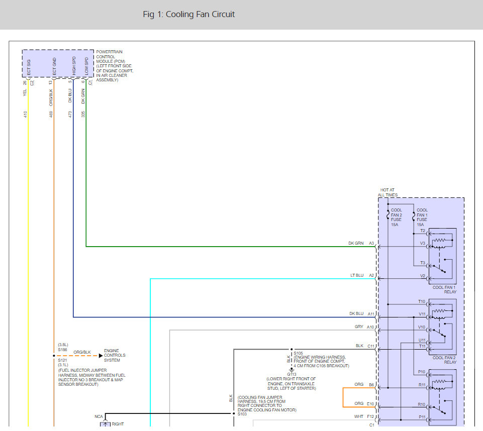

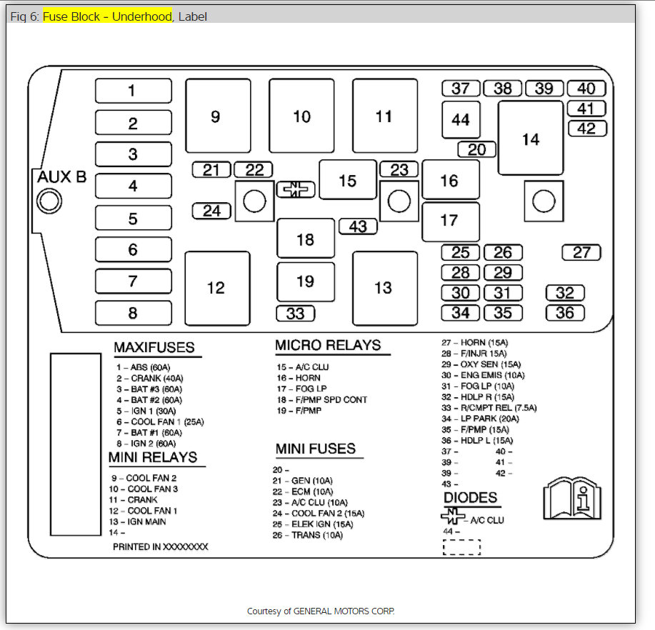

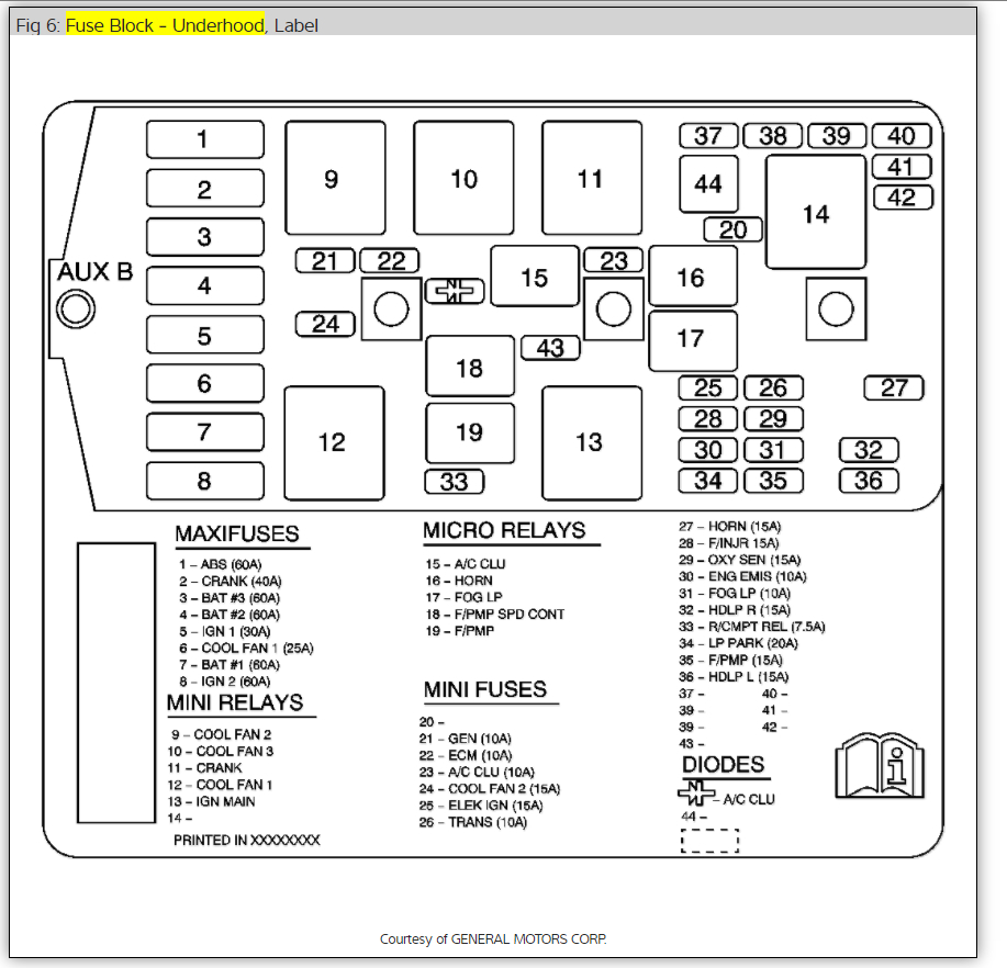

Fan does not come on and gets hot.
Sep 26, 2017 at 11:48 AM
Experienced Mechanic
55,604 POSTS

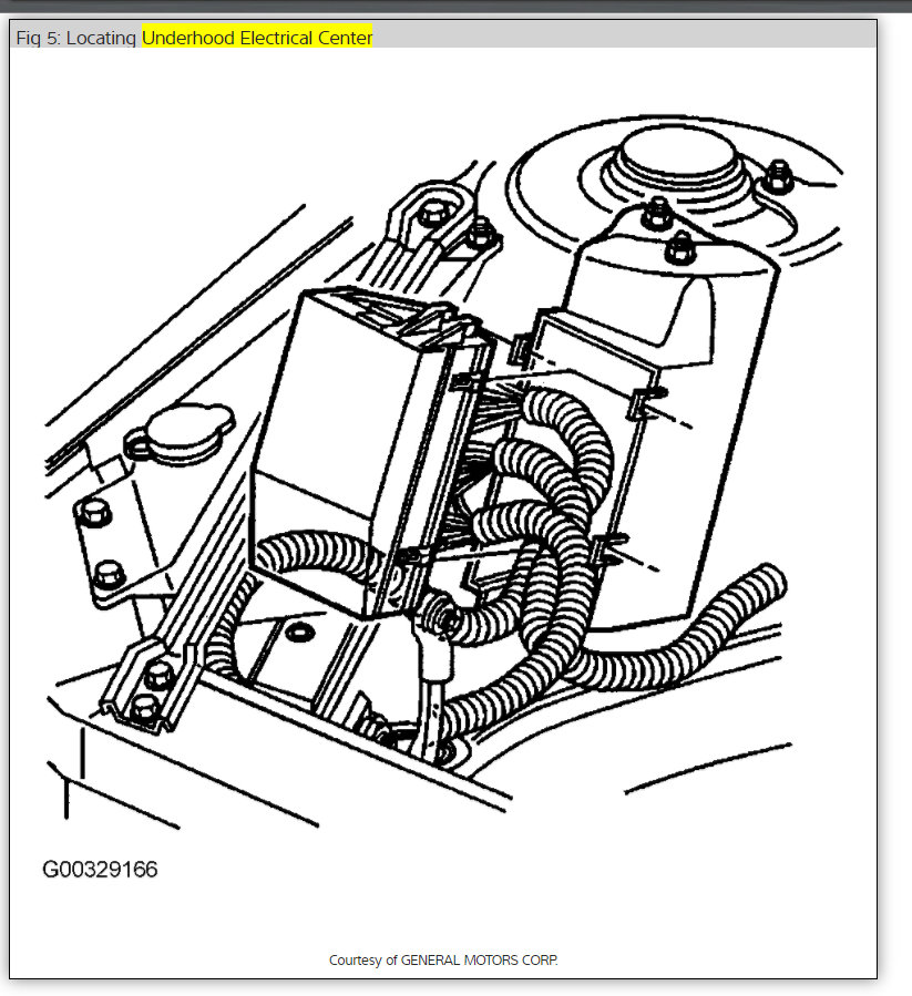

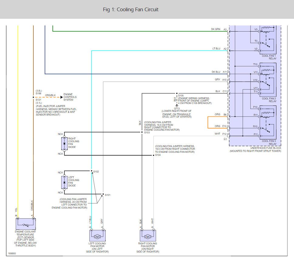

I would first by checking the fuses then the relays and then see if the fan motor is getting power and if so the motor will need to be replaced.
Here are some guides to get us started:
and
and
and
https://www.2carpros.com/articles/replace-electric-fan-motor
Please run some tests and get back to us so we can keep helping you.
