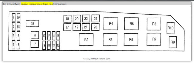

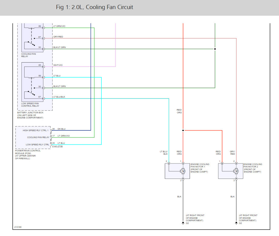

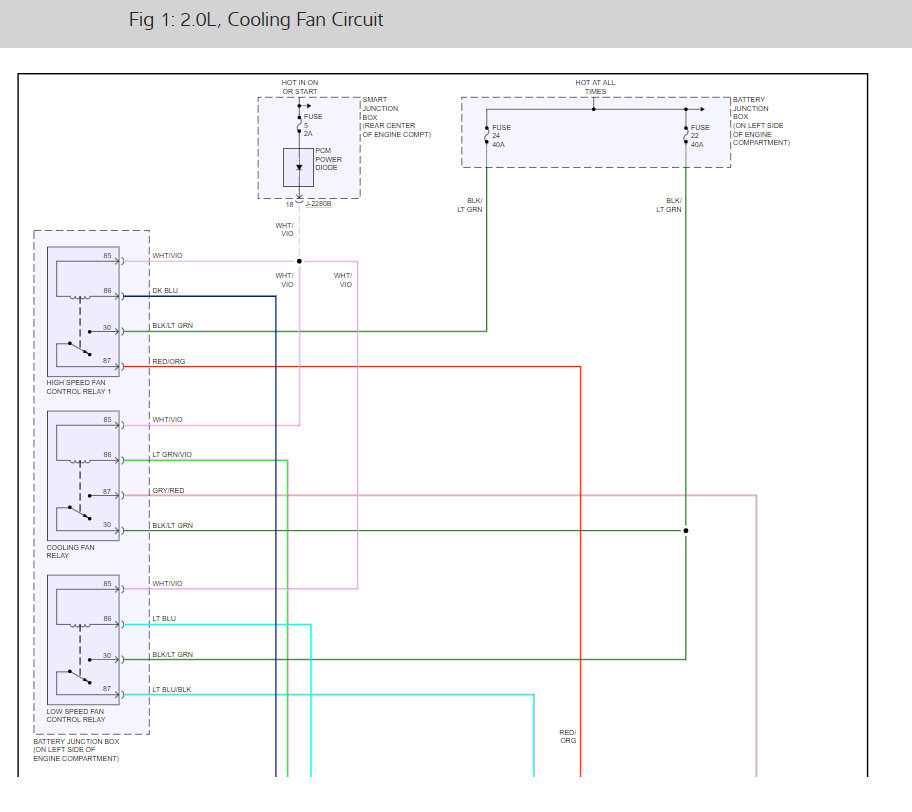

Lets check for power at the motors to see if they are working correctly. Here is a guide to help test for power and the cooling fan wiring diagrams so you can see how the system works:

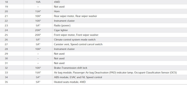

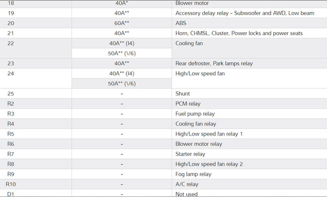

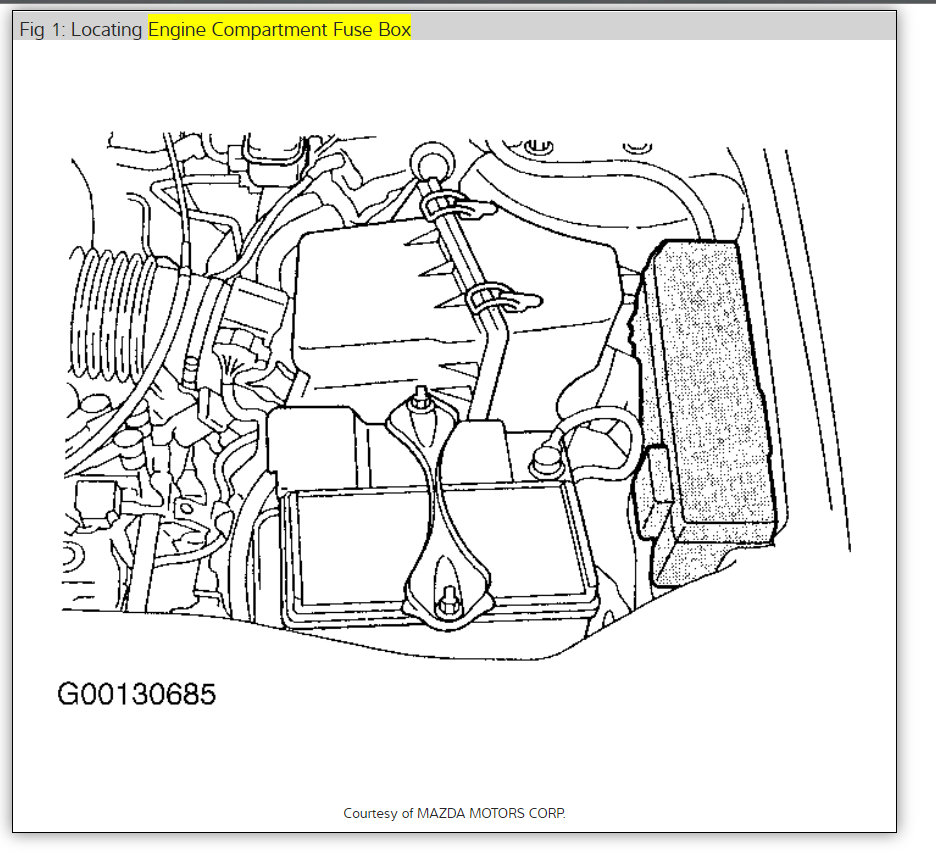

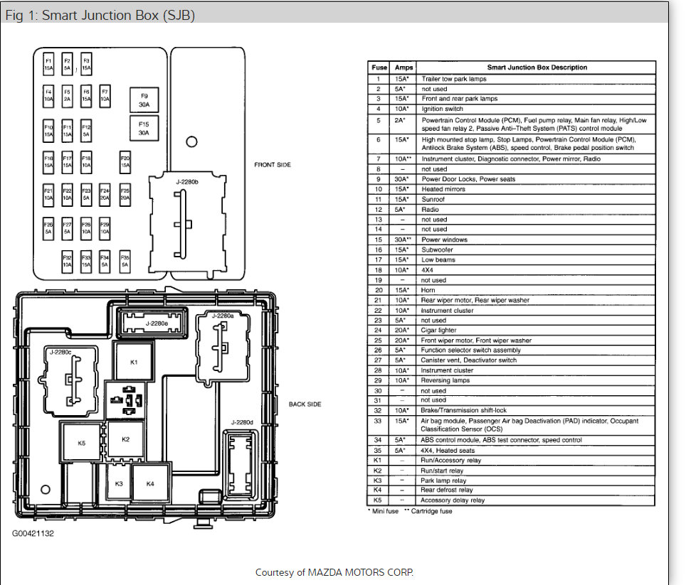

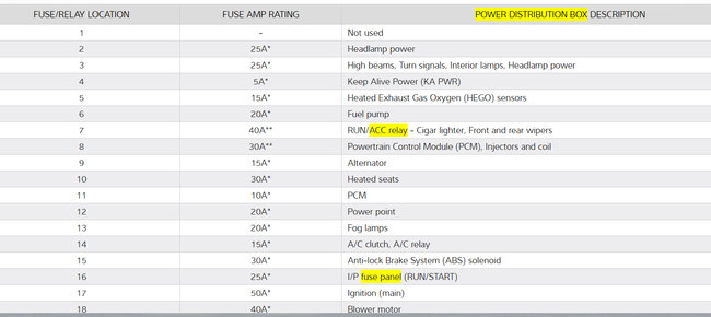

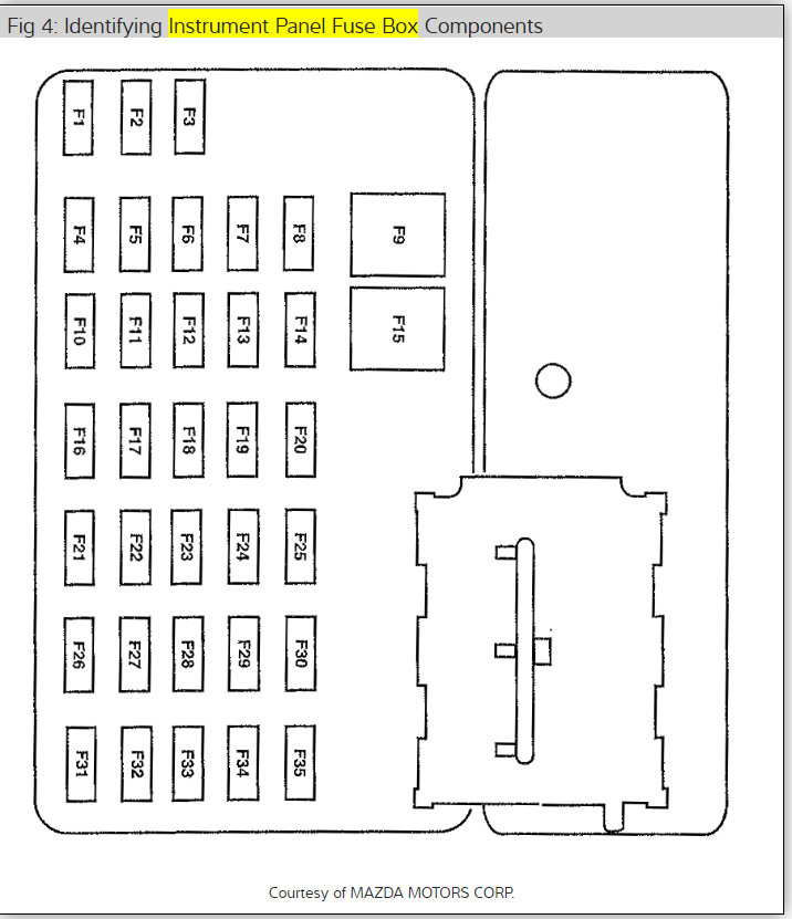

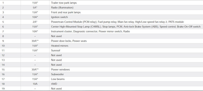

All you need is a test light. Lets check fuses #5, 22 and 24. Please make sure they are good. And get back yo me please. Also the relays.
and
I should have had you do this first. Check out the diagrams (below). Please let us know what you find.

i had an electrician check it yesterday and that the blue wire on the passenger side fan does not have voltage when normally they would both turn on when the A/C is turned on. while i notice that it briefly turns on (passenger fan) then the driver side fan quickly gains speed. I checked the fuses 5, 22, and 24 and they are not burnt.

The dark blue wire is for the high speed fan which may not come on until high pressure (temperature) is present. does the system work correctly other than the fan not coming on?
Lets check the relays next use this guide:
