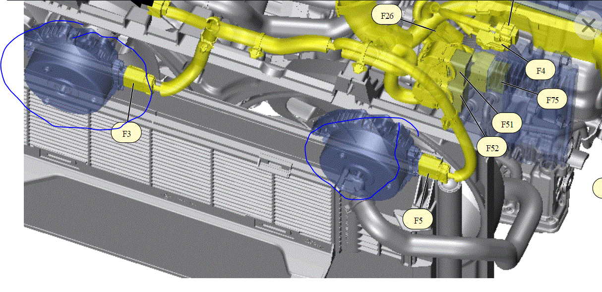

Good morning,

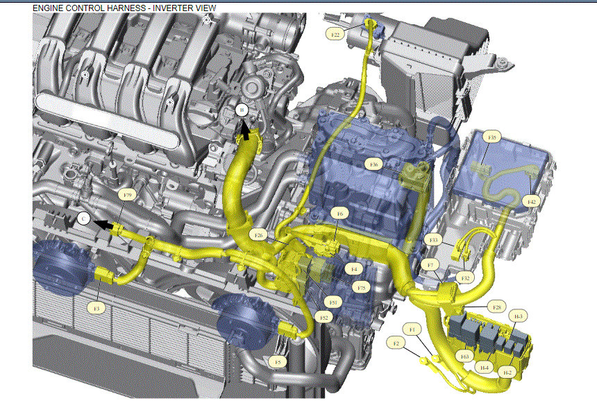

I attached the diagram and locations of the control modules for the fans.
Do you have a voltmeter or test light for some checks?
We need to test for power to the modules as well as power out of the module.
Aug 2, 2020 at 6:25 AM
ALBERTBERMAN
You sent me information that is for a different car than i stated in my message. we do have a 2018 Rogue but as stated in my message to you it is a Rogue Sport model a completely different car and therefore the engine compartment is completely different. please respond. thank you

ALBERTBERMAN
You keep sending me info that is not for my car. I need cooling fan diagram and parts location of fuses and relays that apply to the cooling fan for 2018 Nissan Rogue Sport 2.0 engine VIN # JN1BJ1CR9JW250778.
Aug 3, 2020 at 2:35 PM

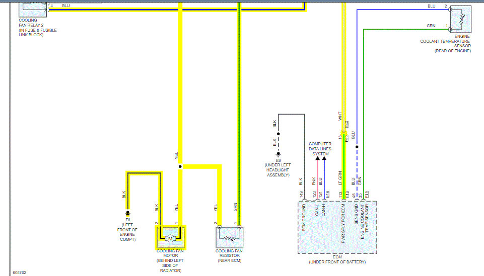

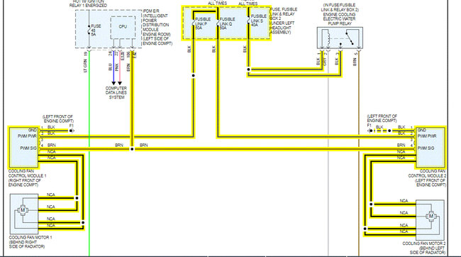

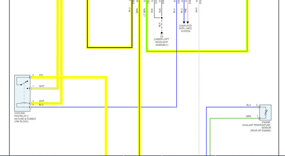

Okay, sorry about that.
I attached the correct diagrams for you below.

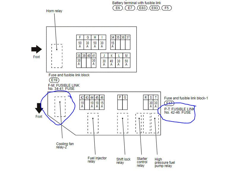

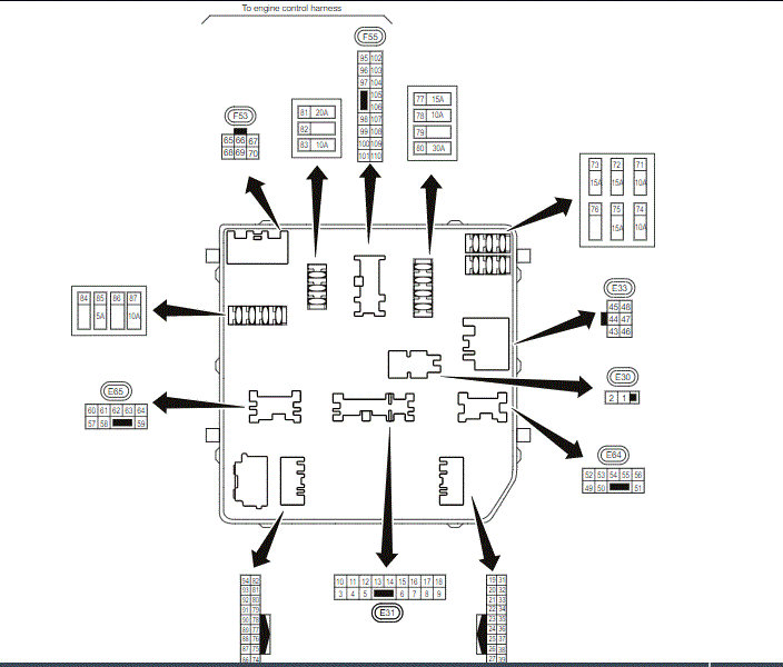

What about relay locations and fuses?
Aug 4, 2020 at 3:32 AM

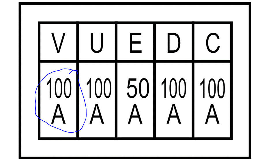

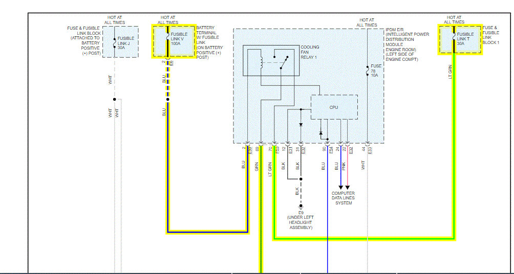

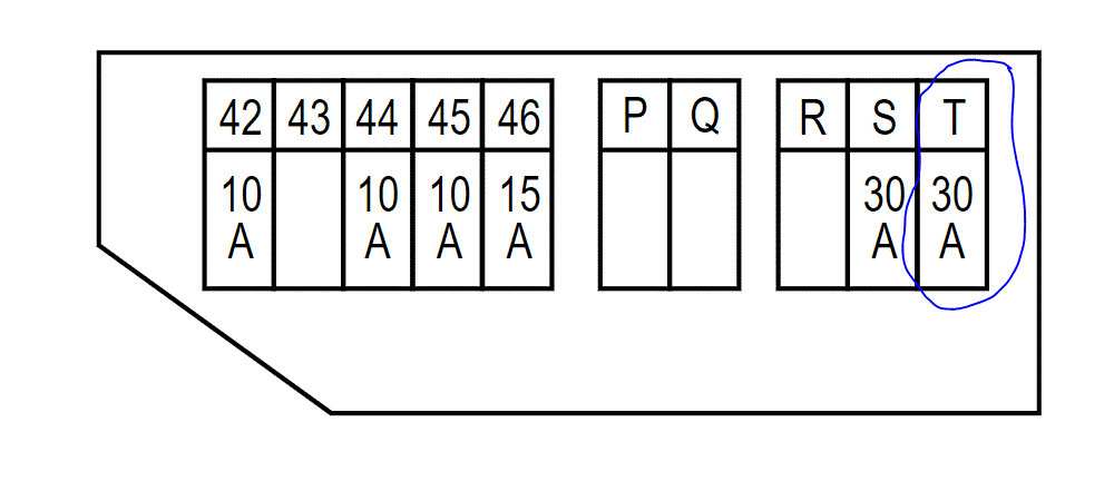

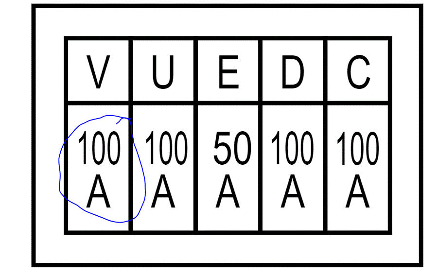

I attached the fusible link locations.
V is on the battery cable. T is in the relay box with the cooling fan relay.

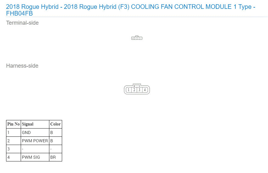

I attached the diagram for the power module as well.
Did you verify voltage to the fans? In your original response, you put direct voltage to the fans and they did not work but you never stated if you verified voltage to the fans.
