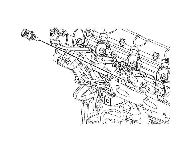

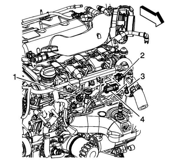

So my dad replaced the thermostat and water pump with OEM parts. So when I drive the car temperature stays below half. But if I idle for a while the temperature will raise 2 ticks above half and the cooling fan Kicks on and goes back to normal. But this happens every time I drive. Does anyone have a thought to what’s wrong?

It sounds like the coolant temperature sensor may not be sending the correct signal to the ECM for turning on the fan.
I would start by replacing the sensor and see if it comes on sooner. It should come on at 208 degrees.
