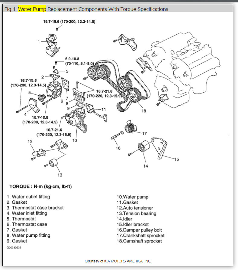

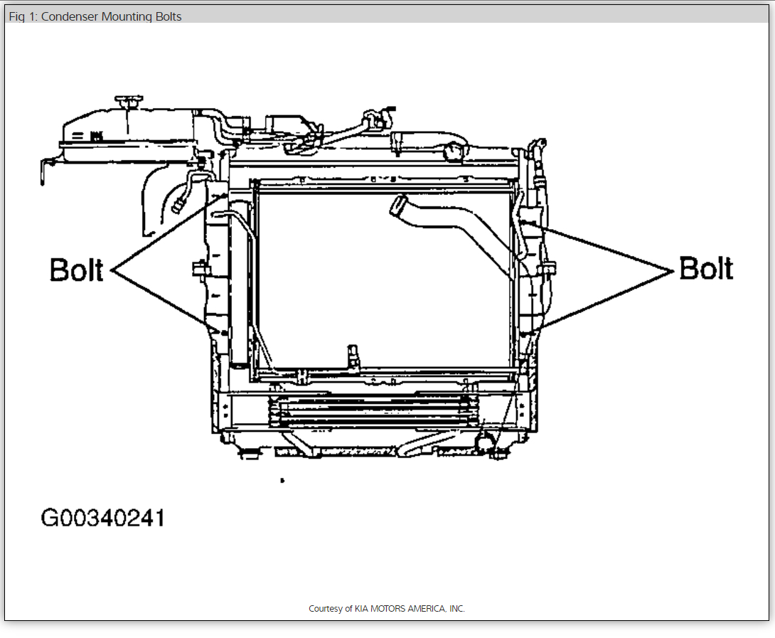

I need to replace the radiator and water pump can you please give me instructions on how to do so?
Sep 1, 2017 at 2:33 AM
  • 55,766 POSTS
Yep here are some guides and diagrams (below) that will help you get the job done, You will need to raise the car safely as well Here is a guide for that.
and
https://www.2carpros.com/articles/water-pump-replacement
and
https://www.2carpros.com/diagrams/kia/sorento/2005
and
https://www.2carpros.com/articles/how-to-replace-a-car-radiator
