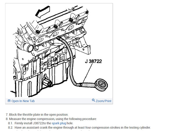

it is running a bit over half way. i have replaced both head gaskets, the radiator, the water pump, thermostat, and temperature sensor. i checked the cooling fans and they seem to be working fine. i have flushed the coolant system three times with prestone flush and removed block drain and refilled with fresh antifreeze, distilled water, and a corrosion inhibitor.. it builds up pressure on radiator hoses quickly upon a cold start, but i have checked for bubbles in the coolant and there are none. it's about 80 degrees outside and after a short drive the engine seems quite hot to me. is this normal?

When you had the heads off, did you have them checked for being warped or cracks?

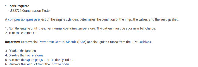

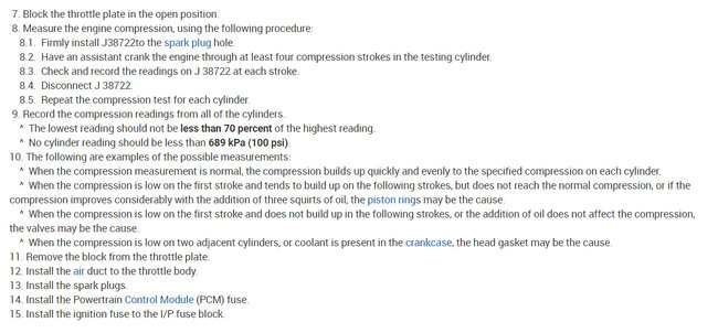

You may still have a head gasket issue. The fact it builds up pressure quickly tells me that. You need to have a leak down test done to verify. You also should have replaced all the head bolts during the repair.

They are not warped or cracked, the car has never been run hot. it sat for about 2 years and i bought a complete engine gasket set and tore it down to replace the intake gaskets and i figured i would go ahead and replace the head gaskets and valve seals while i was there, and since i had the gaskets.. Also i picked up new head and rocker bolts and cleaned all surfaces thoroughly, and torqued every bolt to specs. this is why i am puzzled.
