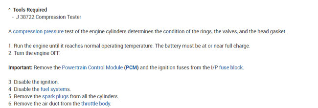

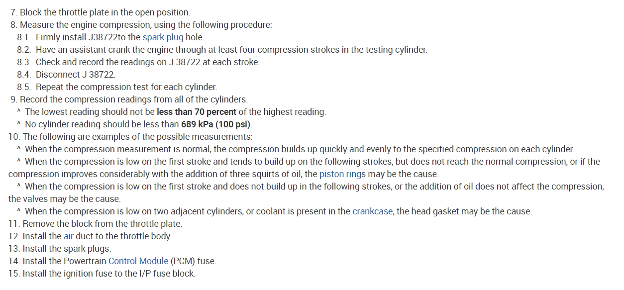

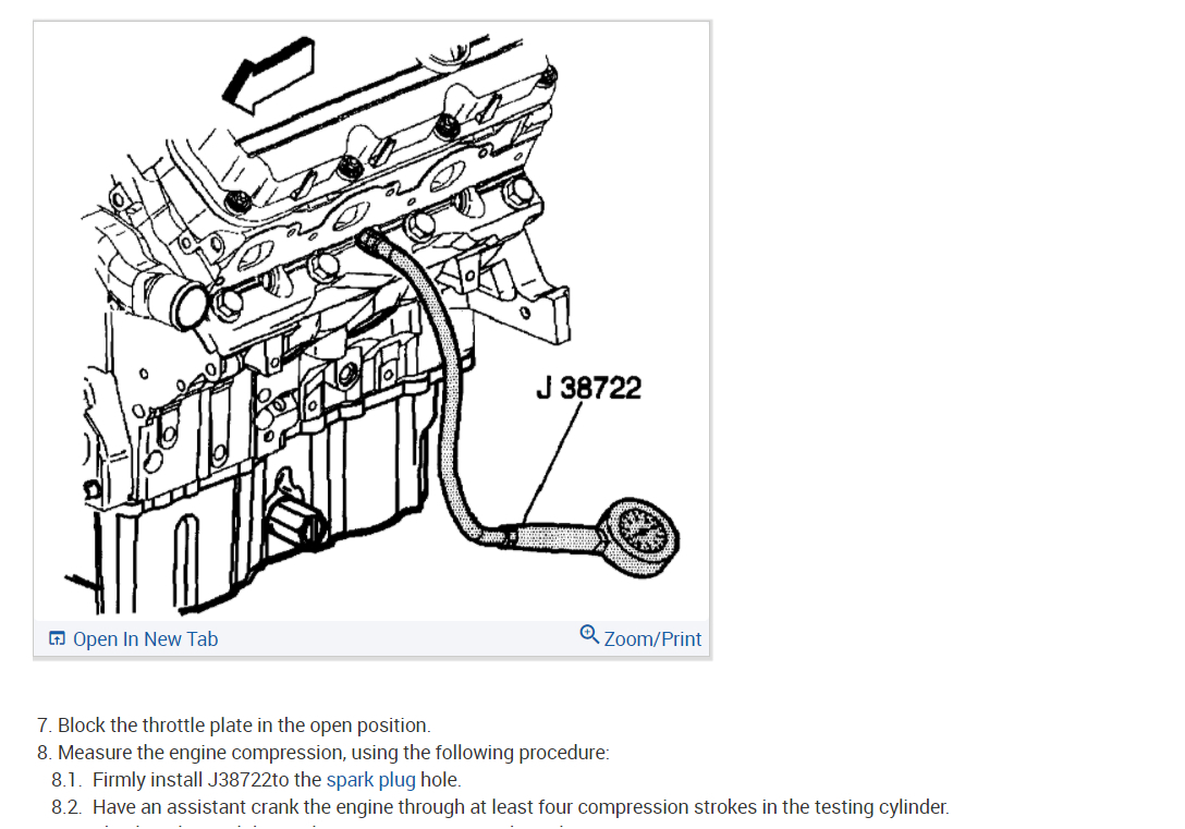

You may still have a head gasket issue. The fact it builds up pressure quickly tells me that. You need to have a leak down test done to verify. You also should have replaced all the head bolts during the repair.
