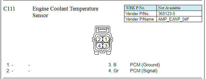

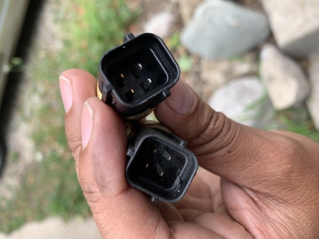

The coolant temperature sensor went bad so I wanted to change it, but when I got to it I notice that for some reason the previous owner got rid of the connector and just connected 2 terminal to the pins, and it was working fine. but, the problem is that the terminals unplugged and I’m not sure in which of the 4 pins they are supposed to go. I have 2 terminals but the sensor have 4 pins.

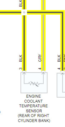

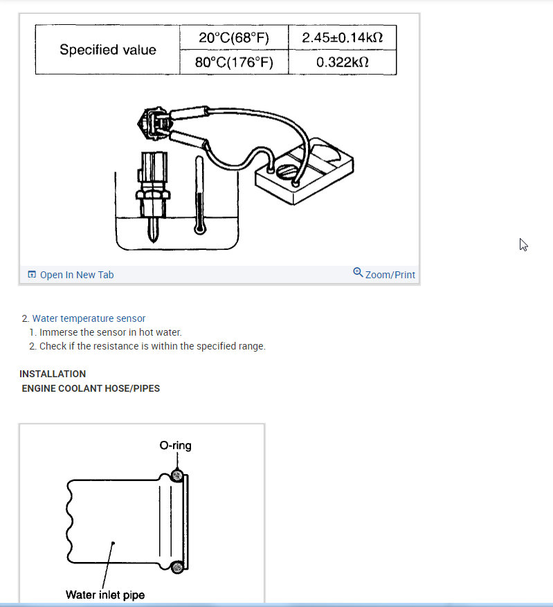

Can you get a picture of the sensor that you are replacing and the one you are replacing it with? Are they the same?
The reason I ask is because the engine coolant temp sensor is supposed to be a 2 wire sensor as shown in the wiring diagram.
If the sensor you are taking out is a 4 wire sensor as well then we have an issue somewhere.
Let's clarify this and go from there. Thanks

DAVID300
The old one and the new one.
Jul 27, 2020 at 7:27 AM
Okay. Clearly you have the correct sensor. Looks like pin 1 and 2 are not used. Take a look at the diagram attached.
At this point you will either need to put the wires back on the way they had it or replace the connector end or entire harness. Clearly all you need is the connector so I would not replace the entire harness.
Let me know what questions you have.

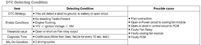

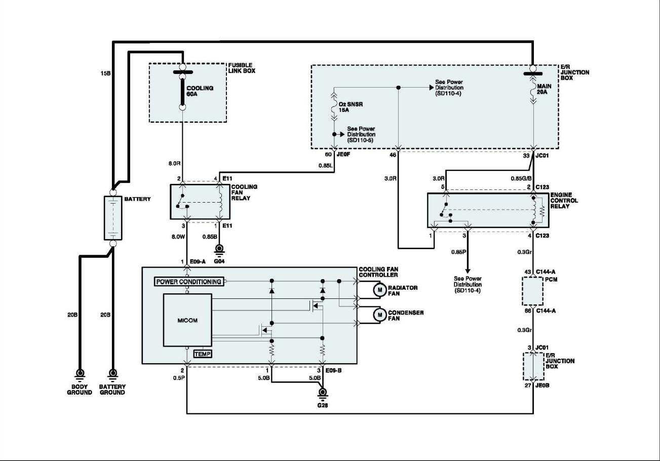

Check engine light, diagnoses as code p0840. Shop told me it was the fan control module that was bad, causing both my fans to not turn on. Said I was lucky not to overheat. Drove home and ordered factory Kia replacement fan control module. Replaced with new module. Still the fans do not work and check engine light reappeared. Engine appears to get really hot yet my gauge says I am fine. My question is this, could it be a faulty coolant temperature sensor, that fails to tell the computer the engine is hot, therefore the fan control module is not told to kick the fans on? That is my next theory anyway. Does that sound logical? I ask because I suspect my engine is much hotter then my gauge says and the fans will not ever turn on no matter how hot. Am I on the right track? Thanks.
Dec 19, 2020 at 1:56 AM (Merged)
KHLOW2008
  • 41,814 POSTS

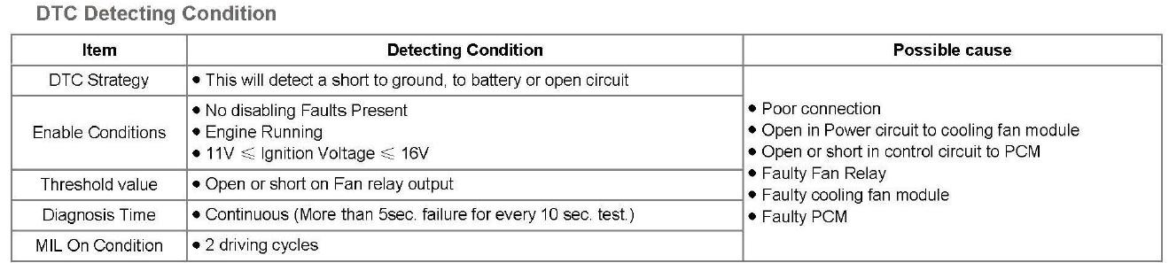

Hi CMCQUIVE,
For a fault with the coolant temperature sensor, I believe you have typed in the wrong code. It should be P0480 and not as that shown in your question.
Each code is specific to the cause of the problem and in this case it does not mention the engine coolant temperature as possible cause so the possibility of it being faulty is not high.
To understand if the engine is running hot, a scan tool would allow you to read the coolant temperature of the engine. Guesswork is not a good idea for technical problems.

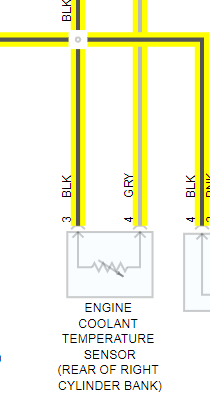

The attached diagram gives brief description of the problem and possible causes. Use the schematic diagram to find possible fault areas or components.
You have replace the fan relay and that leaves you with a few other possibilities.
One of the most common cause would be a bad connection or ground circuit which should have been checked in the first instance. If no fault had been found with the wiring circuit, that would leave you with the PCM to check next.
A missing power supply to the cooling fan would cause this as well. Check terminal 1 of cooling fan relay for battery voltage with ignition switch turned on. If voltage is not present,
Check if cooling fan fusible link 60A is open or not installed.
Check if cooling fan relay is not installed or faulty.
Check if the line between cooling fan relay and Cooling fan module is open.

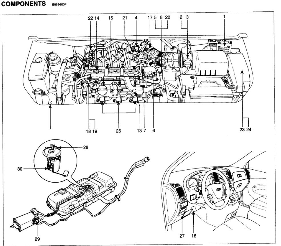

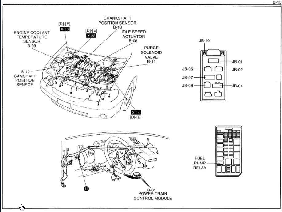

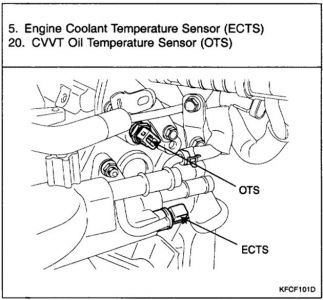

MADKAE333

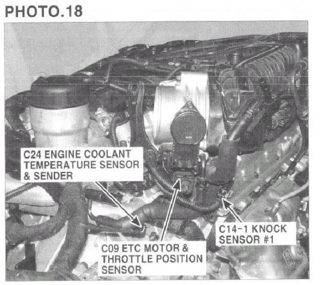

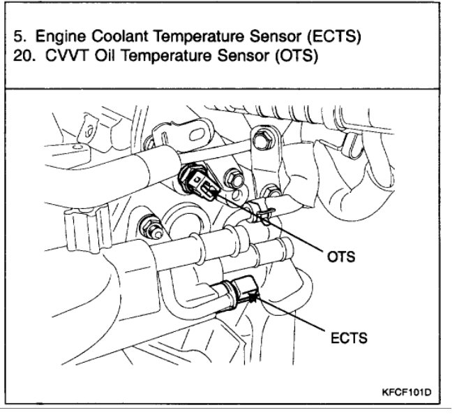

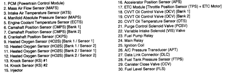

where is the coolant temperature sensor located?
  • 55,433 POSTS
The coolant sensor is on the block down low on one diagram and then up toward the top on another. Here is guide that will show you what you are in for when doing the job.
https://www.2carpros.com/articles/coolant-temperature-sensor-cts-replacement
Here are both sets of locations so you can find it (below) Please let us know if you need anything else to get the problem fixed.

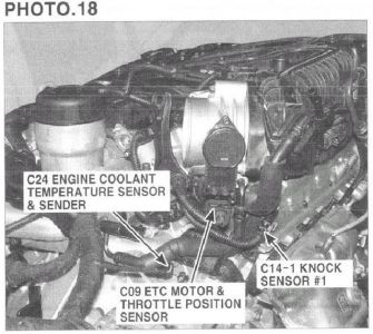

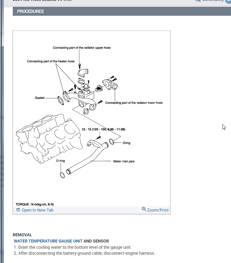

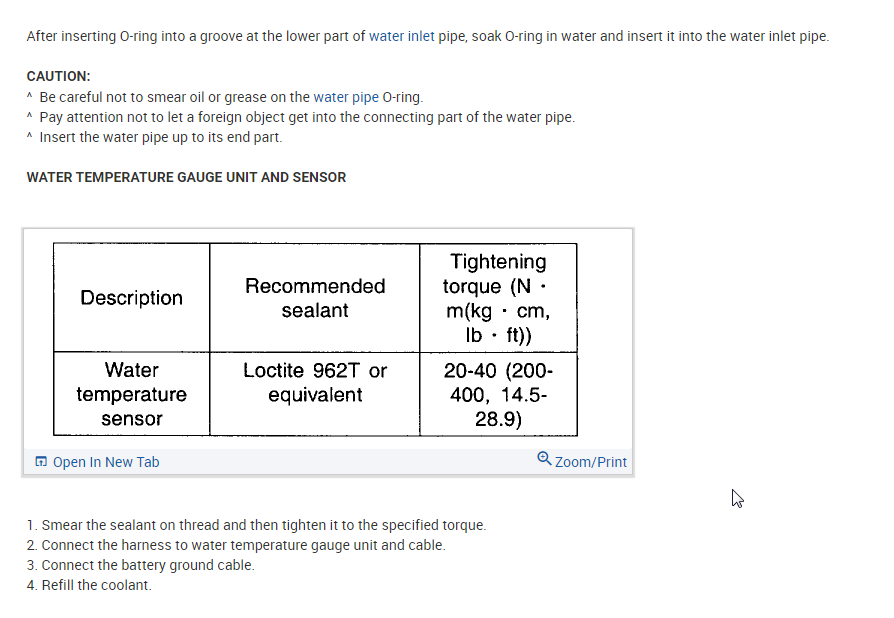

WMHUPP
I need to replace this part. I can't find it's location. Please help.

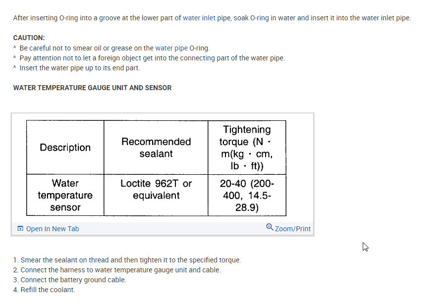

I am attaching the process on how to replace this from the manual below. Please take a look at this and it shows the location on where it is on the passenger side of the engine.
Please let us know what other info that you need. Thanks

SIGNALRANGER

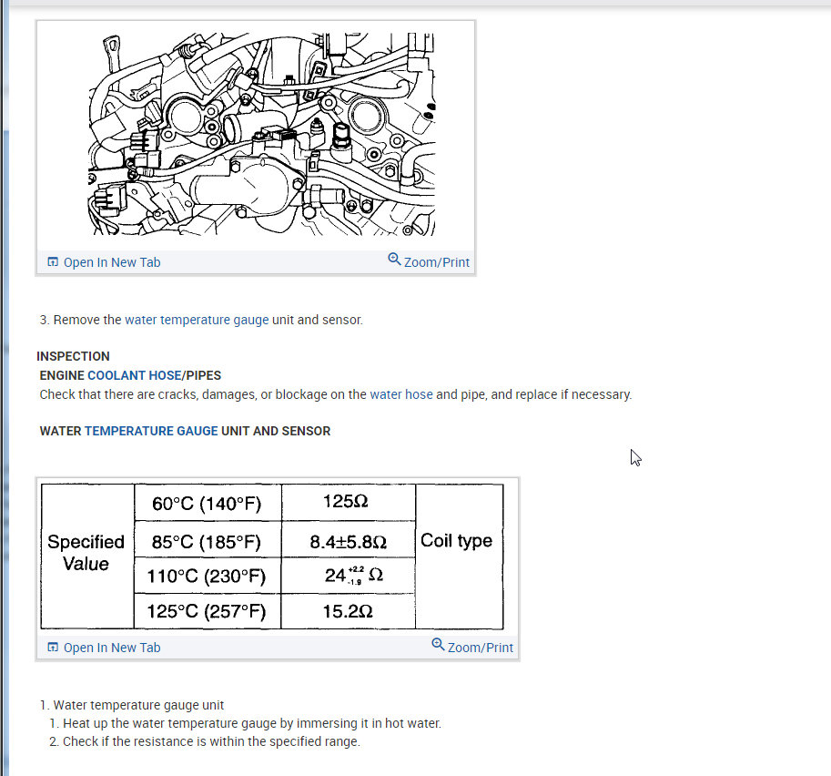

I thought I found the sensor. It was almost identical to the replacenment, but it smelled like gas. I reinstalled it. I have been all over the thermostat housing area and no luck. This shouldn't be this hard, but Kia engines are weird. Can you please tell me the exact location of this pesky sensor.
  • 75,992 POSTS
2006 Kia Truck Sedona V6-3.8L ENGINE COOLANT TEMPERATURE SENSOR
https://images.2carpros.com/forum/automotive_pictures/12900_ects_1.jpg
https://images.2carpros.com/forum/automotive_pictures/12900_ects1_1.jpg
