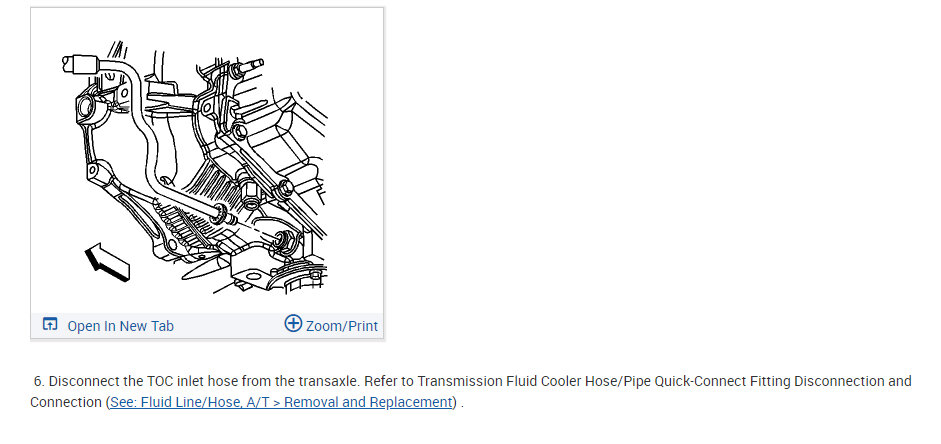

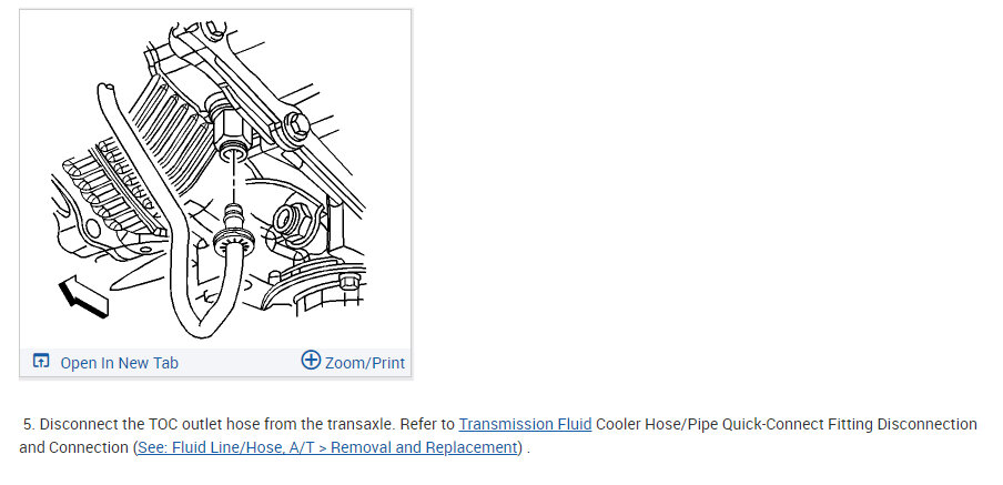

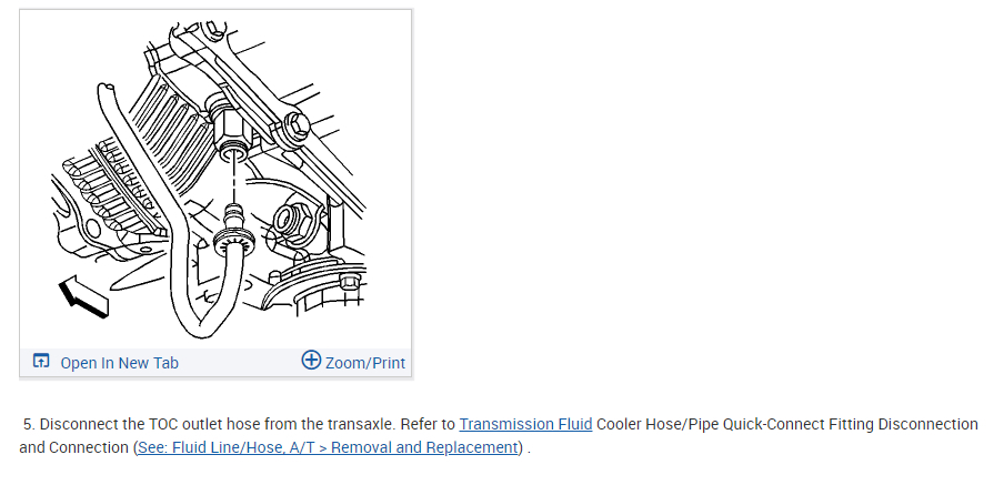

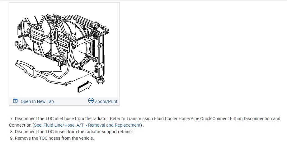

Hello, can y'all help me out on how to replace my transmission cooler lines? It's leaking it just started not super bad, but I can see fluid. Due to age it's about that time. Thanks
Jan 8, 2024 at 10:01 AM
  • 110,194 POSTS

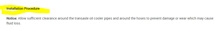

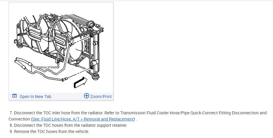

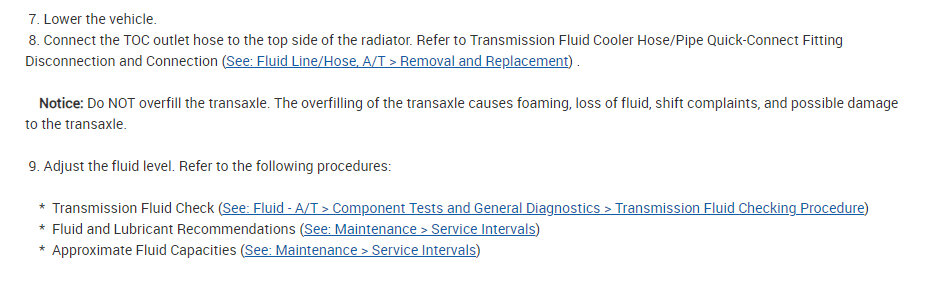

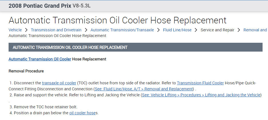

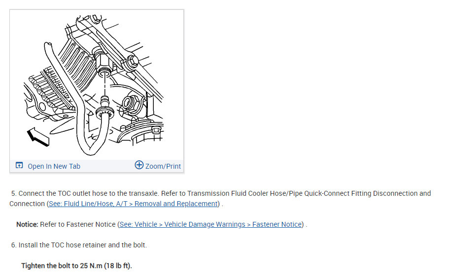

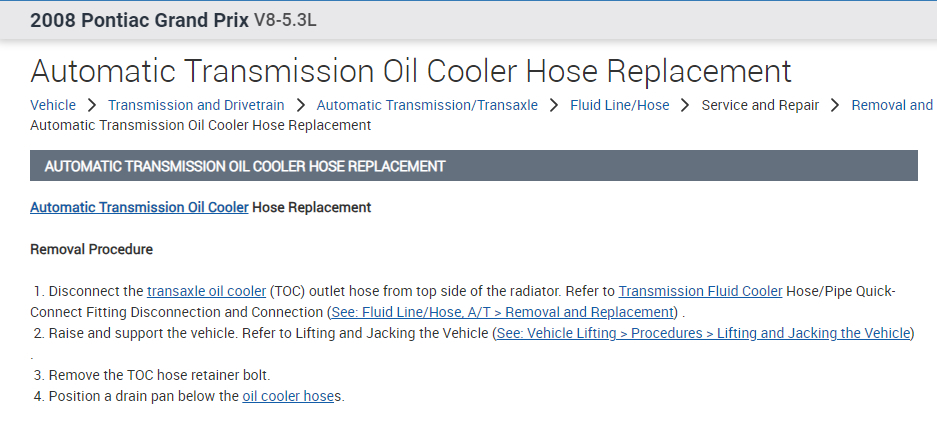

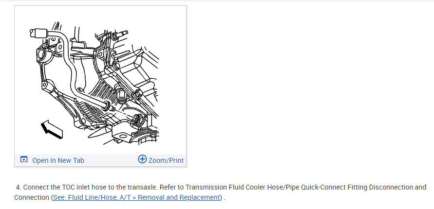

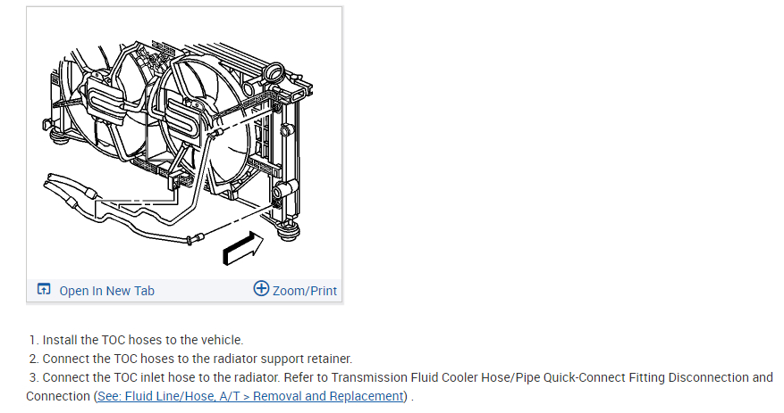

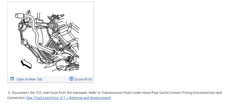

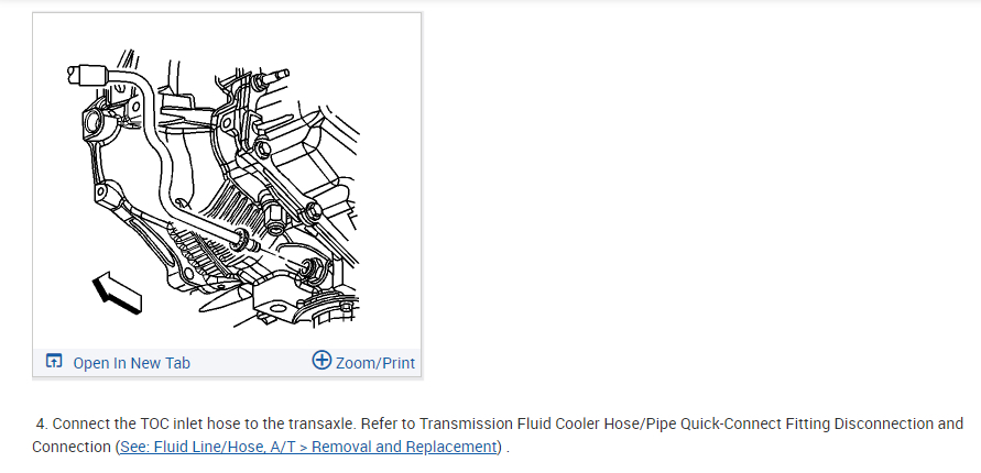

Chances are you will need to lift the vehicle to be able to access and perform the process. Also, there should be quick connectors that can be a little of a pain simply because they are retained with a thin horseshoe-like retainer which is likely to fly off and is nearly impossible to see on the ground. LOL
Regardless, I attached the directions below for the process. Take a look through them and let me know if it helps or if you have questions.

Hello, I want to say thanks a lot and the installation went well, only the clips gave problems putting back in but we got it.
Jan 12, 2024 at 4:09 PM
  • 110,194 POSTS
Thank you for the update and you are very welcome. I'm glad you got it taken care of. By the way, the clips are a pain in the butt. LOL I totally understand.
