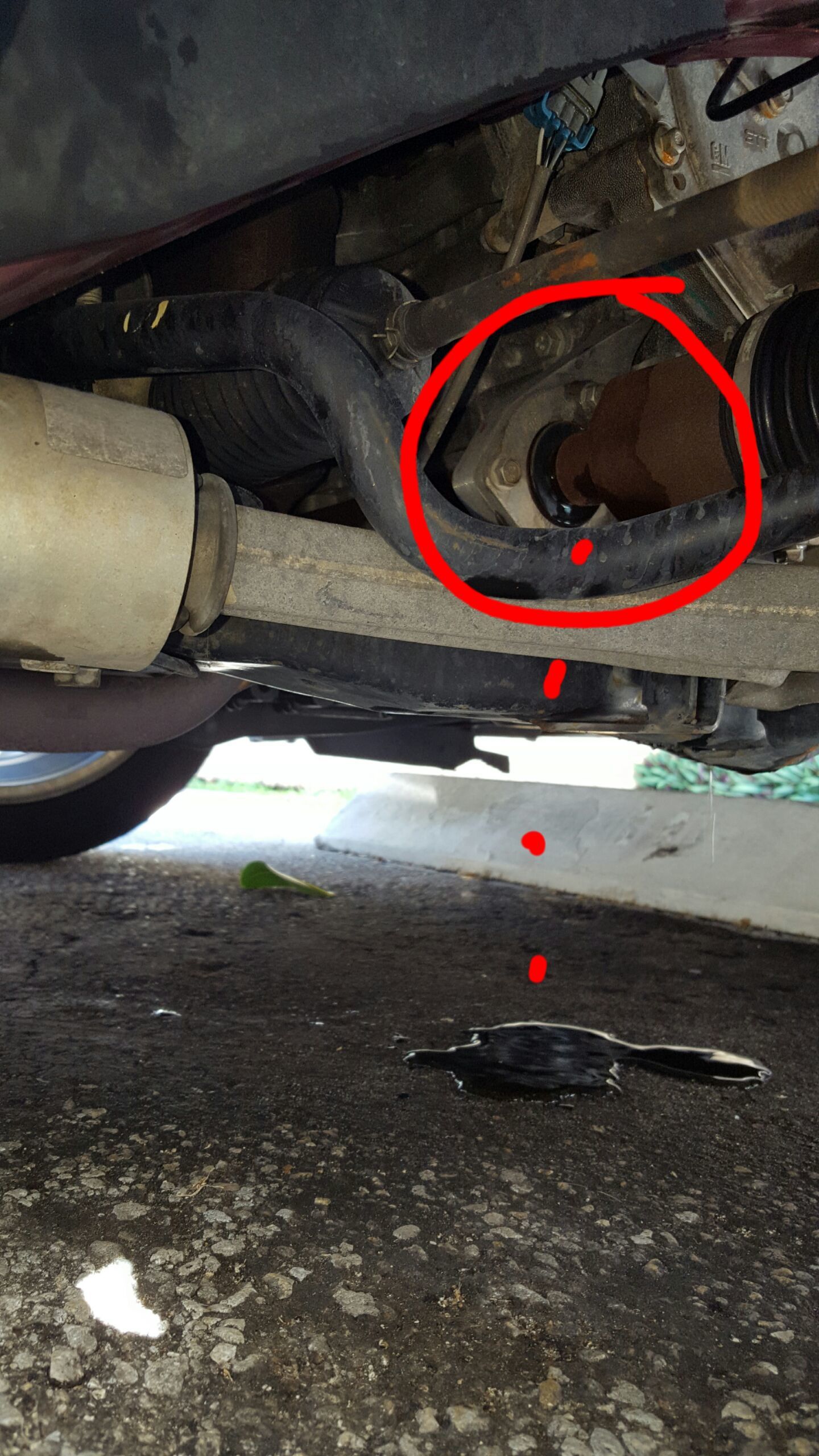

WARDLOW04
  • 2009 CHEVROLET MALIBU
  • 4 CYL
  • 85,000 MILES
I have a rapid leak coming from the bottom of the car (picture attached). I had to keep putting water in the reservoir in order to make it home before the car overheated too bad. It looks like the leak is coming from two places but mainly the one outlined in red in the picture. It alao seems that the leak is occurring before reaching the radiator. Also, we have checked to see if the reservoir was cracked at the bottom but it wasnt. Any ideas?

HMAC300
  • 48,601 POSTS
It looks like it could be a heater hose from above open the hood and take a look here is a guide that will help us find the problem as well.
https://www.2carpros.com/articles/car-is-leaking-coolant

BOOPERIII
They replaced the intake gasket, cost $560.00 all set.
