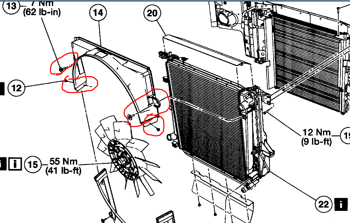

How do i get the fan shroud off to get to the radiator cap to install stop leak?
Dec 21, 2019 at 8:20 AM
  • 110,248 POSTS
I attached a picture below showing how the upper portion of the fan shroud is held on. There are two screws that attach it to the radiator and the two lower screws fasten the upper and lower shrouds together.
I have to be honest, there is no radiator cap under the shroud. All coolant is added through the reservoir. Can you explain what is happening? I may be able to give some suggestions.

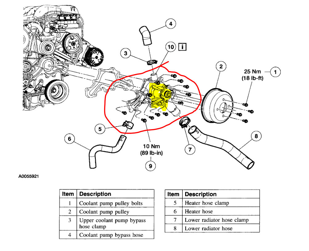

If it is coming from behind the fan pulley, it's the water pump. I recommend not putting anymore sealer into it. Also, I recommend flushing the radiator and engine block before reinstalling a new pump.
First, take a look through this link. The second picture shows the weep hole I am referring to. I am 99.9% sure that is where the leak is. Note that it is behind the pulley. Also, a sealant won't fix that problem. It is caused by a seal issue or the bearing is going bad.

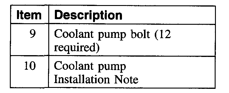

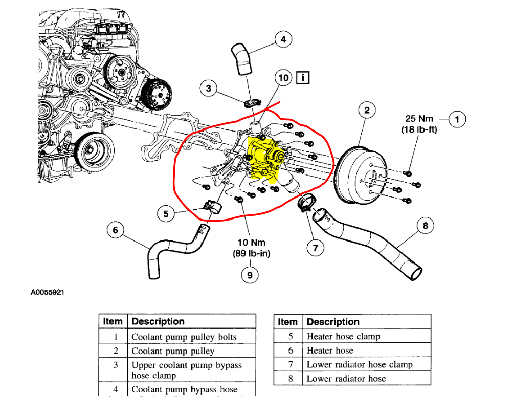

If you look at pic 1, i attached an exploded view of the water pump on your vehicle. I circled the pump and highlighted where I believe the leak is coming from.
Next:

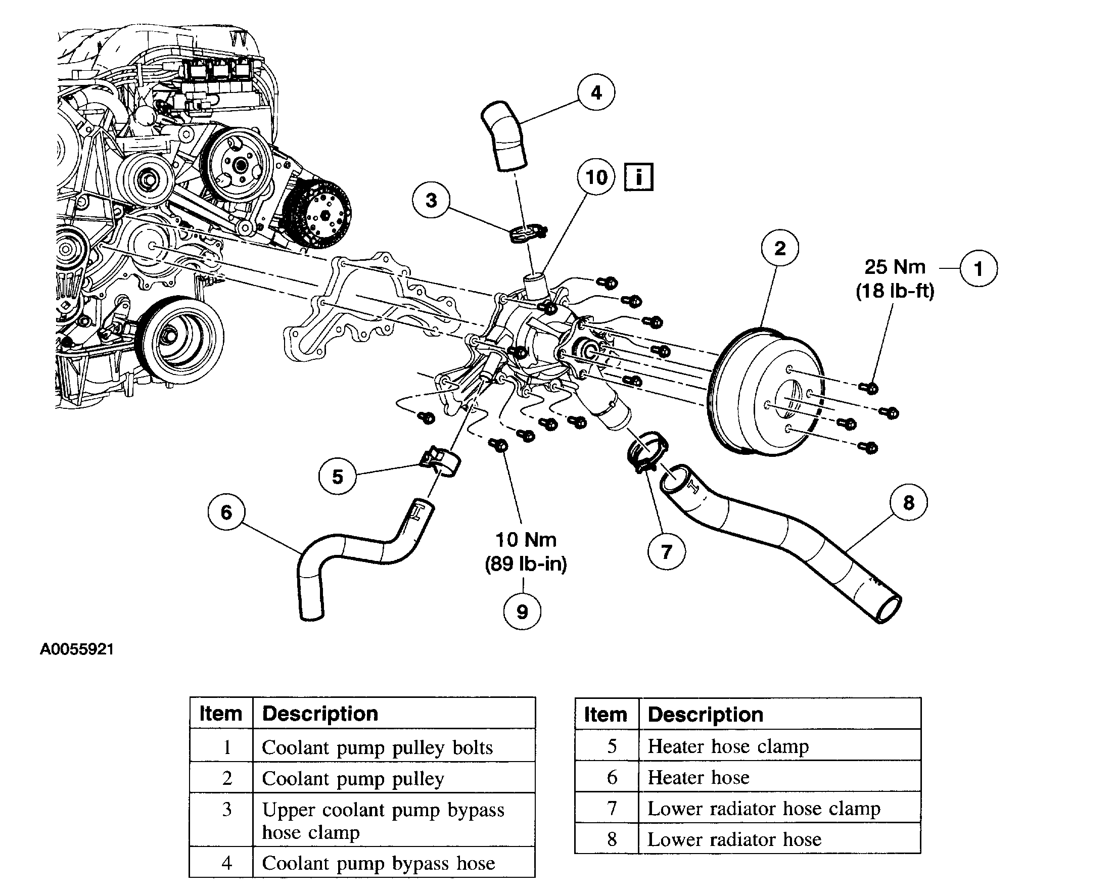

Here are directions specific to your vehicle. Pics 2 and 3 correlate with the directions.
Community 12 Create Quote
2003 Ford Truck Explorer 2WD V6-4.0L VIN E
Procedures
Vehicle Engine, Cooling and Exhaust Engine Water Pump Service and Repair Procedures
PROCEDURES
Water Pump - 4.0L SOHC
Removal and Installation
1. Drain the engine cooling system.
2. Remove the cooling fan.
3. Remove the accessory drive belt.
4. Remove the components in the order indicated.
Part 1 Of 2
pic 2
Part 2 Of 2
pic 3
5. To install, reverse the removal procedure.
6. Fill and bleed the cooling system.
Item 10: Coolant Pump Installation Note
1. Use metal surface cleaner and a suitable plastic or wooden scraper to clean the sealing surfaces.
2. Install a new coolant pump gasket.
