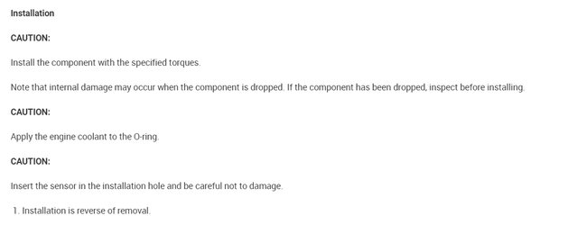

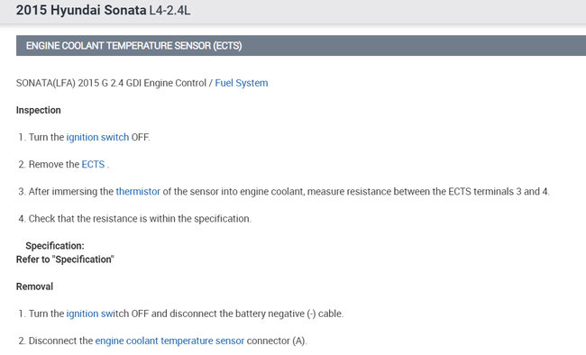

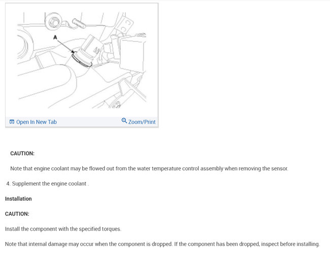

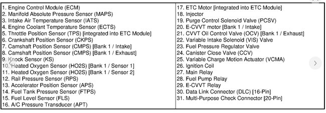

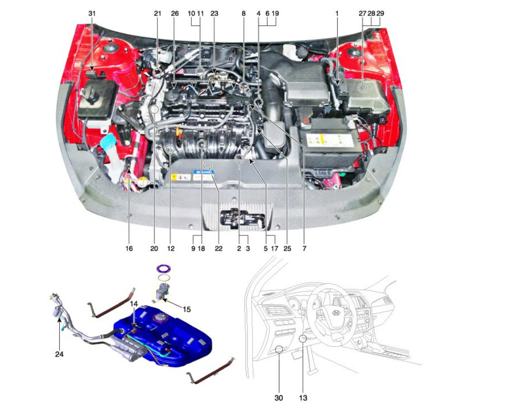

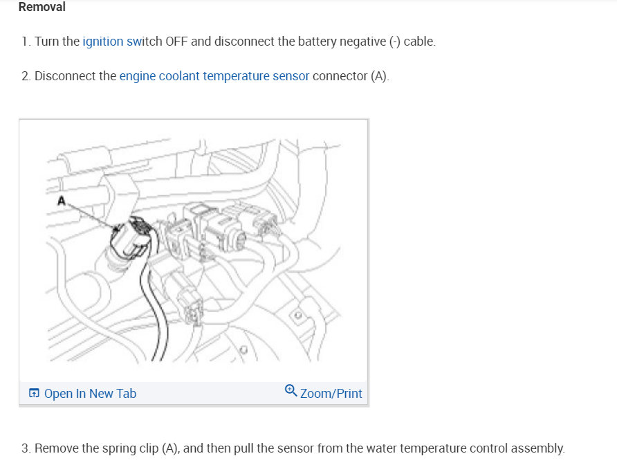

Since the engine is heating up quickly, I would say the engine coolant temperature sensor needs to be replaced. Start by draining the coolant, here is a guide to help you through the steps and the instructions and location of the sensor and the images below.
https://www.2carpros.com/articles/coolant-temperature-sensor-cts-replacement
Check out the images (below). Please let us know what happens. Clear the codes once the job is complete.
