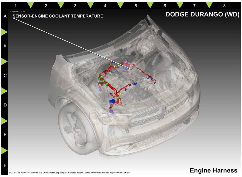

Where is the Coolant Temperature Sensor located for replacement?
135,000 MILES • 3.6L • V6 • 2WD • AUTOMATIC
CRYSTAL HEARN
I am trying to locate the coolant temperature sensor on my vehicle and I can't locate it.
Nov 19, 2023 at 6:17 AM
CARADIODOC
  • 34,414 POSTS
Here's a drawing that shows where it is. Be aware temperature sensors have a very low failure rate because there's just one component inside them. Problems in this circuit are much more likely to be caused by wiring and connector terminal problems.
