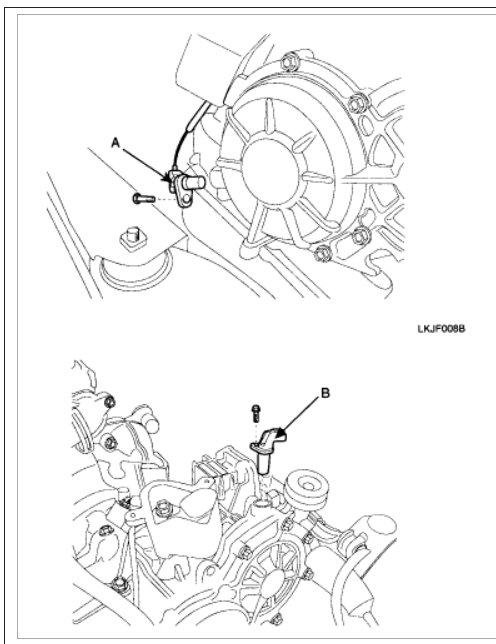

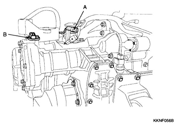

Yes this sounds like you have a input shaft speed sensor go out which can cause the problem you have described.
Here is a video of the job being done:
https://youtu.be/f3bETtCIdxM
Here is the location for your car. Check out the diagrams (below).

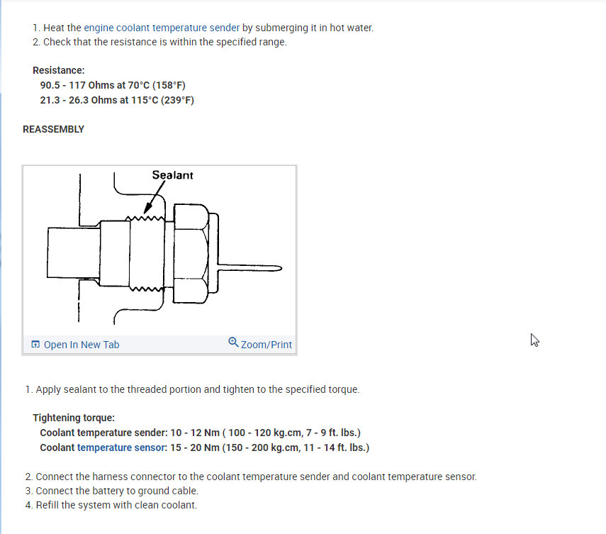

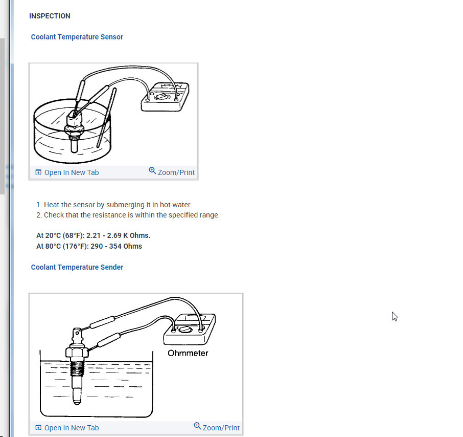

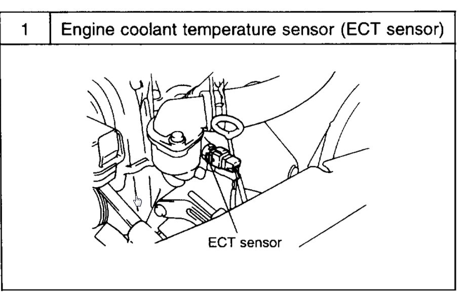

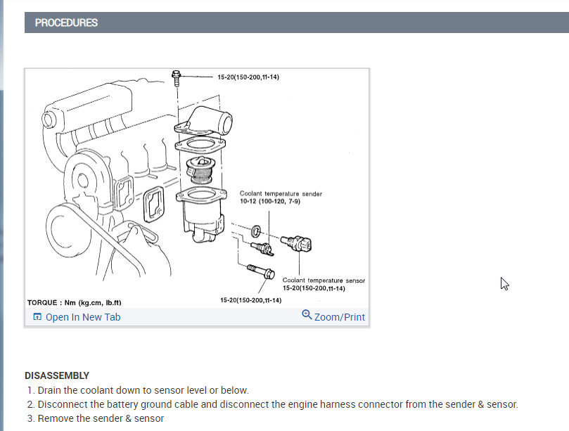

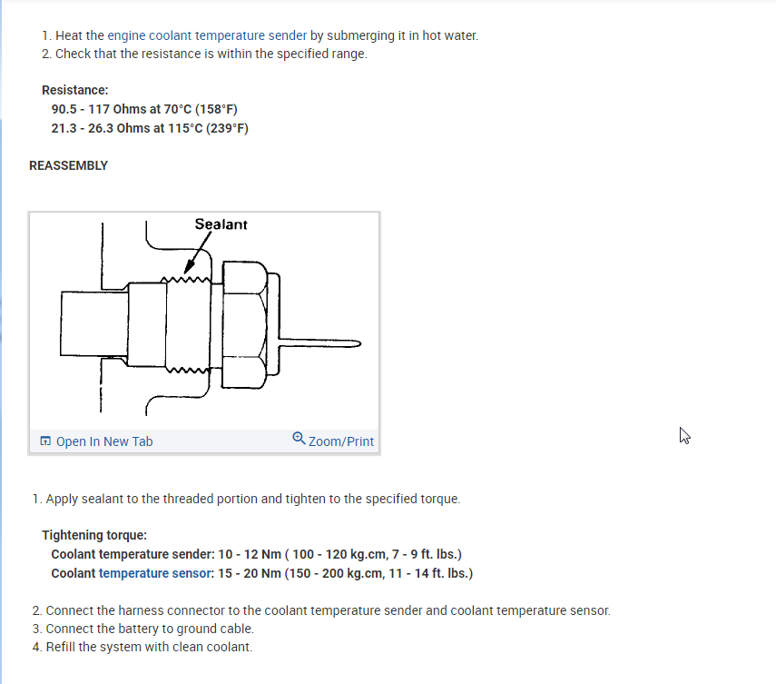

Where is the temperature sensor located on the engine ??????
Feb 10, 2021 at 1:28 AM (Merged)
It is very close to the thermostat which will be in the housing at the end of the large coolant hose.
I attached the info below of where it is and how to replace it.
Let us know if you have questions. Thanks
