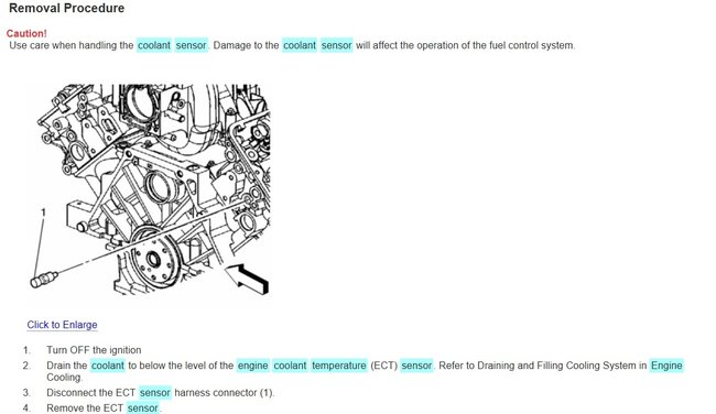

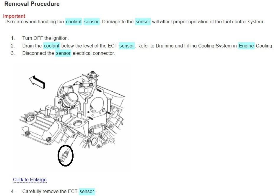

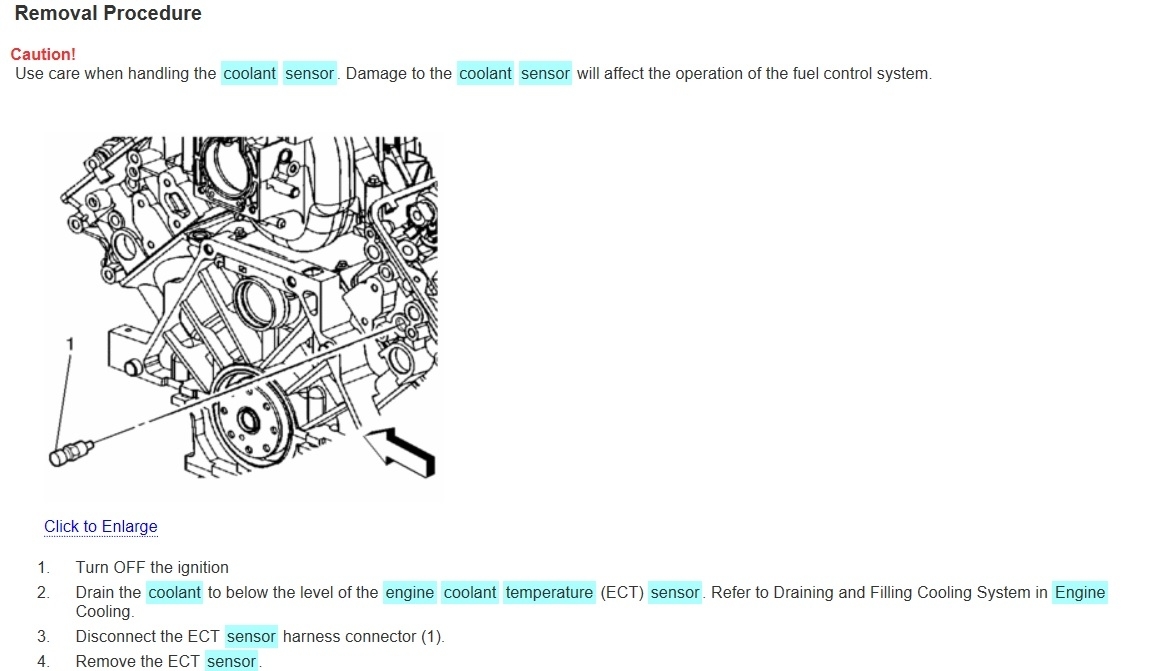

i have the GXP model. i need to know where the coolant temperature sensor is located, and the best way to remove and replace it. thank you
Sep 4, 2017 at 12:34 AM
JDL
Experienced Mechanic
16,098 POSTS
Hope the picture orientation is good enough? Two wire connector, wire colors, orange and yellow. You need proper size socket.

Sorry, the first post was wrong engine size. Two wire connector, orange and black, wire colors.
