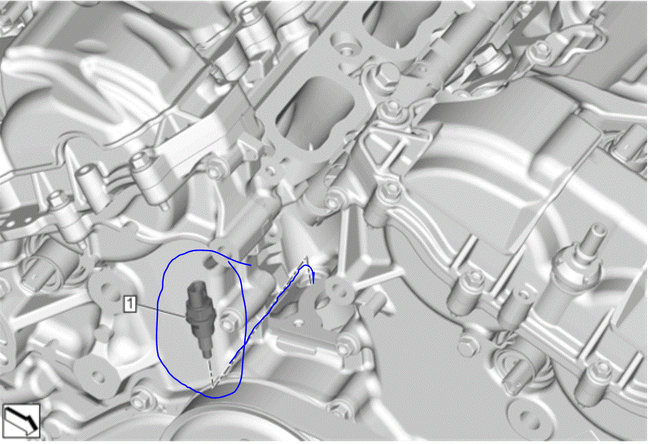

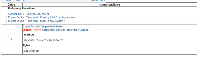

It would appear that the coolant temperature sensor is in a different location for 2017 - 2020 GMC Acadia V6s than it was prior to 2017. Can you offer information as to its location?
Dec 14, 2020 at 5:28 AM
  • 110,240 POSTS
I have attached a pic below showing the location. I highlighted it for you. The directions require the removal of the coolant thermostat housing and inlet removal.

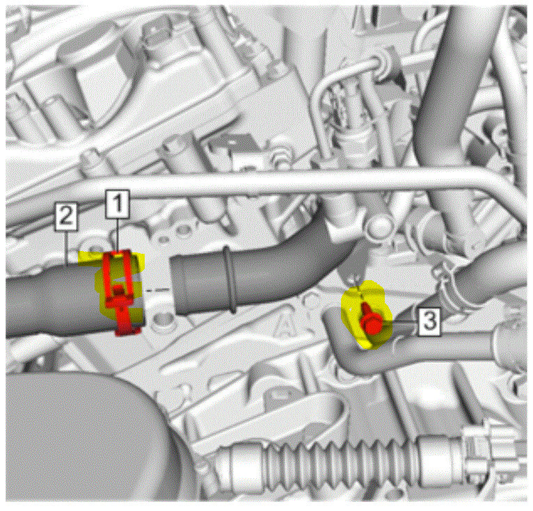

Pics 1 and 2 show location and directions.

It is partially under the intake manifold. See pic 1.
According to the manual, here is what needs to be done.
______________________________________

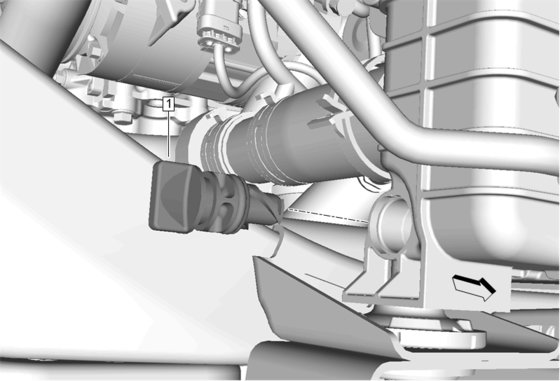

1) Drain the cooling system.
The drain is on the bottom of the radiator. See pic 2

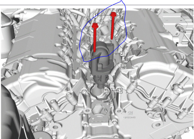

2) Remove the thermostat housing inlet pipe
See pic 3

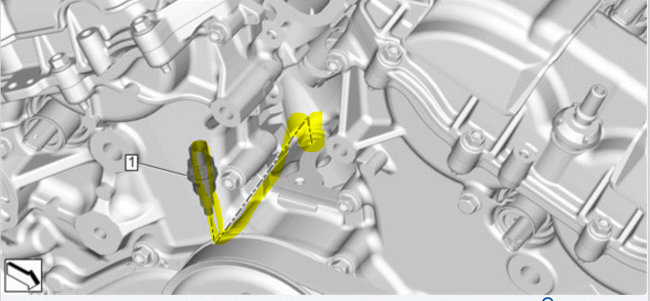

3) Remove the thermostat housing.
It is held on by two bolts. See pic 4
Reverse the procedure for installation.
Note: Make sure to replace gaskets and or o rings.

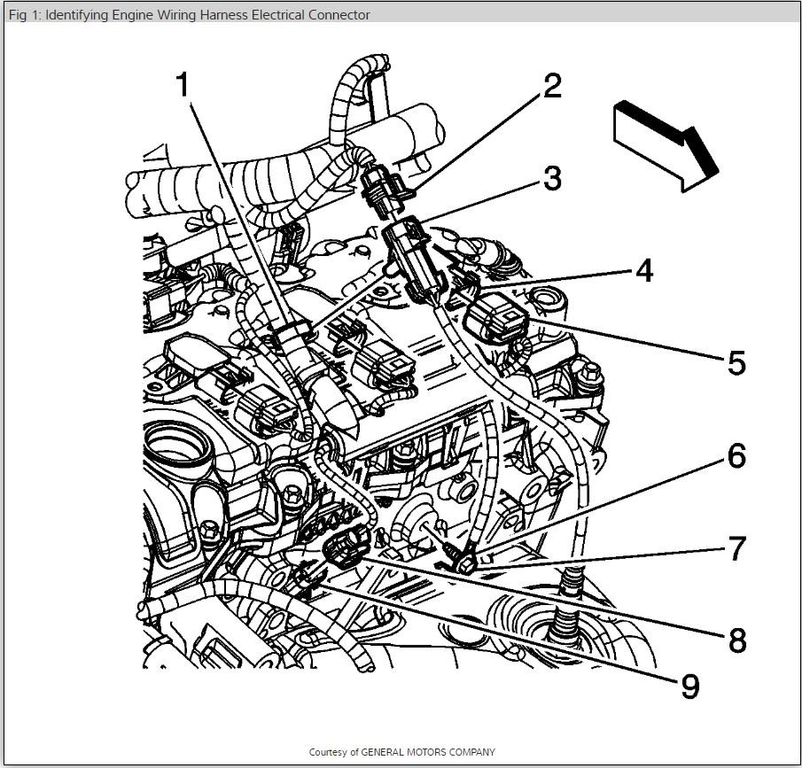

What is the location of the ECT sensor?
Feb 4, 2021 at 1:47 AM (Merged)
PATENTED_REPAIR_PRO
  • 1,853 POSTS
Ther engine coolant temperature sensor shown here at #9. Check out the diagrams (Below). Please let us know if you need anything else to get the problem fixed.......................
