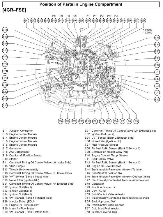

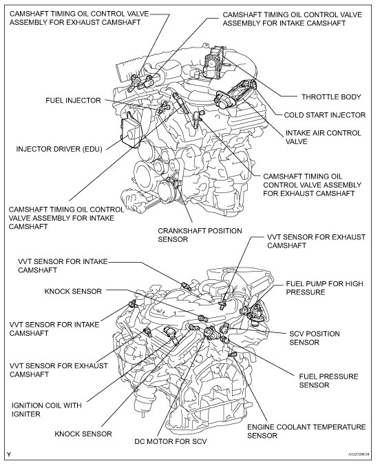

Where is the coolant temperature sensor location?
Dec 3, 2017 at 4:34 PM
HARRY P
Experienced Mechanic
2,292 POSTS
Here are a couple of diagrams I found. They are not the best diagrams ever, but if you look at them long enough they start to make some sense. Let us know if you need anything else.
