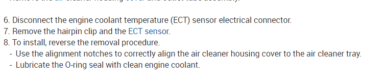

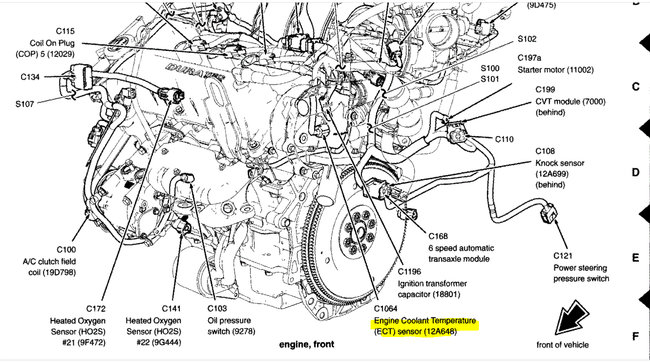

Don't seem to fine the location of the coolant temperature sensor on my car listed above . Any help truly appreciated.
Jun 10, 2021 at 1:36 PM
  • 110,240 POSTS

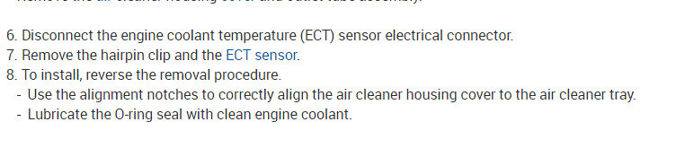

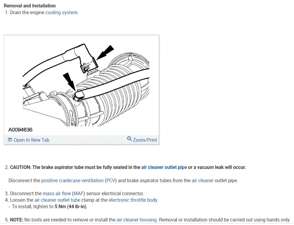

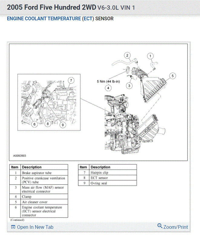

The sensor is on the rear of the engine. If you look at pic 4, it shows a general location. This isn't too hard to do, but it will require that you drain the engine coolant.
Here is a link to get you started. It explains in general how it's done.
https://www.2carpros.com/articles/coolant-temperature-sensor-cts-replacement
If you look at pics 1, 2, and 3 below, they provide the directions specific to your vehicle.
