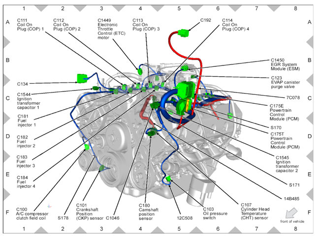

Where is the sensor located?
Nov 17, 2018 at 8:56 AM
  • 55,721 POSTS

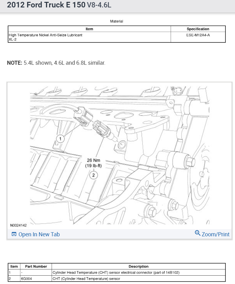

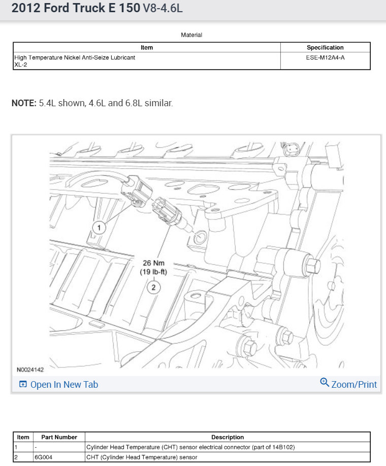

The engine coolant temperature sensor is in the front of the left cylinder head. Here is a guide that will walk you through the steps and diagrams and instructions below to show you how on your van:
https://www.2carpros.com/articles/coolant-temperature-sensor-cts-replacement
Check out the diagrams (below). Please let us know if you need anything else to get the problem fixed. Cheers, Ken

That code is missing part, can you recheck it please? should be like a p0128? Since that is a cylinder head temperature sensor it will not have coolant.
