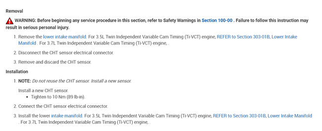

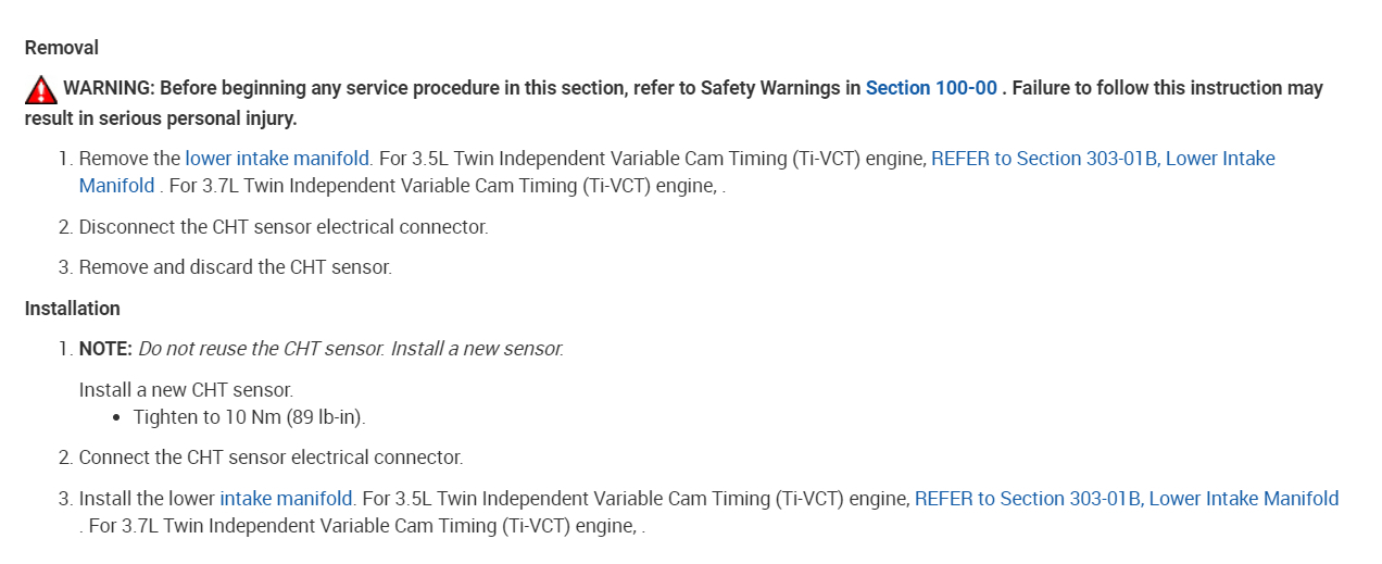

Where is the coolant temperature sensor located?
2015 FORD EXPLORER
10,000 MILES • 3.5L • 6 CYL • TURBO • 4WD • AUTOMATIC
PEANUT4YUH.

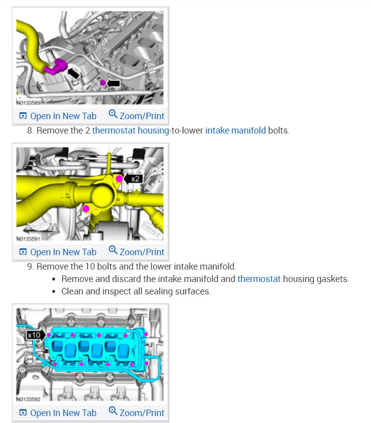

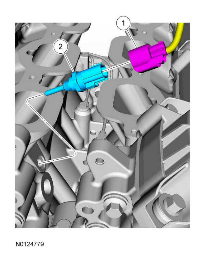

I would like to know exactly how to locate the coolant temperature sensor on the vehicle listed above doch XLT model. Also the process of removing and replacing.
Aug 22, 2022 at 11:13 AM
  • 55,433 POSTS

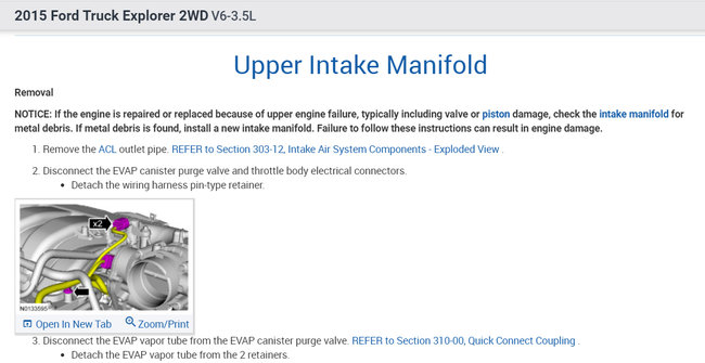

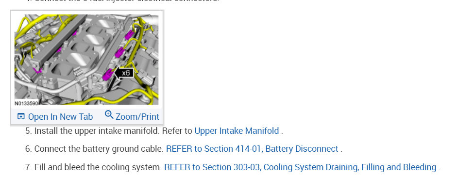

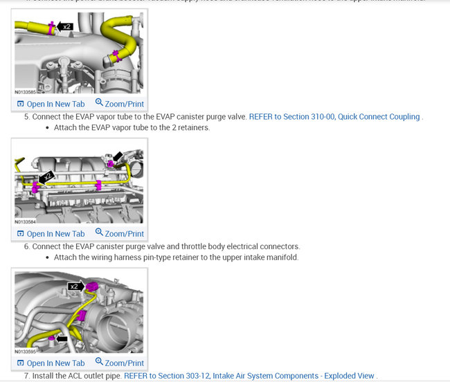

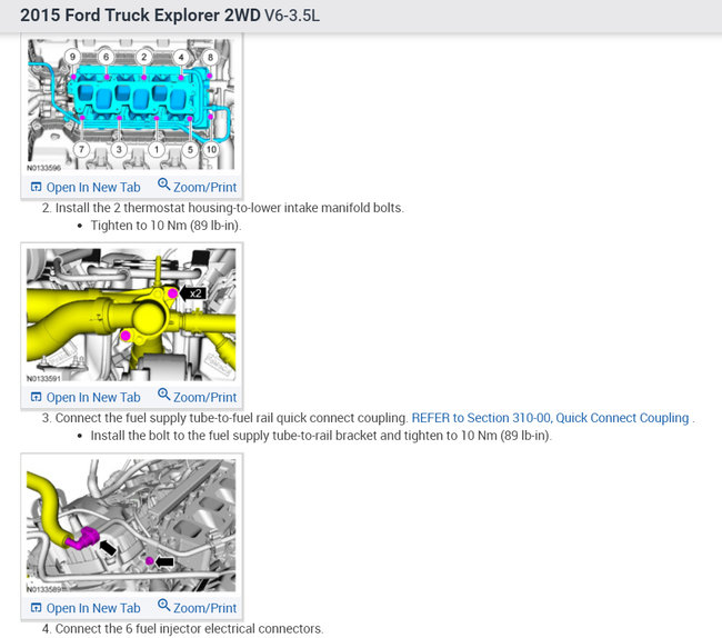

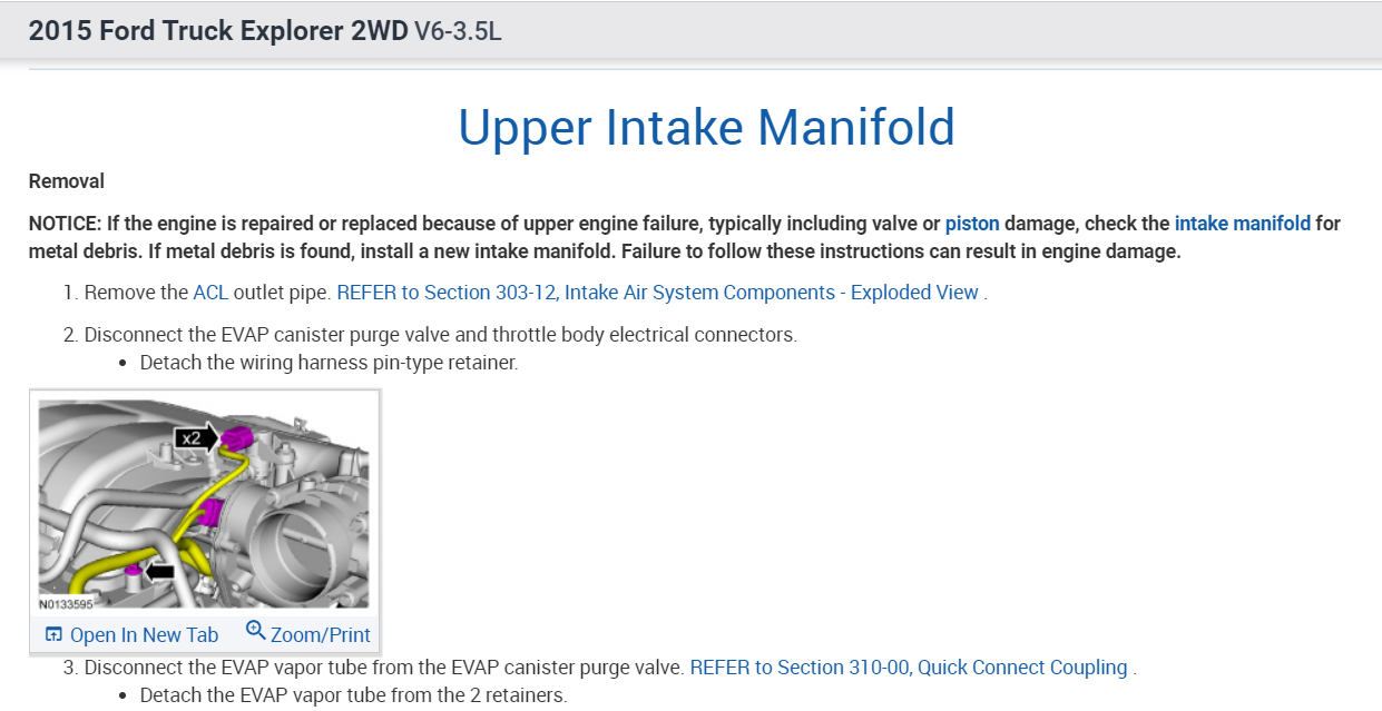

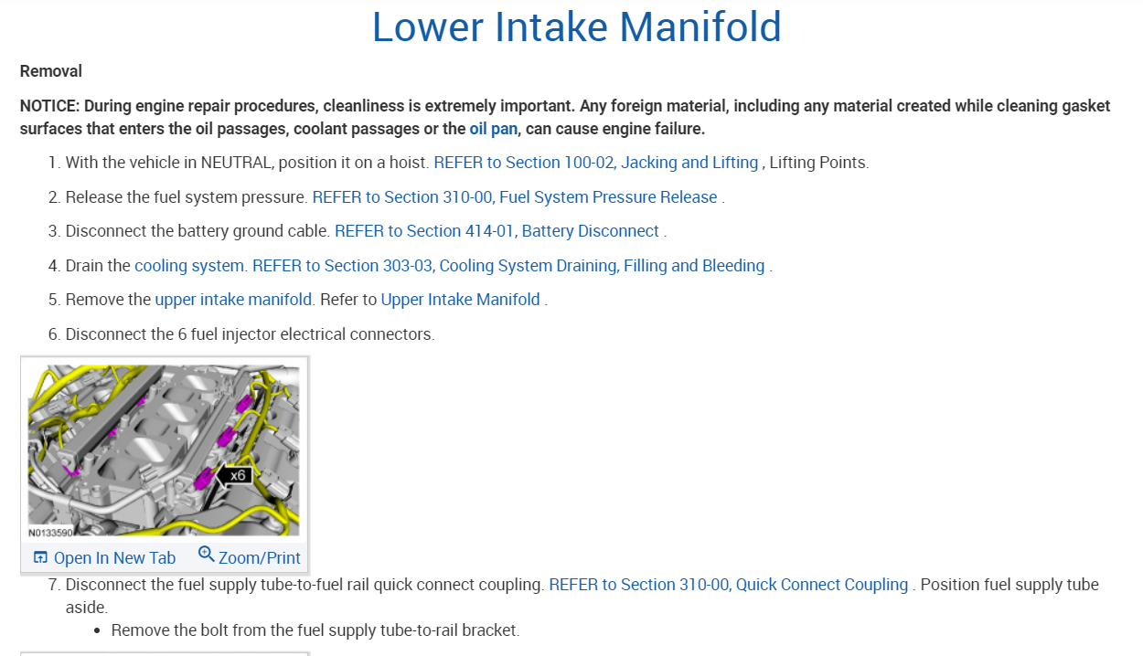

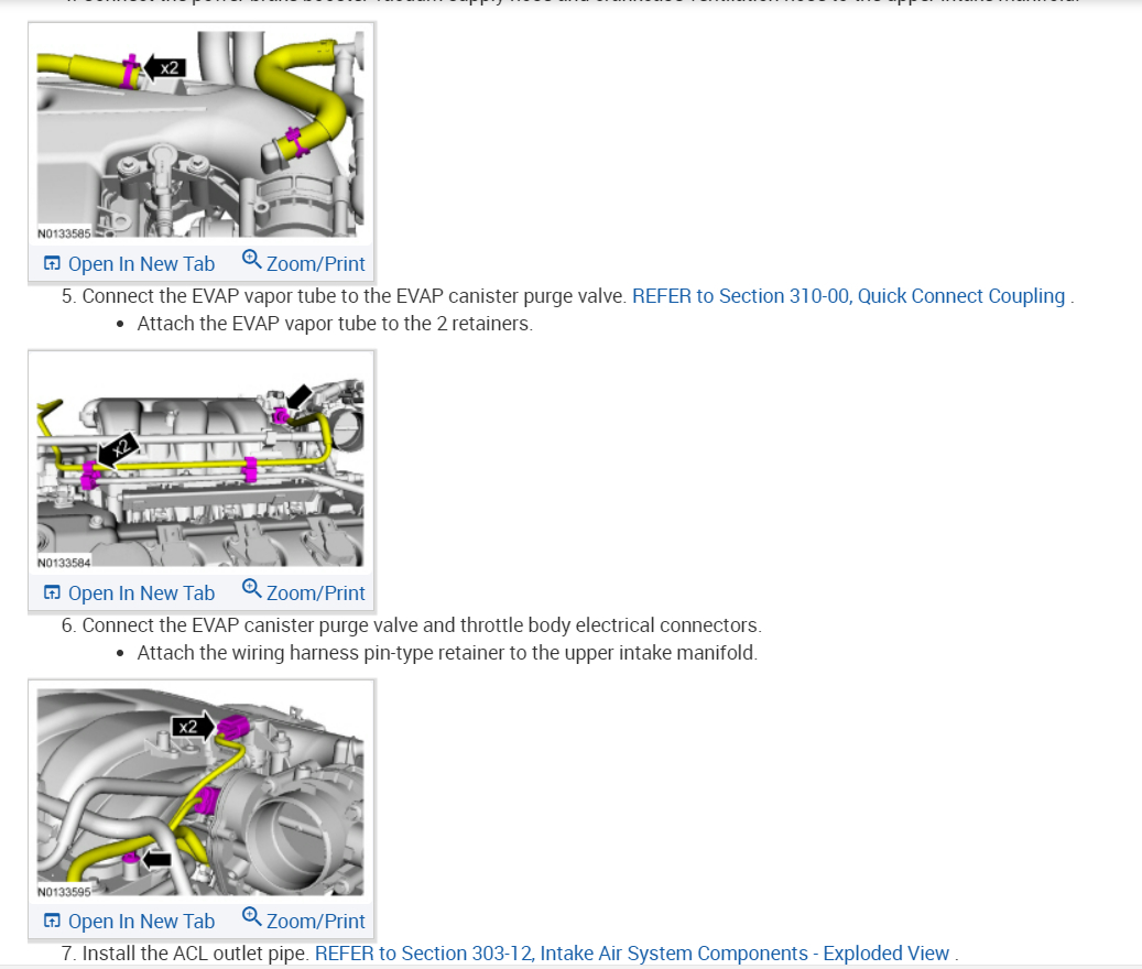

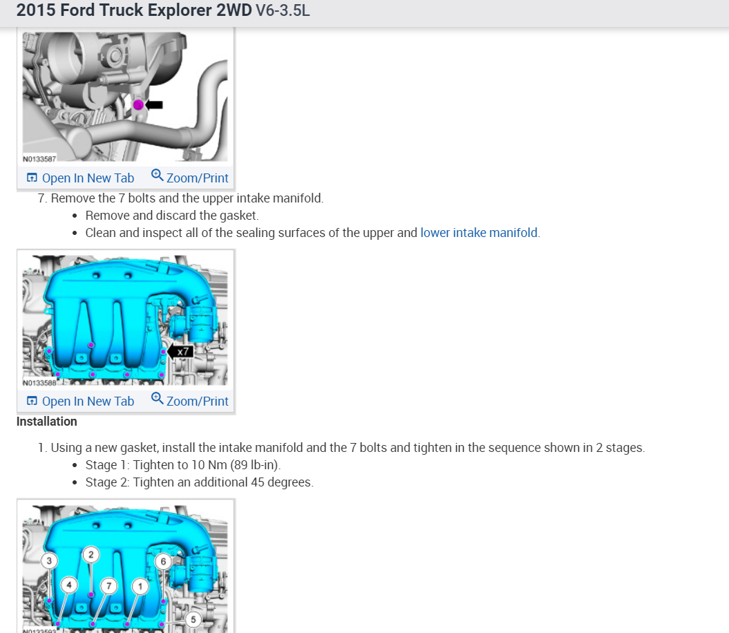

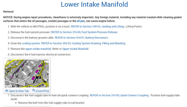

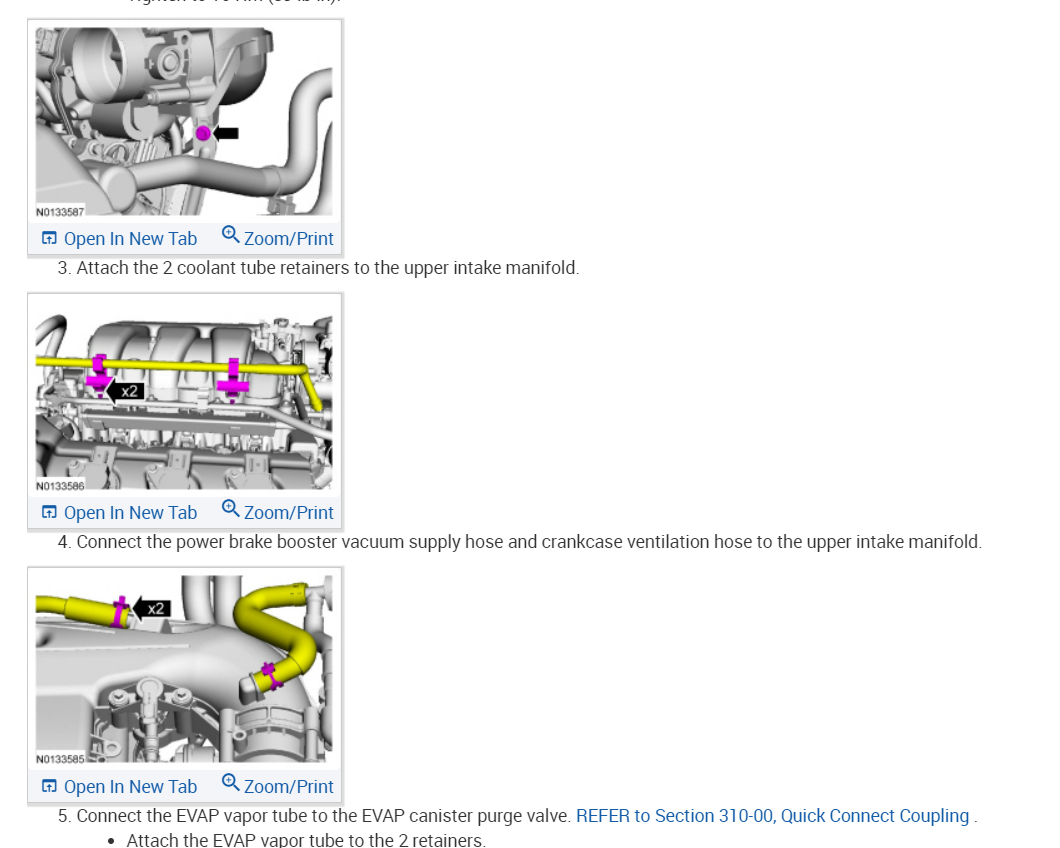

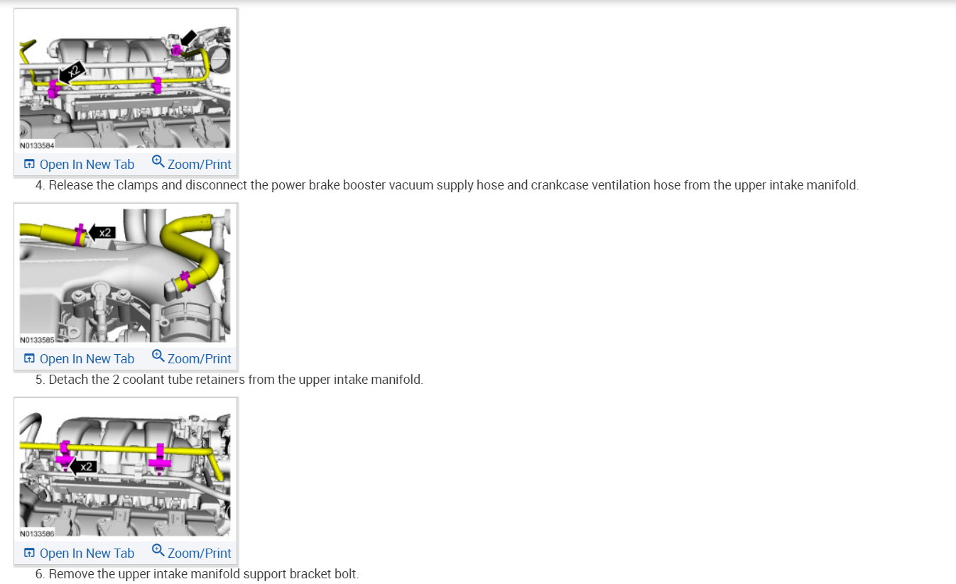

It is below the lower intake manifold. so, the upper and lower intake will need to be removed, start, by disconnecting the battery and draining the engine coolant. Also, once the intake is off because it does not allow any dirt or debris to enter the intake runners. Here is how to do the job and the location of the engine coolant sensor in the images below.
