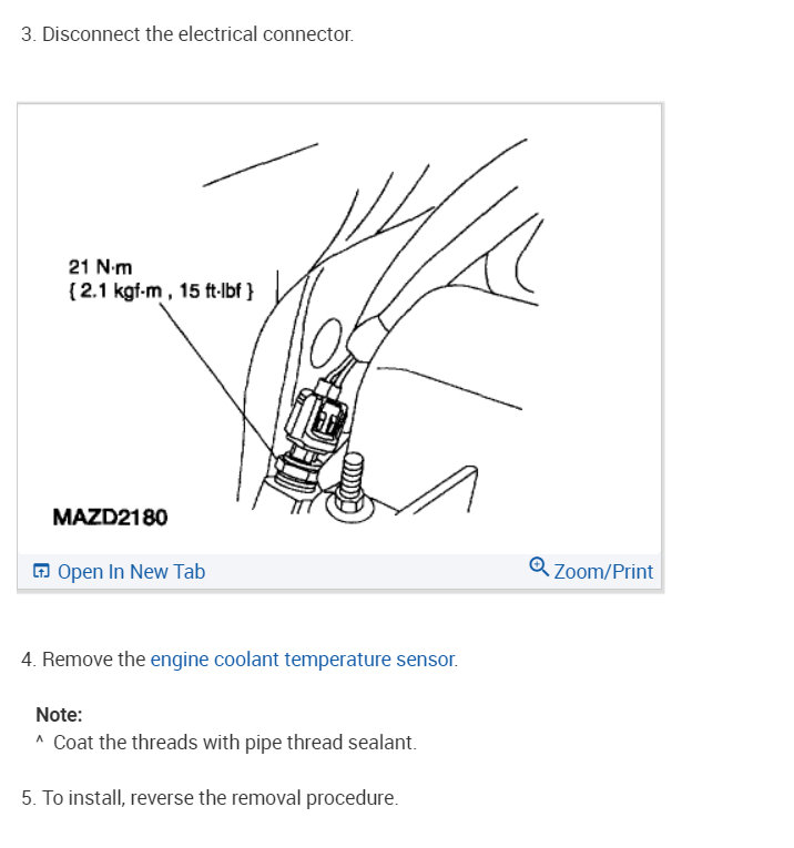

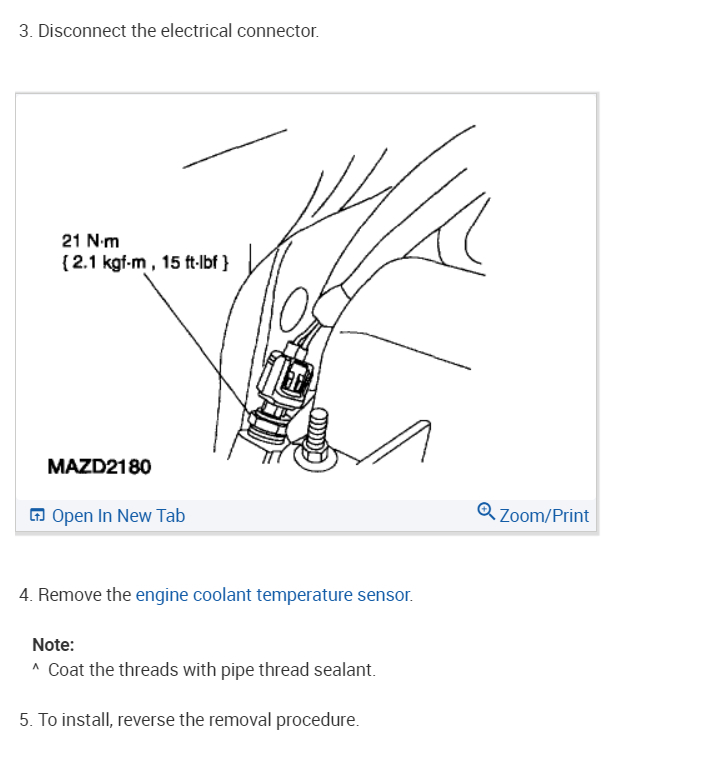

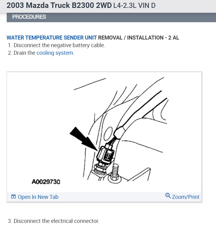

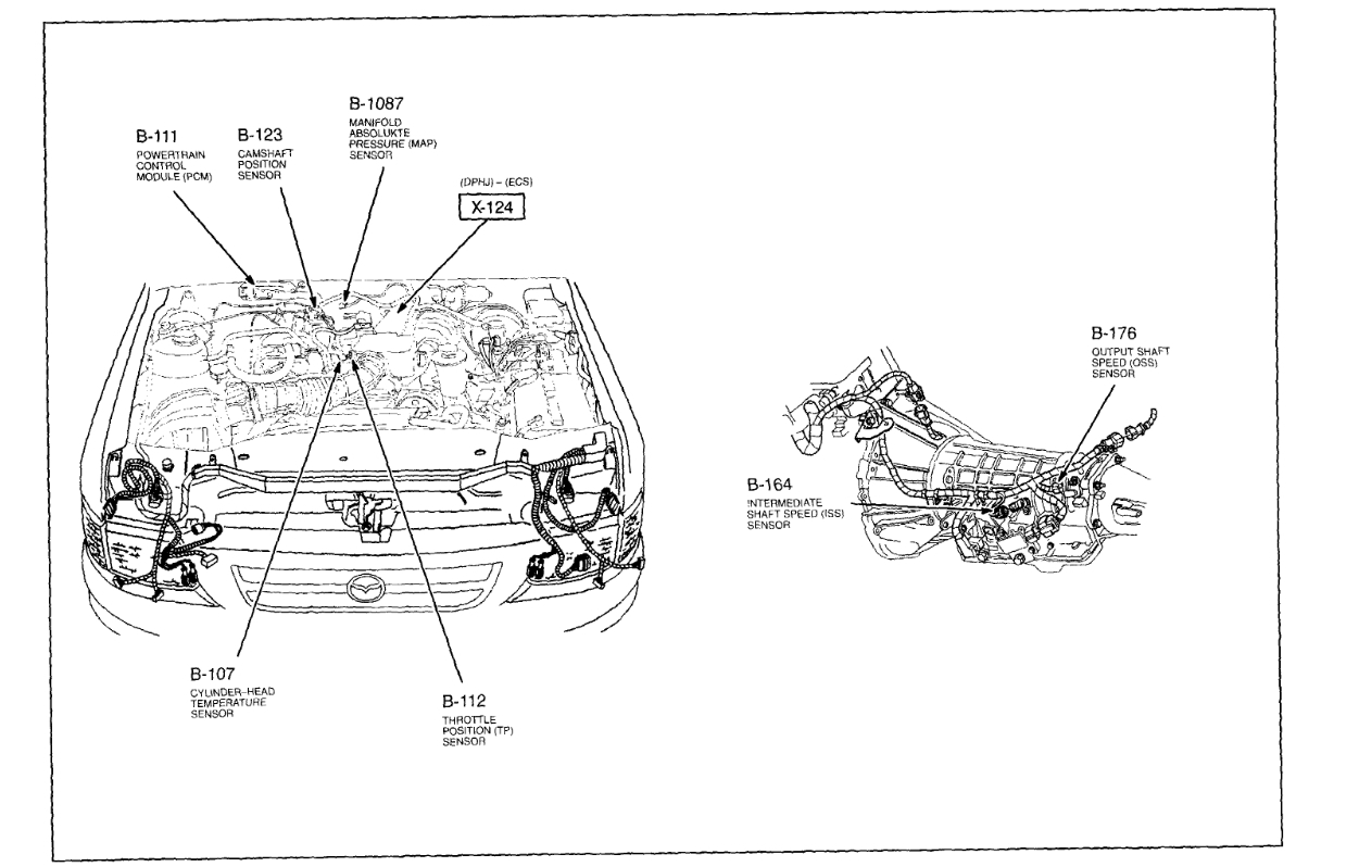

Coolant temperature sensor location needed.
May 18, 2022 at 1:38 AM
  • 55,433 POSTS
It looks like it is at the rear of the cylinder head, I have included the location with instructions in the diagrams below. Plus, here is a generic guide to help you step by step:
https://www.2carpros.com/articles/coolant-temperature-sensor-cts-replacement
