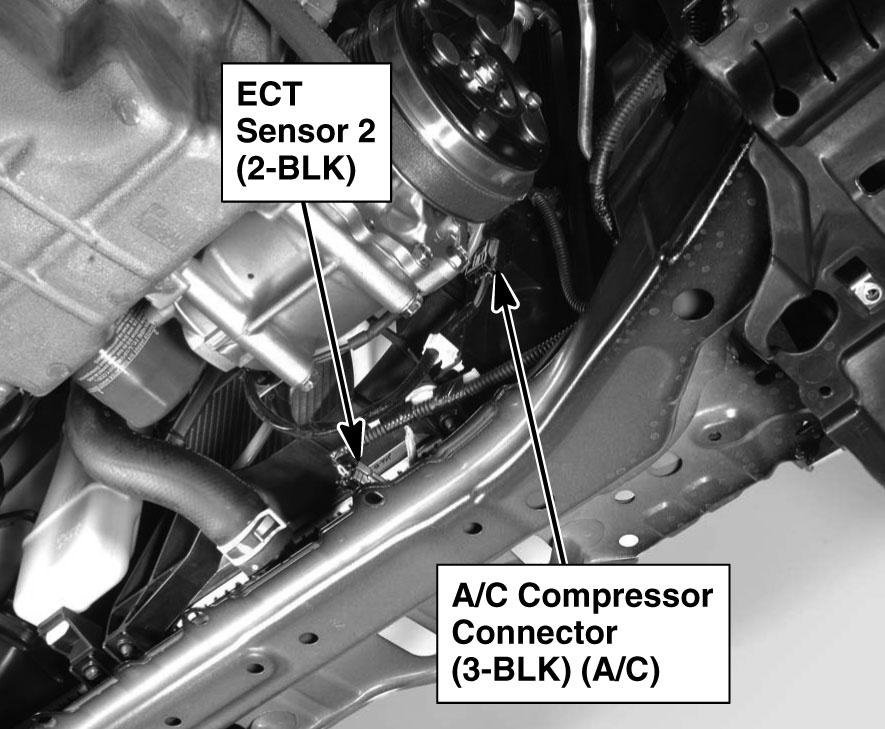

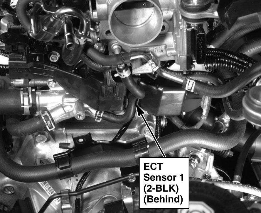

I cannot locate the coolant temperature sensor on my car listed above it is the Sport model. Any diagrams and a verbal description would be very helpful. Thanks!
Sep 11, 2017 at 3:41 AM
CJ MEDEVAC
  • 11,004 POSTS
Two diagrams below.

Thank you! This is exactly what I needed.
