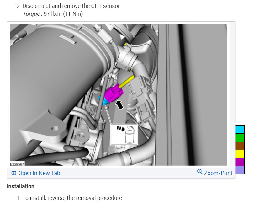

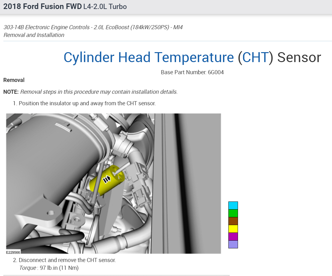

We are looking for the Coolant Temperature Sensor for our vehicle listed above Se. We cannot find any videos of it, nor diagrams of it, not even in the Haynes Manual. Can you please help us locate where this sensor is? We can change it ourselves if we can find it! Thanks!

So, they don't call it an engine coolant temperature sensor anymore, they call it a Cylinder Head Temperature, here is the location in the images below. Check out the images (below). Please let us know if you need anything else to get the problem fixed.
